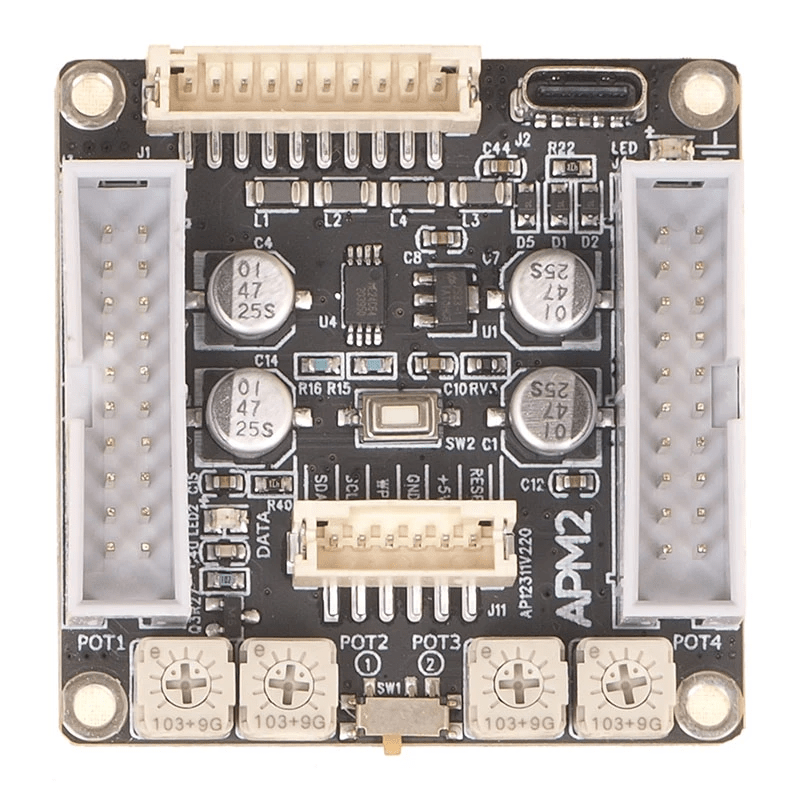

Just got the the WONDOM ADAU1701 APM2 without the extension board so I could basically use it as a pre-amp. But I'm unfortunately unable to find a wiring diagram to connect the APM2 in a 2.1 setup without the extension board, would anybody be able to help?

Here's a LINK to the Sure document that should answer your questions. A couple of things to note if you're using the Sure SigmaStudio project:
1). DACs 2 & 3 both get the summed .1 signal
2. The .1 signal is band passed, not just low passed. As you adjust the pot the high pass filter goes from 20 to 200 Hz while the low pass goes from 100 to 300 Hz. I can't think of any situation where I would want that type of operation.
IMO the supplied project is worthwhile only for playing around to get familiar with SigmaStudio. There are several other problems/limitations too. So any serious application requires learning SigmaStudio and building a new project. I'd recommend the miniDSP 2X4 if you're looking for an easy to learn, ready out of the box solution. YMMV.

To use the SURE ADAU DSP, you have to learn Sigma Studio and buy a connecting device. Even installing this software with drivers and connecting the ADAU to it, is quite "interesting".
If you get that far and know a lot about filters and analog signal stuff, like to solder under a microscope and have a lot of time, you may end up with a very uncomfortable end product that sometimes even may work.
I know of very few products that are so user unfriendly in any aspect, hard and software, despite being sold in such great numbers. Not to speak of the non existing customer service of the "SURE Wondom" staff. Chinese after sales service is as rare as a pink Yeti.
I'm sure most of these SURE “DSP” never get used after purchase.
If you just want to use a working 2.1 set-up, better go for some solution with a “simple”, existing user interface. Dayton Audio has some low priced DAC's with a good softwre and USB connection. Some people even use the “miniDSP”.

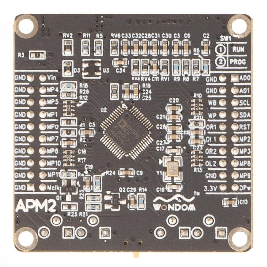

The ADAU1701 can be made a slave, but that forces you to run the DSP core at the external clock rate, and it means you can only have that one master device in the system. The ADAU1452/ADAU1466 is a much better solution for a preamp, because it has 8 ASRC's to accept data at different rates. It's also a much faster chip with more memory, and that can be important for some designs.

The other thing about the Wondom ADAU1701 modules are they very economical. Sure, not super powerful, but surely enough for the scenario I described above and the OP's 'preamp' needs?
The ADAU1701 has plenty of power unless you start using some of the ADI algorithms such as Super Bass or Dynamic Bass. Those algorithms use a lot of program memory, and I ran out of instructions when I used them. But for many applications, the ADAU1701 is plenty powerful. Also, the specs on the CODECs aren't as good as "premium" devices, but the CODECs are fine for many high-quality applications.
The biggest limitation of the ADAU1701 for preamp applications is the lack of a sample rate converter (ASRC). Your scenario has two digital devices (TV and streamer), each transmitting using their own clocks (they are "clock masters"). SPDIF receivers will be needed to recover those clocks. You could use one recovered clock as the master clock for the ADAU1701, but the other source will not be synchronized, and it won't work. You could add a simple ASRC board as referenced in this thread, but the cost starts to creep up. Obviously, you could add an optical switcher on the front end, but switching the master clock to the ADAU1701 while it is running might cause problems.
You are correct in pointing out that the DSP boards on AliExpress are poorly documented, but if you ask, they will send you the SigmaStudio design that is pre-loaded in the board. That design has a lot of information that you can use to figure out how the board is wired.
Also, it is helpful to get a board that has the USBi connector on it. I've done a lot of designs with the ADAU1701 without using the USBi programmer, but it takes a good bit of work to develop the microcontroller code to use the ADAU1701 without the USBi programmer. I finally broke down and bought a USBi board for the ADAU1466, because it is too hard to program the EEPROM for that chip without it. But even for the ADAU1701, it is a worthwhile investment.
