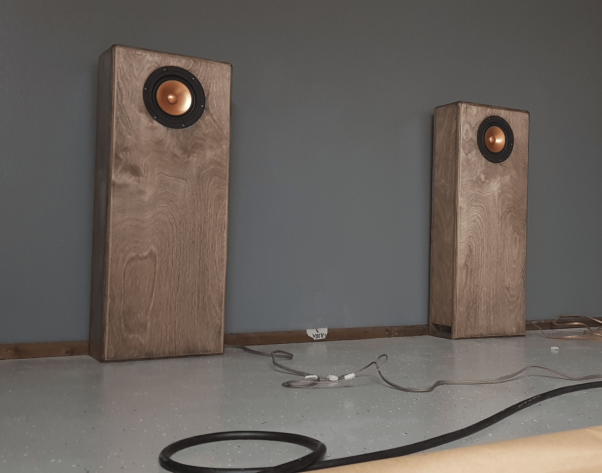

Heres pic when they were finished at garage wall.
In attachment measurement package from 1m using my turning table and Dats V3 ZMA for Vituixcad sim if someone is interested.

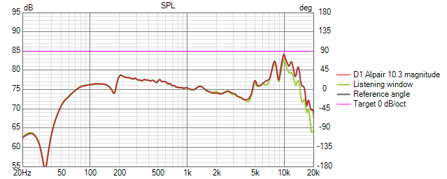

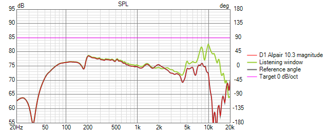

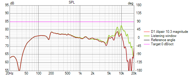

Heres on axis, 15 and 20-degree off-axis. Theres no room gain included (measured at my turning table in the middle of room) I used them years like this/without notch filter in my cottage with joy. Recently in different listening space, I made notch filter which made them more relaxed.
Awesome to see some measurements! And your enclosures look great. They definitely die off axis above 10k hz don’t they!
Have you got any with the room gain included? Would curious to see what the performance is like, up against a wall.

Thanks Mitch!
I dont need any more treble even with larger spread /room /more off-axis.
Pic in above post was taken in strange angle and they look in it much larger they are. Ill post later when in home a pic when they are positioned beside with my Axiom 401´s so you can see their size better.
I dont have any measurements with room gain included but they dont boom. I tried to simulate them in Vituixcad´s enclosure tool and they have clever tuning: response starts droop earlier at approx 150-200hz (if remember correctly) and when positioned on wall everything clicks in place. But I think my sim dont tell whole truth because they are MLTL(?) and sim was with vented option. Think its still quite near.

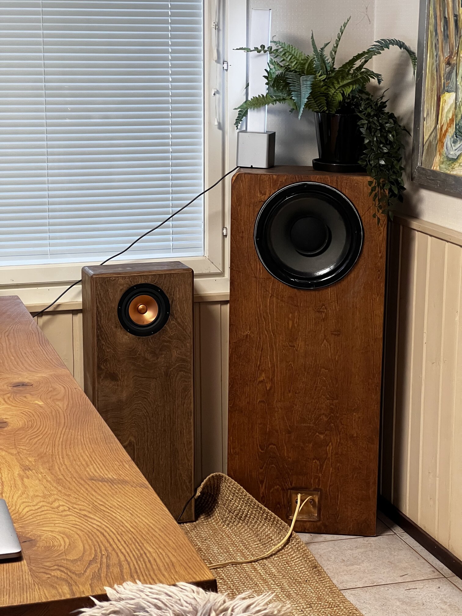

Heres Poplar with Axiom 401 next to it. Goodmans enclosure is about 86L.
Theres some damage in Alpairs cone due to the curiosity of my friend's child
