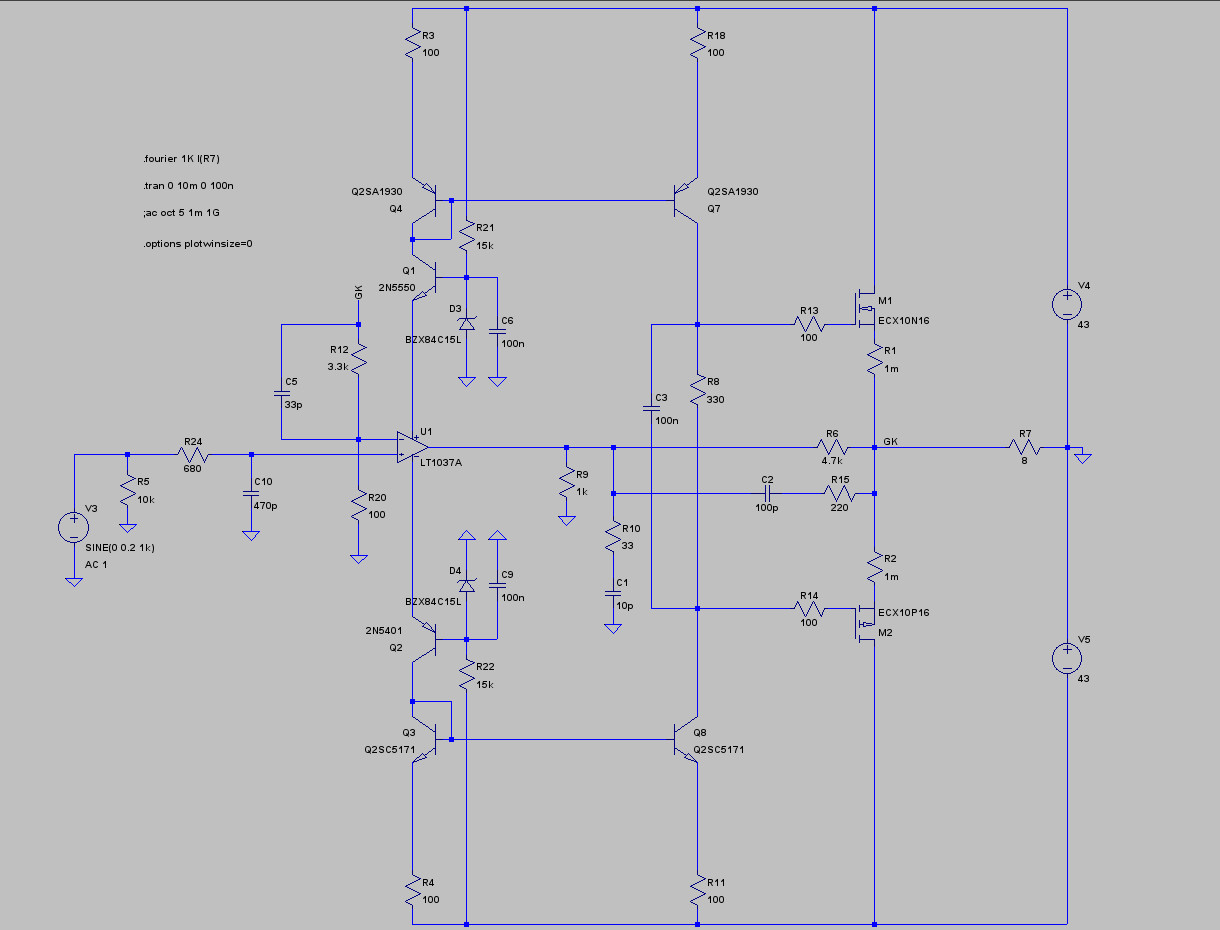

Hi Raj1,
an Amp with common source is not easy to compensate. It is also difficult to reach a good performance.
This opamp based circuit is much smaller and well known. It has a fantastic performance 🙂

Thanks for the circuit Moschfet.
What are your other impressions of the circuit posted? It sounds pretty good to me, but I have not heard the amp you posted so can't say for sure which I would go for. I guess te simplr circuit makes more sense, but I'm not sure if it measures better etc.
I can remember that I simulated such a circuit ( opamp/common source) and the results where not bad but it is easier to reach better values with less components.
The only advantage is that common source has a rail to rail output. For a good performance the circuit gets complexer.
