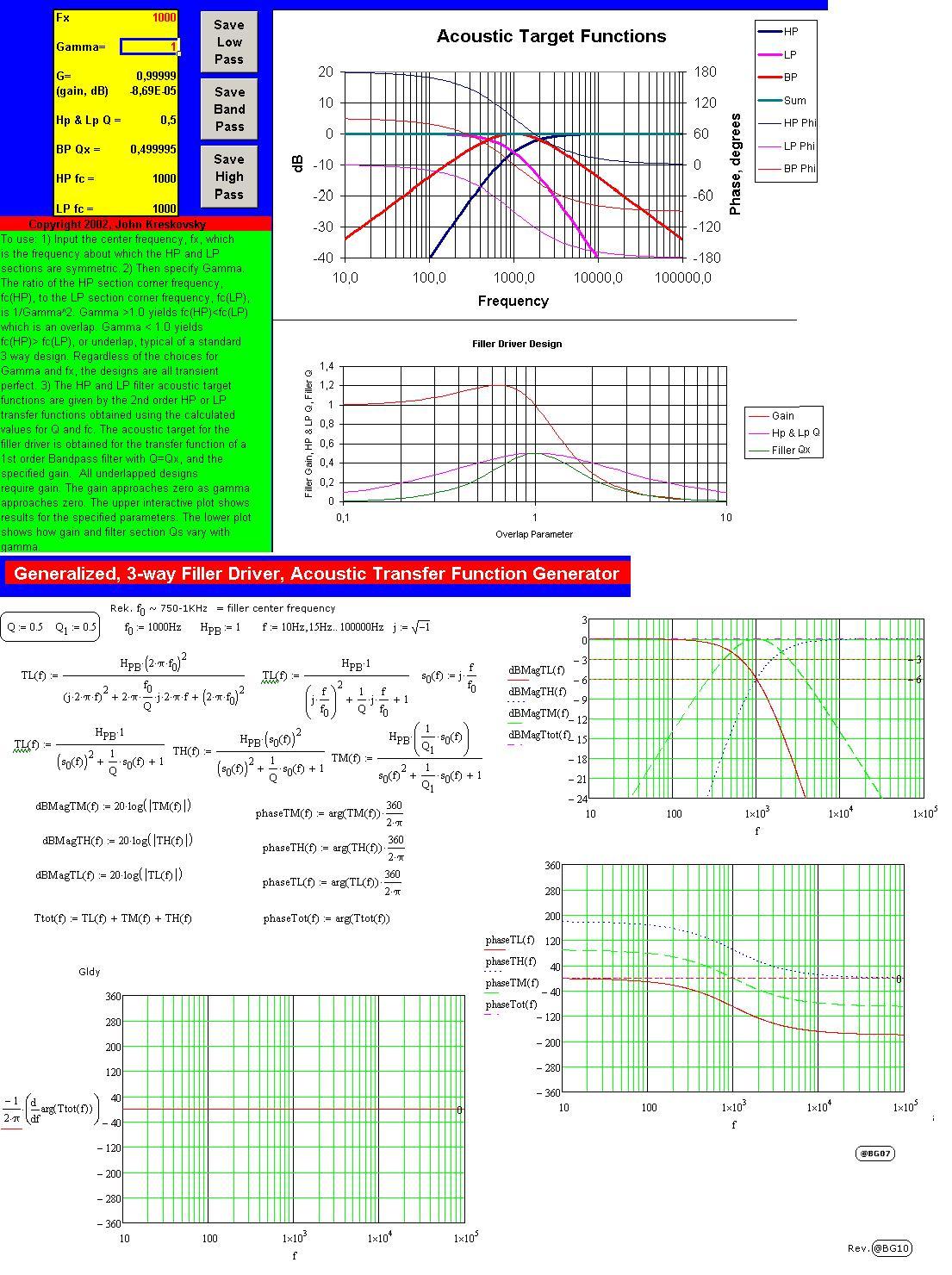

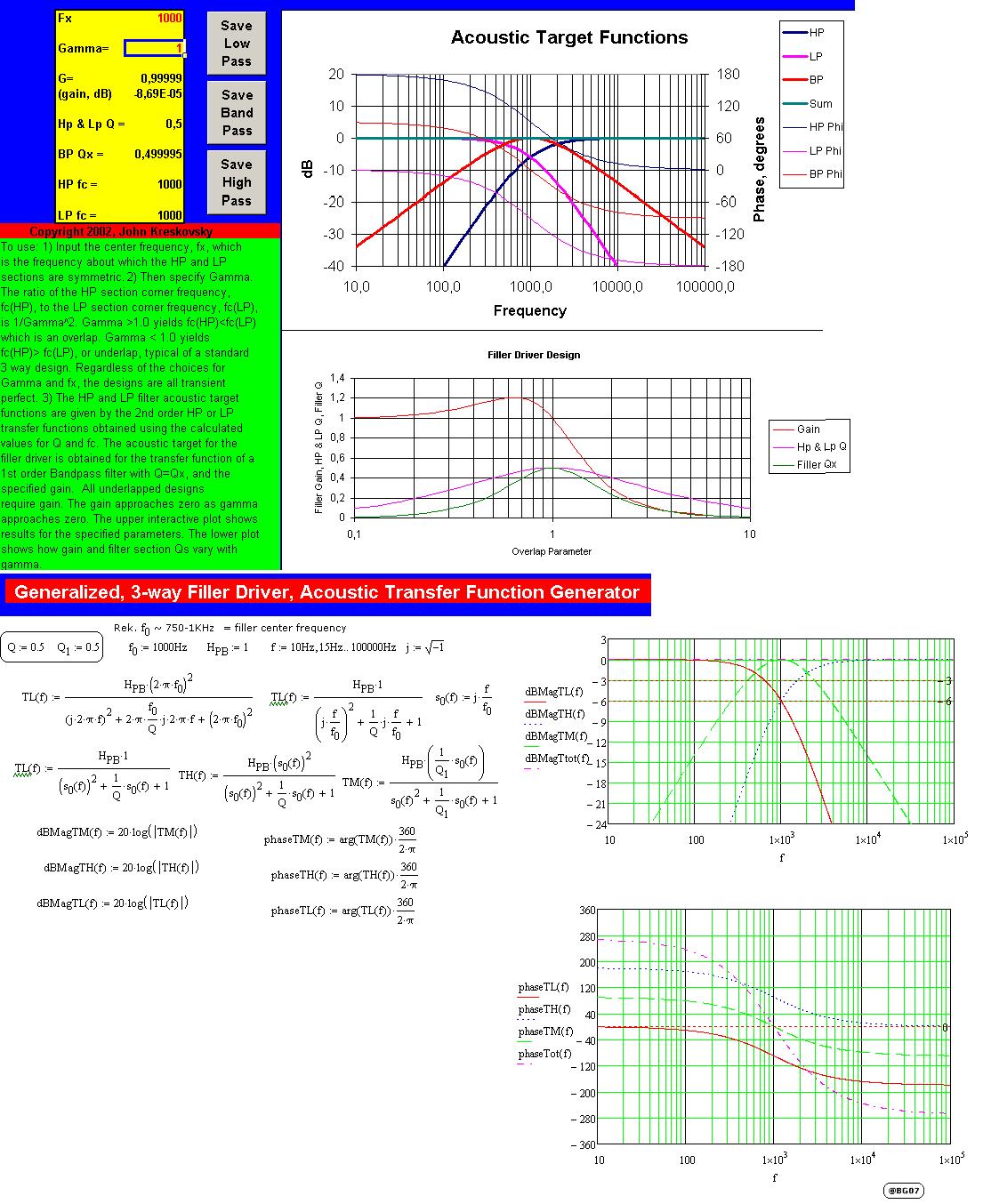

Hi Steph,My 2-cent opinions not necessarily yours😀
I've been using 3-way second order LR2 acoustic TP filters as my preferred standard for about 30 years, passive mostly for all my designs(hundreds).
All filter sections + drivers uses a resulting Q = 0.5 where the BP filter have an acoustically first order slope on both sides of the center frequency.
Note: This BP filter is not specific a Bessel-type as a BW type too shares the order too.
At that time I tried Baekgaard (IMO flawed) even/odd order BW filters too and found these only to be motivated when a single speaker is used as a centrally placed real source(IDT=0), thus never allowed to produce phantoms. Note: Surprisingly Baekgaard did never mention a filler driver system comprising of LR2 filter with Q = 0.5 for all driver sections..
I've also tested (W) M-T-M's ((W)) in general but drawing the conclusion that this type is only IMO motivated when the speaker absolute vertical M-T-M's size baffle dimension is at max ~ 20 cm (and only motivated for large listening distances(-venues)).
Thus never larger height dimensions, this to avoid unnecessary uneven magnification of the vertical MAA in comparison to what is normally is achieved when comparing with the proportional horizontal MAA. IME you have to move the T driver – 3dB below ~850 Hz and the BP centered at ~550Hz to avoid the mentioned effect.
When comparing to a normal vertical centrally placed Mono M-T layout., I had to move more than 5.5 m from the source until I judged the localization appearance(inclusive the unavoidable image smear) were about equal.
IME, if placed for stereo listening for distances up to 5m this type have serious flawed localization wise :image smear attributes above the at the normal ear height placed T-driver. When trying to forming central phantoms I always expect the verticals/horizontals to be proportionality centrally located at a straight line between the speakers and as sharp as there would only be a single 2-4” FR driver in a small box.
Filler drivers
Quick cut and paste of the filter type I,m using:See the picture.
b🙂

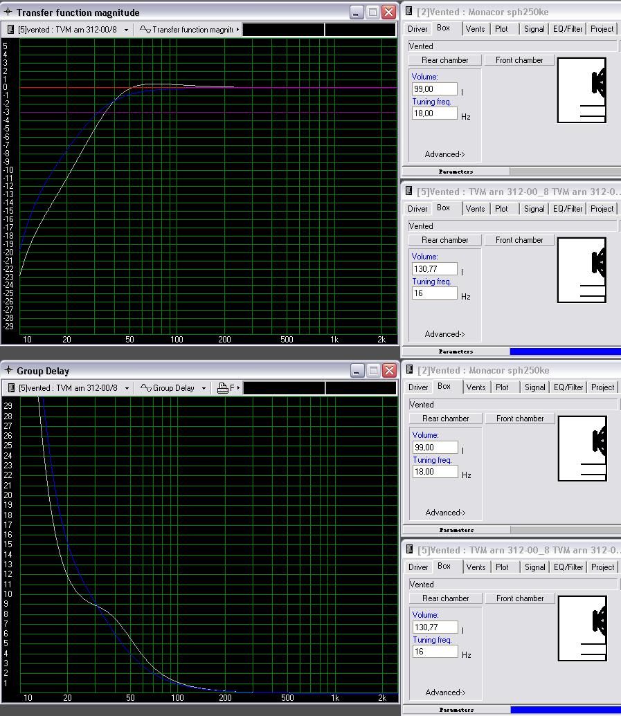

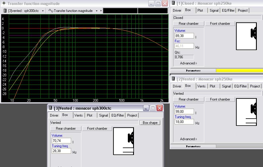

Hi steph,
Very informative treath.
The math used in the formulas is the level I shout be able to understand. But I do not see through it.
Could you be so nice to explain the build up of the formula with this wmtmw design.

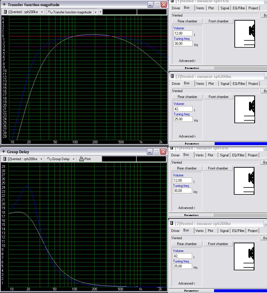

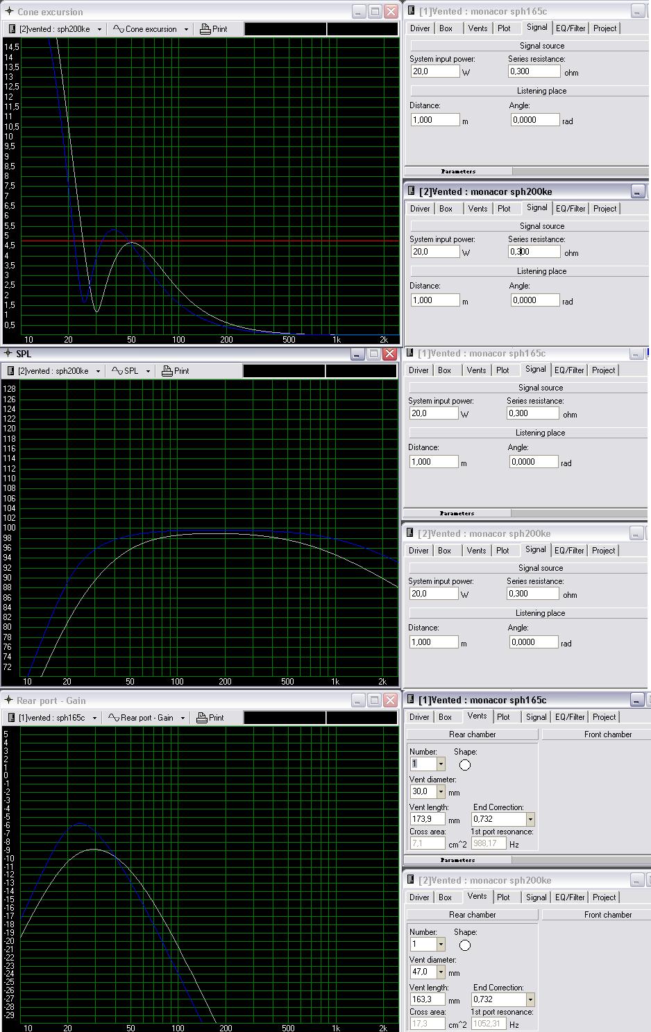

And for the woofers, your not mentioning the group delay. For small BR-woofers with low XO the group delay is huge.
There for I would advise to use a closed box group delay about 6msec. But cut of at 40Hz. Or use a efficient closed design and suppress frequencies above 40Hz to have flat response down to 30Hz.
Or use a big woofer with very low BR tuning.
Or a closed box with very low BR tuning here a example.

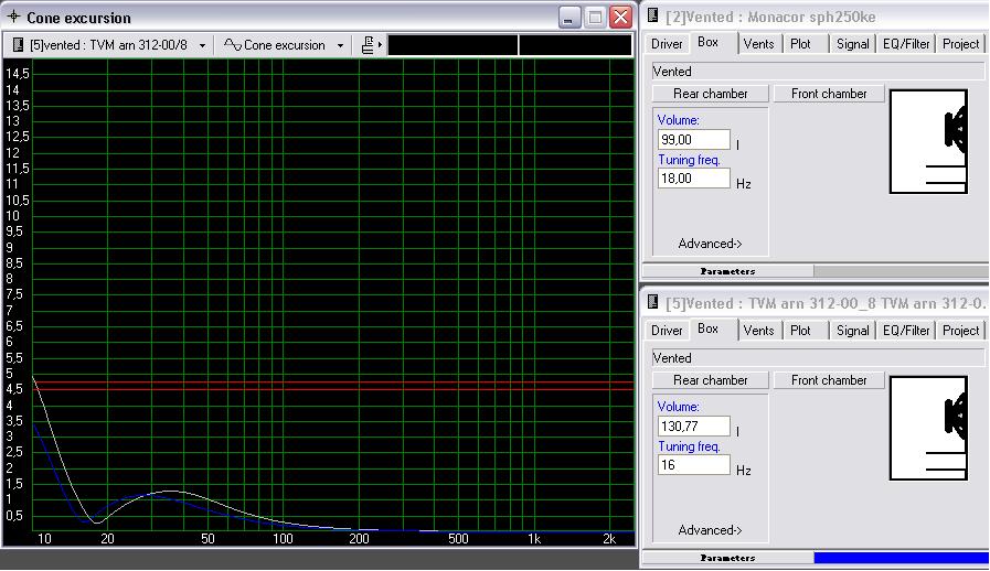

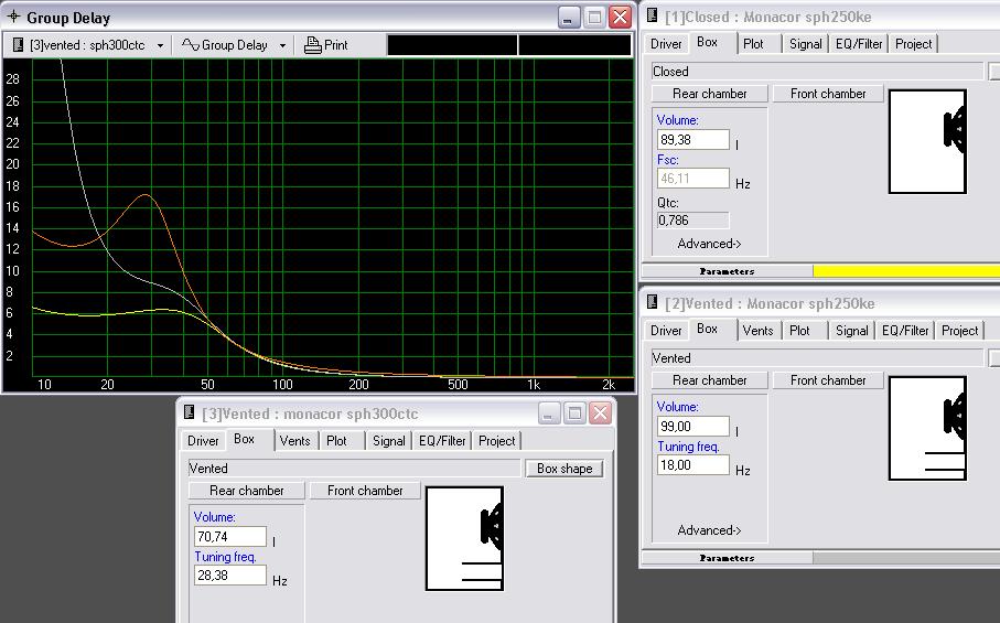

Here even better with the arn312.
The best solution will be the sph-250ke as for the size of the box and low group-delay fault.
The bas reflex tuning will work as a acoustical brake and help to improve impulse behaivour of the sub-bas. And it helps to control the x-max at sub-bas.

😱 Sorry for a mistake made in the picture (post #2) that occurred when I posted a a misguiding phase plot showing an all pass phase response instead of a correct flat line.
A new revised picture:
b🙂
hi Helmuth,
what a nice loudspeaker cabinet design software you have ! I think I'll give it a try later on.
The Erik Baekgaard concept is not about extending the output in the deep bass range, nor ensuring a low group propagation delay error in the deep bass range. Actually, as you may have noticed, the woofer transfer function is considered to extend down to DC. The Baekgaard concept is about selectively highpass filtering the tweeter (more than a 1st order) and selectively lowpass filtering the woofer (more than a 1st order) and then determine the transfer function of the "filler" unit also called the "missing link". For getting a perfectly reconstructed wave when summing the three transducers outputs.
The math I've sketched above is straightforward. I can't make it simpler. Do you own a simple textbook about electronic filters ? If not, start googling, maybe ? There should be easy and intuitive tutorials on the web nowadays.
The big issue with the Baekgaard concept is to ensure that the summation is accurate in the acoustic domain. This is not a trivial task knowing that a d'Appolito arrangement is needed (WMTMW) for getting virtual coincident sources. You need the d'Appolito layout because the Baekgaard crossover (unlike a Linkwitz-Riley) generates significant inter-driver phase shifts in the overlap region. And the overlap region is wide as the order of the filter is only 2.
There are four very important tests to be carried out to check if your WMTMW arrangement is correctly dimensionned. I think this is what bjorno wanted to express in a nutshell, in his above post. Thanks.

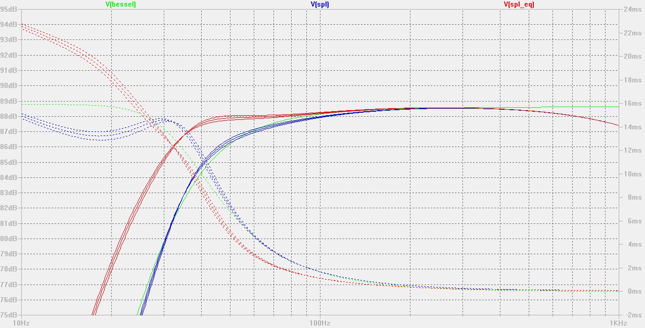

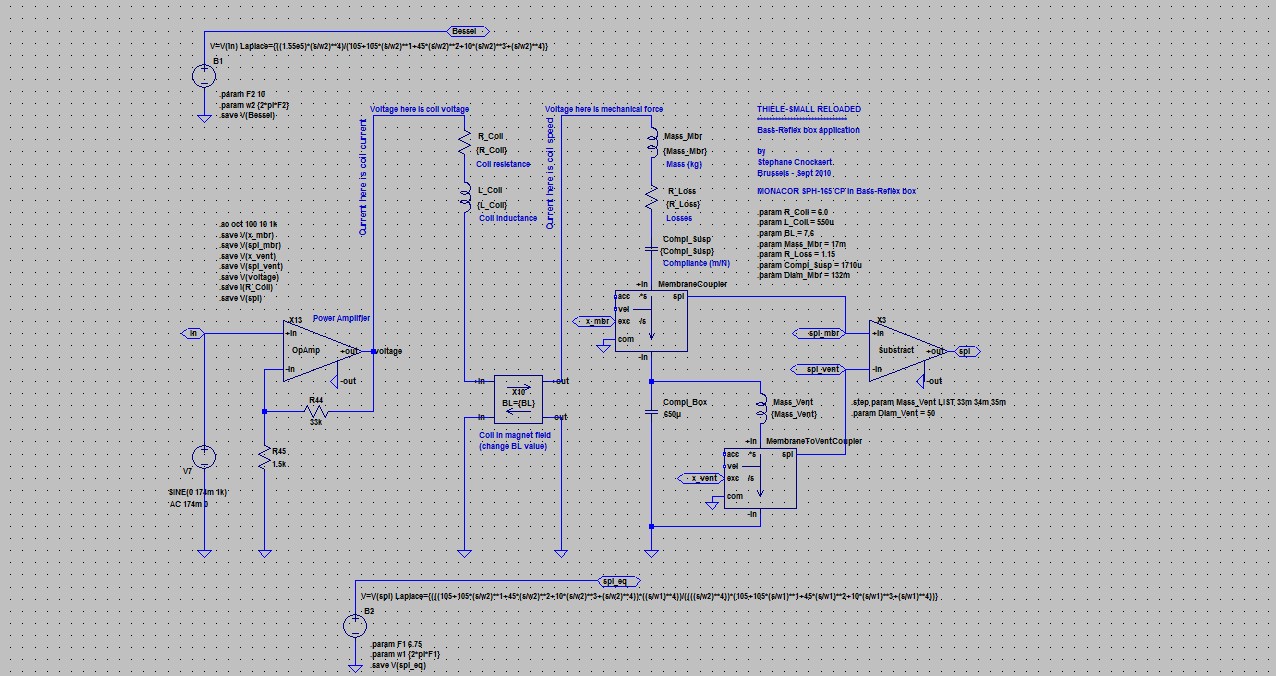

Let us take a Monacor SPH-165 CP in a Bass-Reflex arrangement.
Let us first tune it to a Bessel. The box compliance needs thus to be 650µ m/N and the vent mass needs to be 34 gram.
We end up with a 43 Hz cutoff at -3 dB. The group delay is 15 ms at 30 Hz and only 7 ms at 50 Hz. This is decent. I shouldn't worry about group delay with such figures.

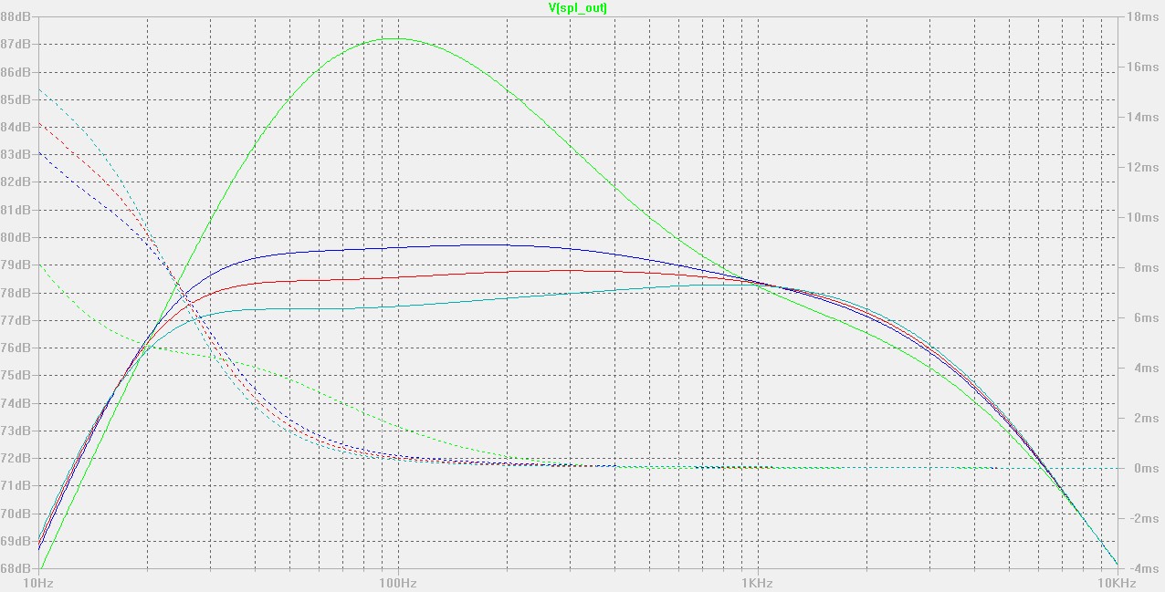

I confess the 43 Hz cutoff frequency may deceive.
Let us thus apply equalization for extending the bass range, with a new Bessel response as target, with a lower cutoff frequency like 31 Hz.
We end up with a 31 Hz cutoff at -3 dB. The group delay is 12 ms at 30 Hz and only 5 ms at 50 Hz. This is excellent. There are very few loudspeaker systems on earth, providing such outstanding performance.
I am now attaching the simulation files.
Steph
  • Monacor SPH-165 CP bass reflex 650µ 34m.zip
hi Helmuth,
winisdpro freeware
I think of it also as a shift in time so to have the reproduction as close as possible I did try to reduce the group delay.
The Baekgaard concept is about selectively high-pass filtering the tweeter (more than a 1st order) and selectively lowpass filtering the woofer (more than a 1st order) and then determine the transfer function of the "filler" unit also called the "missing link". For getting a perfectly reconstructed wave when summing the three transducers outputs.
I did understand that only the build of formula I do not see how it works.
Sph200ke even better group delay at higher frequencies.
Stephan do you use a normal spice program to simulate the response as I see in the picture?
hi Helmuth, you need to understand the context when I say that for the Baekgaard design, we have no concerns about the deep bass extension. This Baekgaard is operating at 1700 Hz. The woofer transfer function is considered as a low-pass function at 1700 Hz meaning that, yes, indeed, it is considered like extending down to DC.
You need to understand this before going deeper.
Let me be very clear, if you want to optimize the deep bass range, Baekgaard can do nothing for you. And remember : the bigger your woofer driver, the more distant they get in a d'Appolito arrangement so the more difficult the full cancellation with the tweeter at the crossover frequency (here, 1700 Hz).
However this has nothing to do in a thread dedicated to the Baekgaard, I will now suggest Motional Feedback (as done by Philips long time ago) for extending the deep bass without any penalty regarding the group delay.
See the pictures and download the attached files for the full kit.

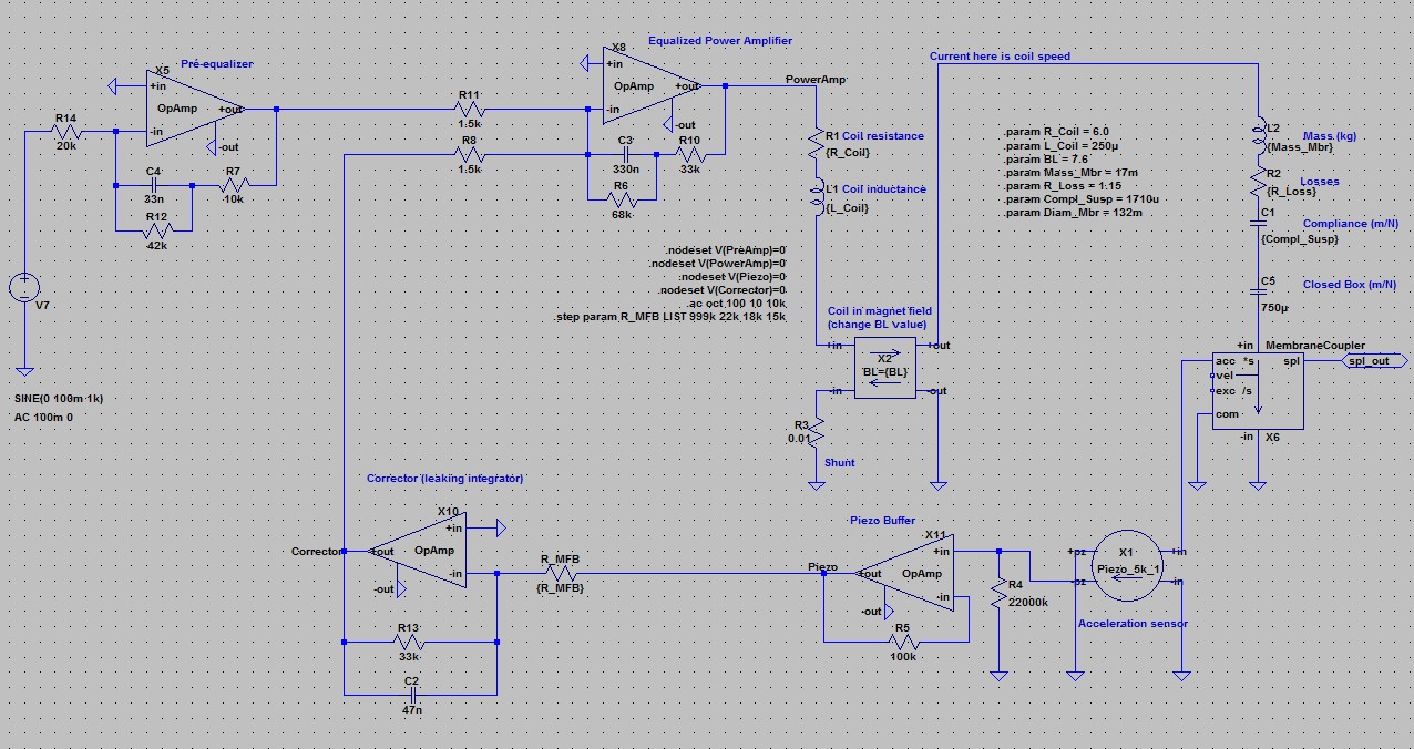

With Motional Feedback, the two Monacor SPH-165 CP can deliver a decent energy in the deep bass before facing their excursion limit. The red curve shows the result when applying the correct amount of acceleration feedback. The -3 dB cutoff is 20 Hz. The group delay at 50 Hz is 1.7 ms. You should be happy with that.
As you may have noticed, this is a moderate Motional Feedback arrangement, with less than 10 dB motional feedback. The motional feedback amount is the diference between the green curve (feedback resistor nearly infiite) and the red curve (optimal feedback resistor). A side-advantage of the motional feedback is that it reduces distorsion (if the sensor is securely glued) in the frequency band where the motional feedback is dominant. In our example, this is the 40 Hz to 300 Hz frequency band, where we can expect less than half the distorsion of a passive Closed-Box.
The simulation program I'm using is LTspiceIV, shareware in free download on the Linear Technology website.
I'm now attaching the files.
Steph
Steph

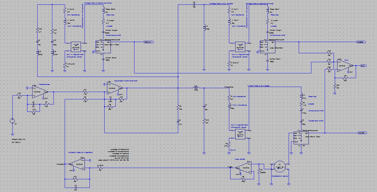

hello Helmuth,
here is a quick and dirty way to get the Baeckgaard done using Motional Feedback and passive filtering. The final curve looks excellent. The group delay is essentially zero in the overlap region. Actually, the crossover is 1200 Hz instead of 1700 Hz with the values on the schematic. I needed to cheat with the sensitivities of the Tang-Band drivers. Their membrane diameters are inaccurate (inflated values) on my schematic. I needed to cheat because the Monacor SPH-165 CP delivers more dB per volt than the tiny Tang-Band medium driver and the tiny Tang-Band tweeter driver. This may be solved in the real world by connecting the two Monacor SPH-165 CP in series. This way the Tang-Band tweeter will deliver sligtly more dB per volt than the two Monacor SPH-165 in series, in such a way that the overall treble balance can be balanced using a small resistor in series with the Tang-Band tweeter. Regarding the medium drivers, I don't know if it will be possible to connect them in series, or if we will need to put them in parallel. A small resistor inserted in series with the two medium drivers will enable adjusting the "filler" level. I'll refine all this later on, updating the schematic with a better represention of the parallel and the series connexions of the drivers in general.
Motional Feedback demands adding an acceleration sensor under the dust cap of the woofer, exactly as described by Elektor. Thanks for providing this very valuable practical info !
Having two woofers needing to deliver the exact same amplitude and phase in the 850 to 3400 Hz range, it may be needed to equip both woofers with one acceleration sensor, and electronically mix their outputs. ON top of this, selectable resistors and capacitors may be be needed for matching the woofers bode plots.
This is going to be precision work ! This is where the DIY concept is at best. In a commercial environment, only very few people can afford buying loudspeaker systems embedding all those complications, all those high precision manipulations.
In this schematic, the lowpass filtering of the woofer is not compliant with the Baekgaard theory. With this schematic, it looks more 1st order than 2nd order. I don't know if I will be able to improve the slope without impacting the linearity of the resulting amplitude curve.
See the pictures.
I'm also attaching the whole kit in a .zip
Steph
