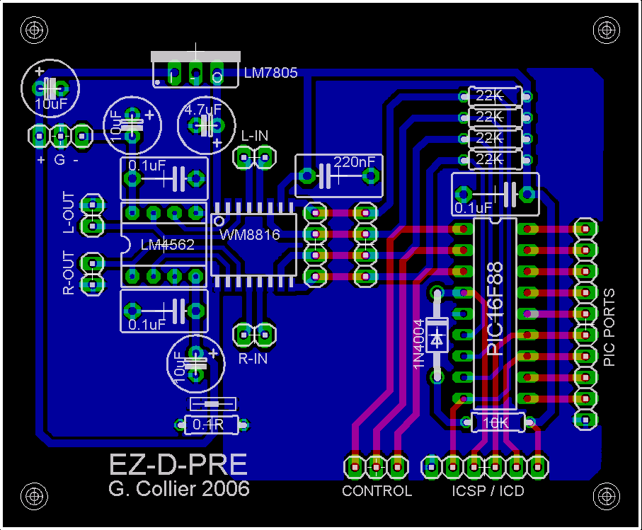

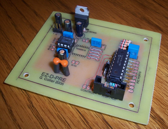

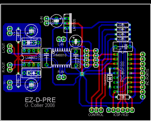

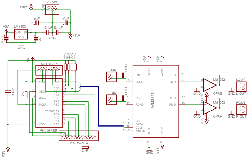

Well my conclusion from version 2 of this circut is that it sounds like $hit! Too bad really I was hoping this would work out well...oh well back to the drawing board. I toyed around a bit with the grounding and the supply, but just couldn't make it sound good. For reference I am using an OPA627/buf634 setup. This setup just didn't come close to that for me. It certainly isn't the opamp that is at fault as this one sounds great in some other implementations, even in a simple CMOY. I suspect that I am getting noise introduced from the PIC. I should have followed Vetrans idea of using an optocoupler.

i don't know the details of your implementation, so i'll ask my dum question anyway - does the sound improve if you put the micro to "sleep"?

If you have uC noise problems, put the uC to sleep when it isn't actively changing the volume. In sleep mode even the clock oscillator stops.

Actually it does have ports for an LCD display. I didn't bother to connect or code for it for experimentation purposes. It's a 20 X 4 backlit unit. I used buttons in this implementation but was actually planning on using a simple 10K pot read through the AD convertor and using that to adjust the volume. The PSU I used to feed this is actually quite good. It is a regulated supply followed by a discrete regulator. I included an LM7805 on the board for the necessary 5V for the WM8816 and the PIC.
I didn't actually put the controller in to sleep mode, I'll give it a try and see if it helps any.
