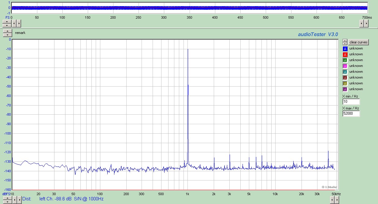

I used the Jensen JT-11-DMPC with amazing results. Series resistors are not needed and discouraged. The specifications in the data sheet apply to AC impedance, of which the transformer is huge. As long as you keep your connected load impedance within spec you will have no issues. There is no DC coming out of the differential DAC, so you don't need to meet a DC resistance minimum load spec.
Your connection options really depend on the gain structure of your system, not so much which one would sound better than the other. For a decent transformer they will (barring that third diagram) be the same but with potentially different output voltages.
Regarding transformers try and make sure you are purchasing an output transformer, not an input transformer or something else not specifically designed for output service. Jensen's website has some nice articles on the differences between input and output transformers.
No, I use the AK4393, which is very similar to the WM8741. They are both 24 bit Delta Sigma and use differential voltage outputs. The WM8741 has a higher maximum sampling rate.
Wiring is easy as can be- tie the two DAC voltage output pins to pins 2 and 5 of the Jensen. Pins 8 and 11 are the transformer output, which you can use either balanced or unbalanced.
Distortion is nearly identical to that published by AKM, indicating the transformer added almost nothing to the signal. I am sure my sound card setup was not perfect, either. The 20Hz FFT in particular I am pleased with. Not easy to do with a transformer.

The WM8741 delivers 2,00V into 10 kOhm in PCM mode. I've set it up with in dual mono mode with a pair of Lundahl LL1690 transformers as said earlier in this thread, going directly into a 10 kOhm potentiometer and from there into my SymAsym Amps. Works like a charm ...
