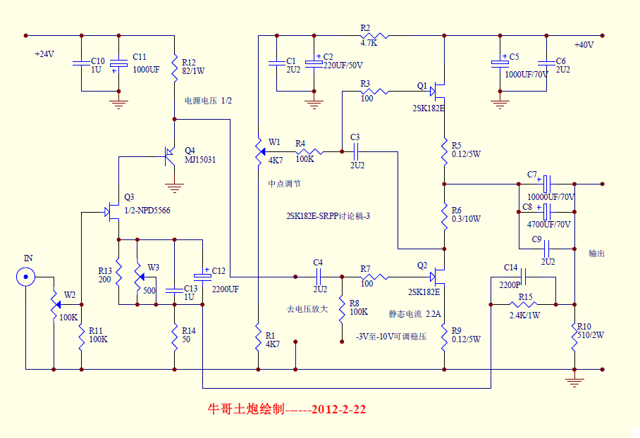

With painted a circuit, STI(2SK182E) pipe of the SRPP circuit, is feasible?
L lgqliu Member Joined 2005 ngtop.slqedu.com 2012-02-22 5:42 am #1 2012-02-22 5:42 am #1 With painted a circuit, STI(2SK182E) pipe of the SRPP circuit, is feasible? Attachments 2SK182E-SRPP-2.png 69.9 KB · Views: 353 Last edited: 2012-02-22 5:44 am ••• More options Share sgrossklass Member Joined 2004 stephan.win31.de 2012-02-22 5:15 pm #2 2012-02-22 5:15 pm #2 There still is a problem at Q3/Q4. Q3 still needs power, and Q4's Vbe + Ic seem undefined. ••• More options Share L lgqliu Member Joined 2005 ngtop.slqedu.com 2012-02-25 7:07 pm #3 2012-02-25 7:07 pm #3 Q3andQ4,Works no problem ••• More options Share Show hidden low quality content Status This old topic is closed. If you want to reopen this topic, contact a moderator using the "Report Post" button. Share: Facebook Twitter Reddit Pinterest Tumblr WhatsApp Email Share Link
