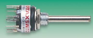

Here's an example of a small rotary,

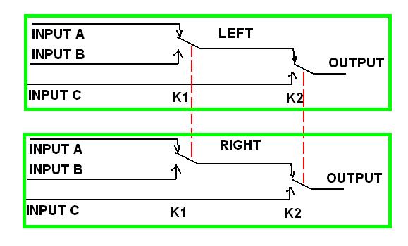

Switch centre off is input A
one side energizes K1 for input B
the other side energizes K2 for input C
K1 right and K1 left can be a dpdt relay or two spdt
same with K2
Does everyone forget the normally closed contacts?
