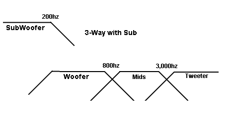

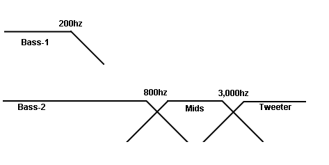

If we assume this is ultimately a 3-way with a Midrange, then there are two ways to do this.
1.) At the lowest of the low frequencies, both bass drivers run in parallel. That would be a 3.5-way system.
2.) Build the equivalent of a 4-way system - Low-Bass, Mid-Bass, Midrange, tweeter.

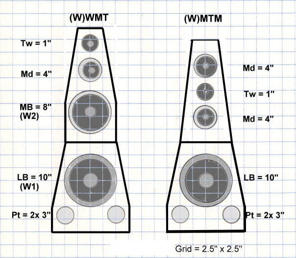

I've considered doing something similar with a 10" and a 8". Using not the same size drivers is unconventional, but it can be done.
Now, I used 3-way and 4-way in my examples because I already had those graphics. The absents or presents of a Midrange is up to you.
Though I think the 60hz and 200hz crossovers are bit unrealistic. Though what the precises crossover would be would depend on the rest of your design.
In a 3-way, the Low-Bass crossover could be in the 100hz to 300hz range, and the Mid-Bass to Midrange crossover would likely be in the 500hz to 1000hz range, though 500hz and 800hz are common in a 3-way.

As an example, if the Low-Bass covers 0hz to 200hz, and the Mid-Bass covers 200hz to 800hz, those impedance are not combined. Each has the impedance of a single speaker in their Pass-Band.
In a 2.5-way or a 3.5-way the Low-Bass would cover, just as an example, 0hz to 200hz, and the Mid-Bass would cover 0hz to 800hz. So, both are in parallel between 0hz and 200hz with a combined parallel impedance of 4 ohms. Above 200hz, the speaker system would be 8 ohms.
