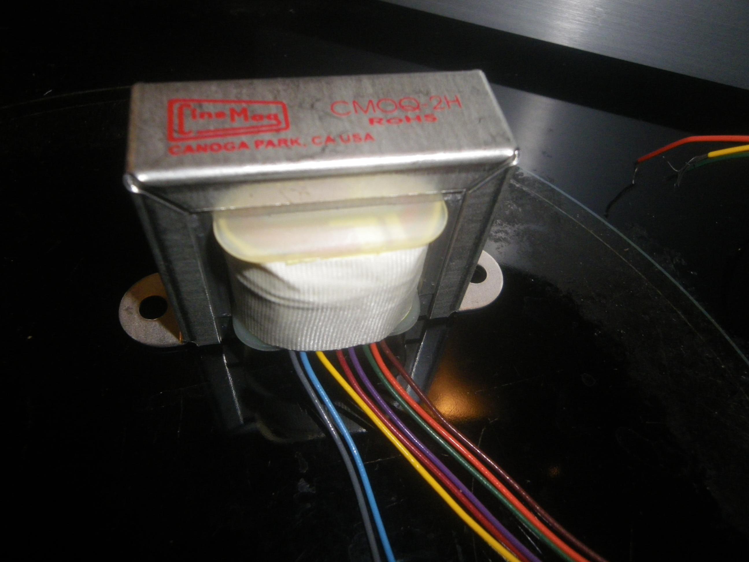

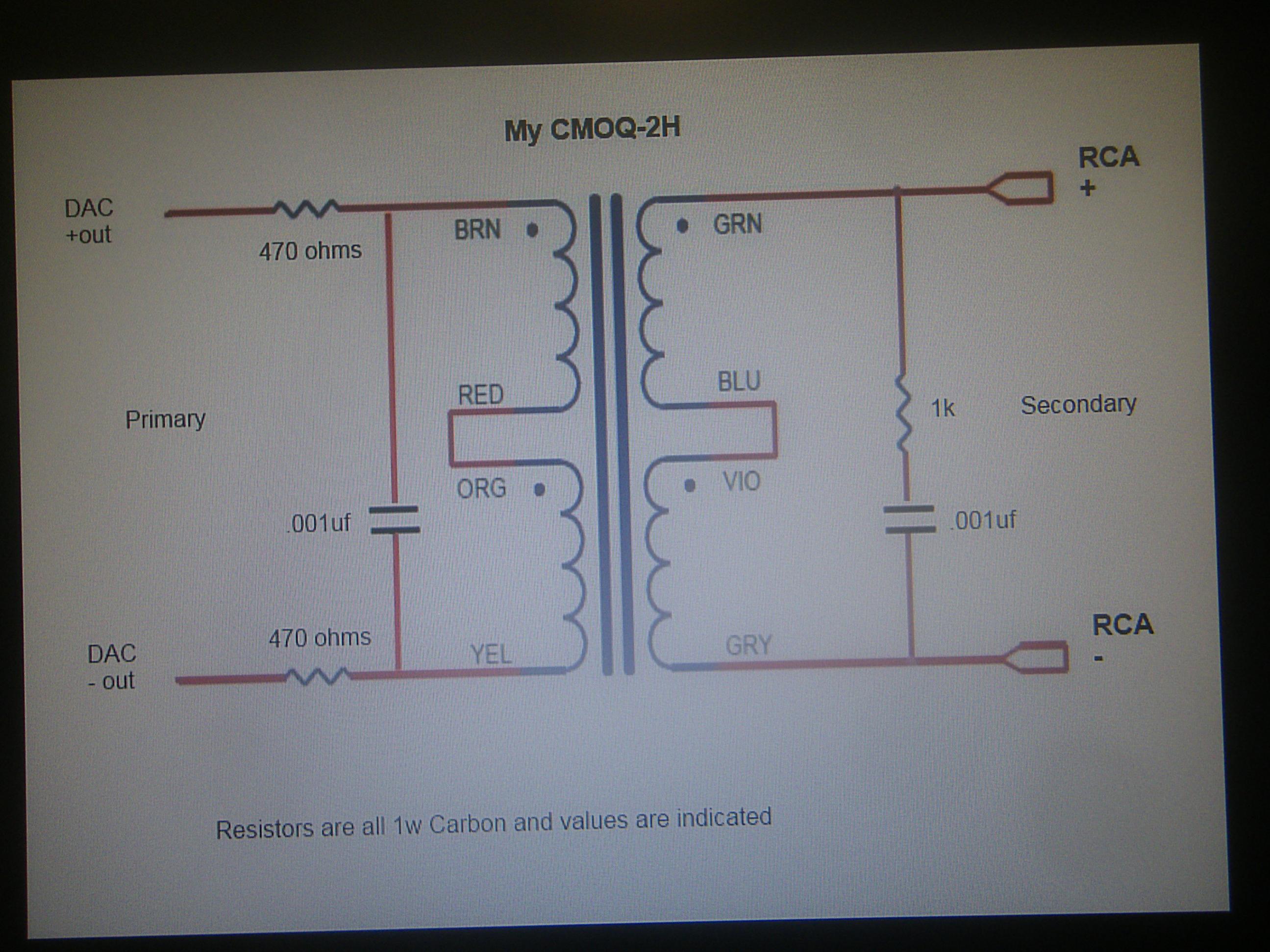

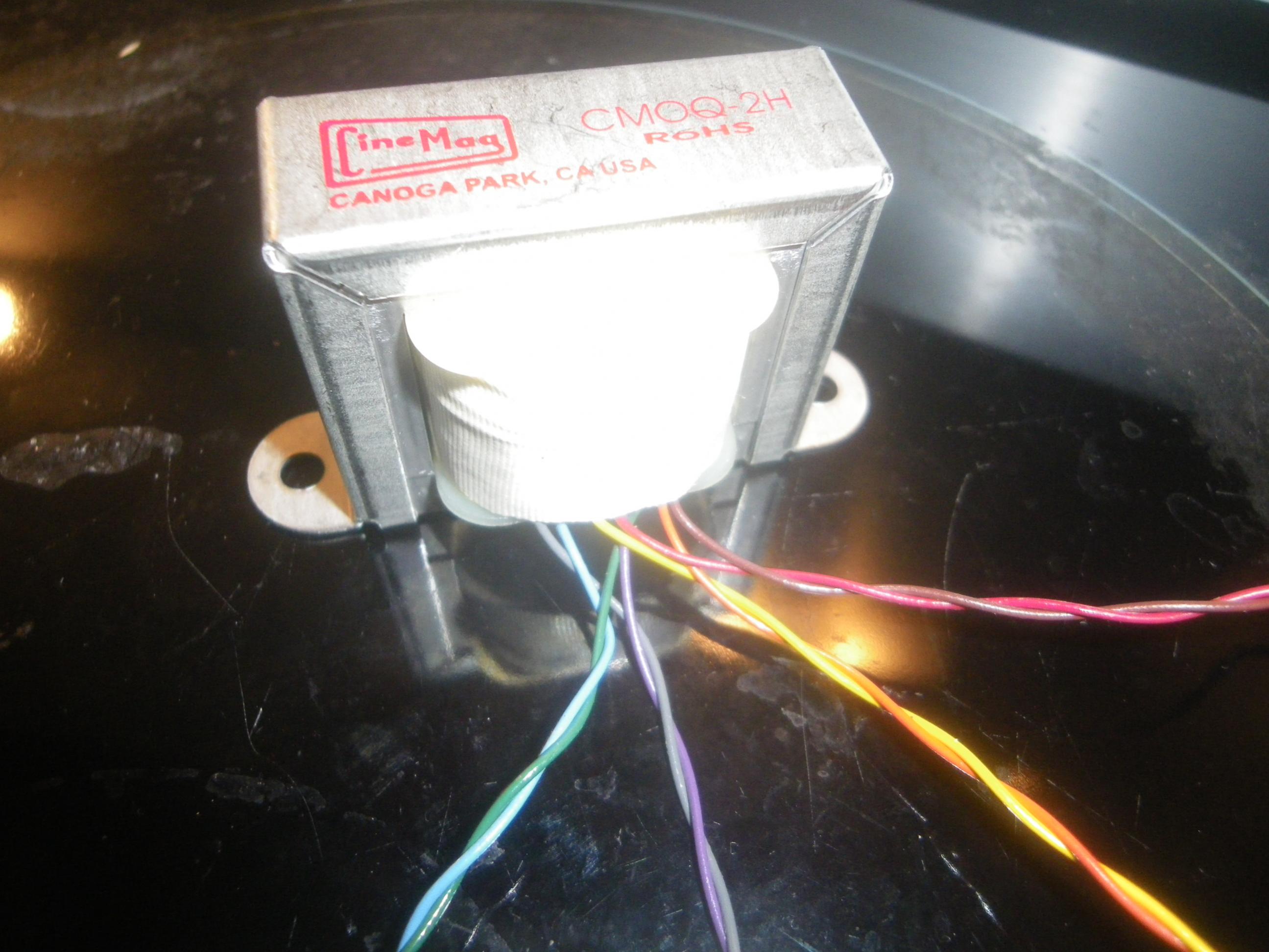

I'm wiring two Cinemag Output Transformers (CMOQ-2H) to a Gigaworks DAC. Nothing new I know, but I'd like to check the wiring to make sure I'm doing it right.
On the attached schematic and photos:
Do I pair the wires up as shown and then solder away?
Or are the Red, Orange, Blue and Violet not used?
I can fathom the rest I think.

Red and orange should be soldered together and then not used. Blue and violet should be soldered together and then not used. Brown and yellow to the dac. Green and grey to the RCA's.
Connect Red to Orange.
Connect Blue to Violet.
Brown and Yellow is input, Green and Grey is output.
Perfect, thanks a million, I considered that looking at the diagram but thought I'd better double check.
