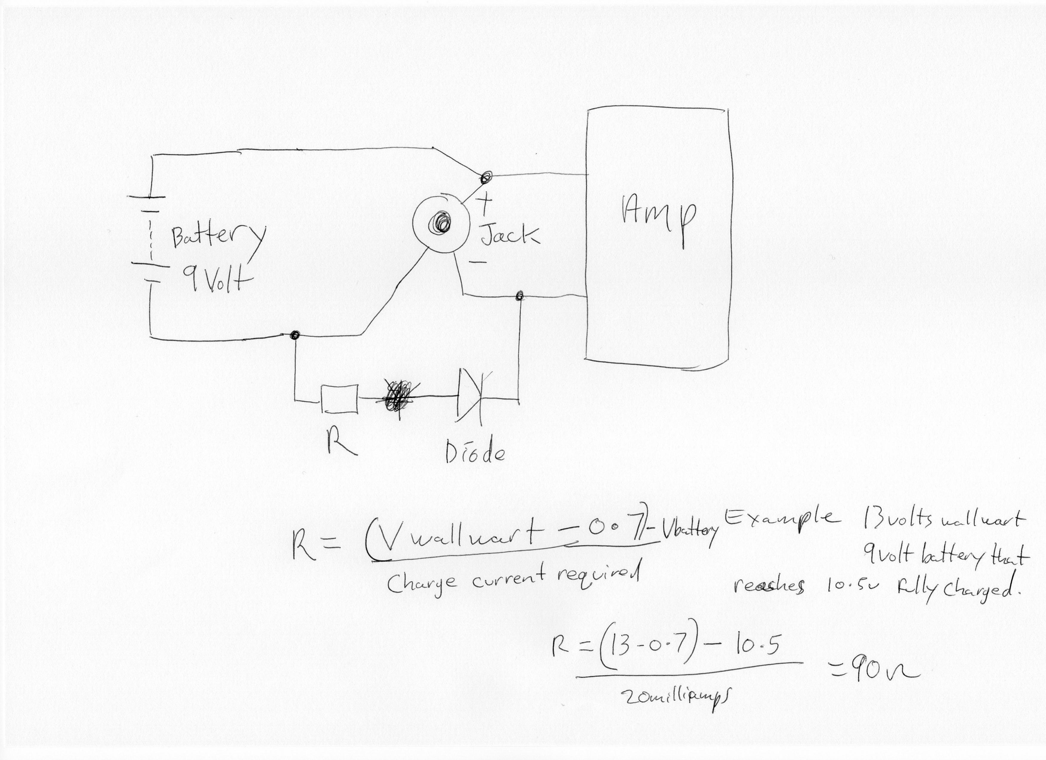

IIRC, you can apply 10% of the battery's capacity indefinitely with no ill effects.
For a 2000mAh battery, you could put 200mA through forever, and it'll survive. It'll also charge (taking 10 hours from dead).
I'd try to set the voltage for that.

Mooly and Chris again thank you for your expert advice.
Sorry for my delay in responding, I went and visited my auntie on the mainland.
I am trying to wrap my brain around the wiring for the rechargeable battery. I started drawing up a diagram but failed miserably. LOL
I am sure if I read your directions another 50 times I will get it figured out. haha

Something like this. The wall wart voltage minus 0.7 volts (diode drop) give the voltage you have available to charge a battery. Divide that voltage by the charge current required.
