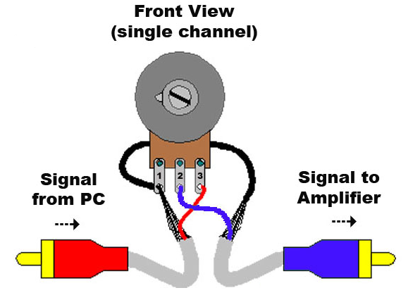

I have a CDA-254L Kit from Class D Audio. I want to wire a dual gang pot on the line level (obviously) and need to figure out just one thing. Google provides a few alternatives that seem to have no logical choice pattern.
Where the hell the ground on the vol pot should be wired.
Should I wire like this:
attachment.php
or should my ground go to the AC mains ground/earth?
Nothing else in the kit needs to be grounded (I asked) and so my amp is being mounted to an open wooden board (for now) so I can't just ground to the case.
That looks just about perfect to me.
You don't need to connect the black (braid) to anything "earthy" - that will be taken care of in the PC and/or Amp.
