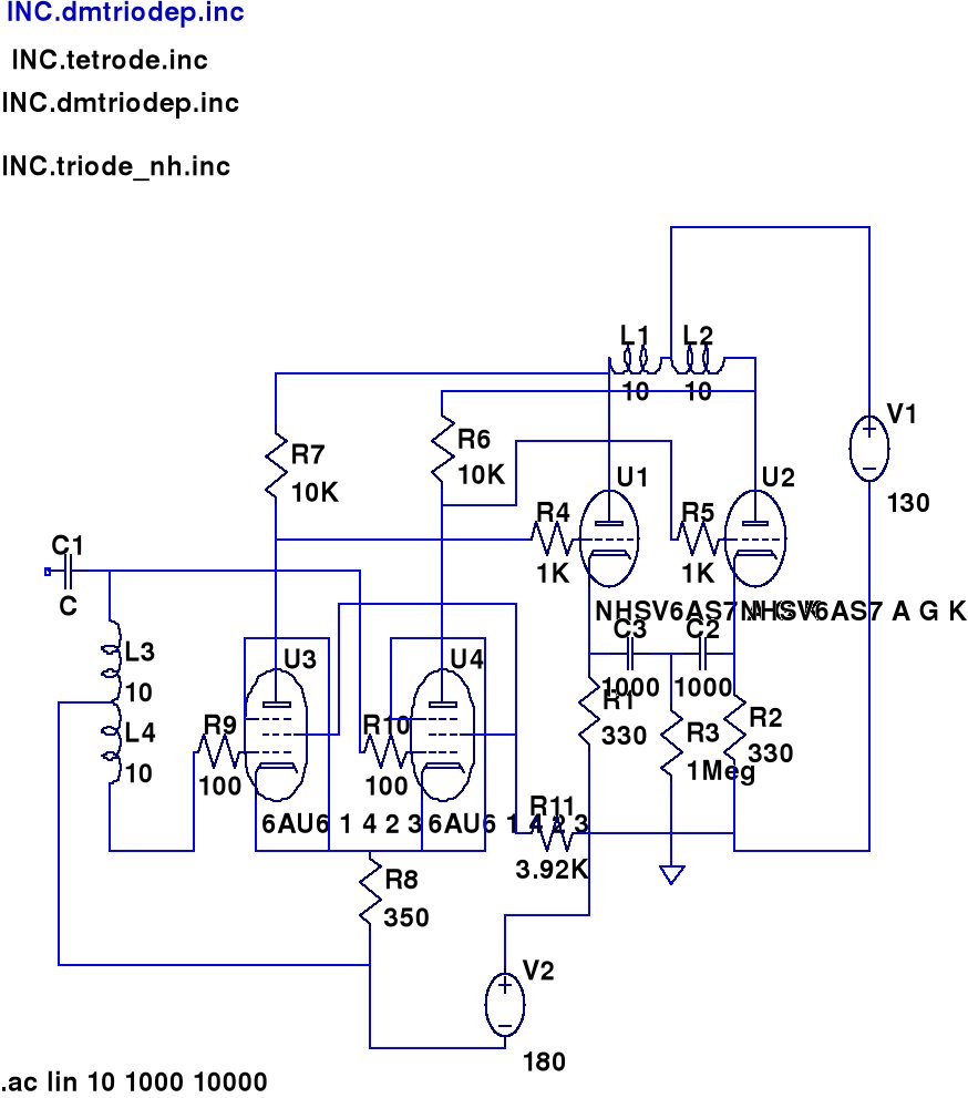

You don't need +/-100V drive.
150V/60 mA at about -65V bias is a very good compromise for this tube. Primary load 2K-to-2.5K plate-to-plate for PP or 1.4-1.5K for SE. You only need a driver capable of +/- 70V swing. Positive grid drive is not recommended. In my experience it is better to stay below 10W plate dissipation (for each section) in order to achieve some useful life.
I run mine at 100V 100mA which has 30V (B+ of 130V) across the cathode resistor. This then only requires 30V of drive for full output and the grids are relatively easy to drive at this bias point. Very reliable and a much fuller sound than run at lower currents and higher voltages.
The triodes are very variable between sides so simply tying the cathodes together is a recipe for disaster.
As for bias arrangement, what is shown below works, though LM317 CCS at 100mA work better in place of the 330R;

PS, that circuit was never built as shown so is only there for reference to the output bias arrangement. However the circuit design approach has been used in my current amp of two years standing.
Shoog
