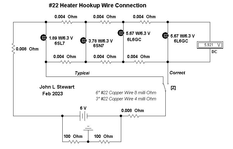

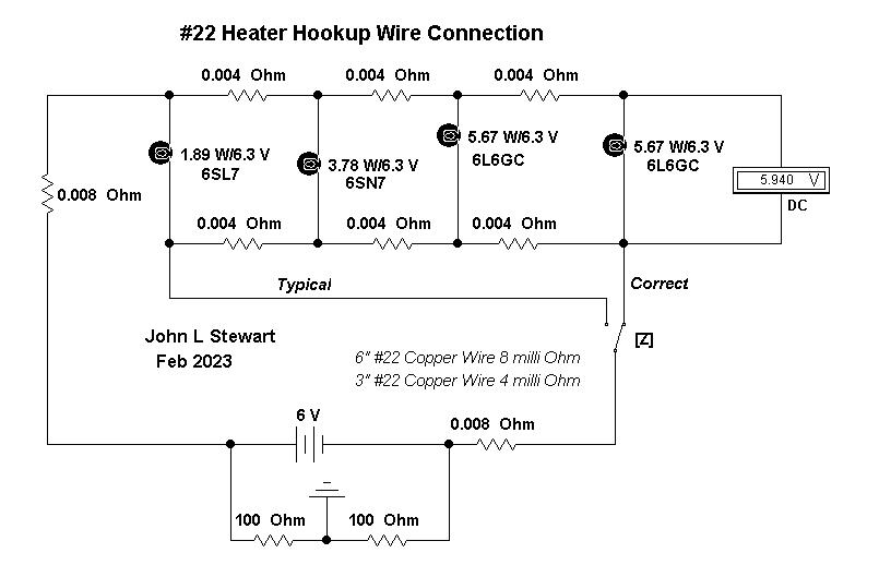

Heater Wiring, Typical & Correct.
This example is something ubiquitous in the 50s, but usually with #18 hookup wire,
Here is what happens with the ordinary, end fed heater potentials operated with #22 wire.
Not much of a problem in this case but would be more so if running an amp with PP 6AS7Gs.
And an even bigger problem for an OTL with a row of 6AS7Gs or 6C33s.
Running the heater supply in to opposite ends helps.
