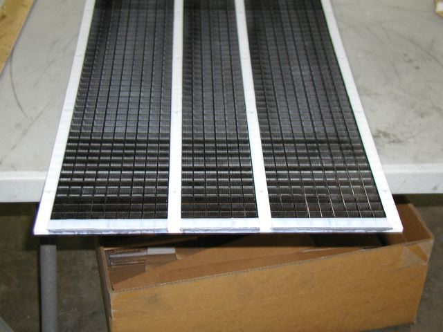

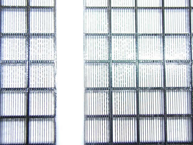

Have had good results with...
using 30 gage magnet wire 24 wires per linear inch. I use a 24 thread per inch threaded rod as a guide. More wires per inch provides higher field stength and the lower open area provides resistive acoustic damping to the diaphragm. Have attached a picture not great quality but should give ou an idea. hope this is of some use.
Thanks, Moray James, for the information and photos. It's helpful. Your photo seems to show considerably more open area, compared to the wire diameter, than what I've got planned. What's the percent open area for the stators you showed in the photos?

Off the top of my head ....
I would say that the open area is probably about 33% don't quote me but it's in that ball park it might be a littl less, I have been considering 32 wires per inch. The cubes in frame I showed are 1/2 inch square. Have atached a picture of half a panel which is a three section two way

Just from Moray James's photo I would have guessed an open area over 50% but it's hard to say with any confidence. MJ: What's the diameter of the magnet wire in those photos? My table of wire gauges suggests 30 gauge wire has a diameter of 0.25 mm but that won't include the insulation. If there are 24 wires per inch, that's a center-to-center spacing of 1.06 mm. If we neglect the fact that we're missing the insulation, the open area would be about 76%. Obviously that number will drop when the insulation is taken into account, but will it drop by more than a factor of 2? Am I doing something stupid with my arithmetic?
