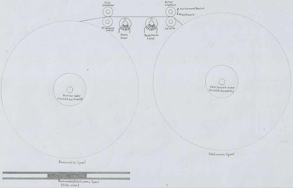

Oh no, I do not own one. I design one!
Here is a preliminary rough design of mine. It does not show the parts details so do not build it until I finish it and present it here. It is my idea and improvements over the original designs of wire recorders. Of course some things from the tape recorders have been borrowed and applied to the wire, like the capstan/spindle pair, to achieve constant speed.
The spools are not compatible with the vintage wire recorders, because my design aims on mechanical simplicity. Keeping the spools large in diameter, but with very little width for the wire to be wound, avoids the use of a complex "fishing reel" winding mechanism. Because of the spindle/capstan there is no speed change caused by the large diameter of spools. I use 0.4mm wire which is a bit thicker than the originals, but it is stronger and less prone to breaking. The large diameter spools would in theory hold quite a good amount of wire.
Fast forward function is provided and stretching of the wire is performed by reverse movement (but low torque) of the reels motors.
So you see how simple my design is?
Any comments are more than welcome!
So In that design I would like to investigate the effects of speed reduction combined with preemphasis of the high frequencies. Basically the previous questions in the previous posts (#8 and #9), just to find out more about the speed issues.

You can't apply "infinite" EQ. The recording systems we know and use already have great heaps of many-pole high-boost. Any more gets trouble with record distortion or play hiss. This would be comparable to a smaller pen and sharper magnifying glass on the ink: at some point you just can't make/read any smaller.

Thanks a lot for the useful explanation and also about the article posted. I understand the problem with the speed you mention now and why was it operating at high speed.
I wonder how do you find my wire recorder idea?

When recorded wavelength becomes comparable to recording "window" width it starts erasing itself.Well if the high frequency response is the reason for the high speed, why couldn't we use an emphasis of the highs during recording so that the audio response curve is equalized, without the need for high speed? Dolby on tapes does a very similar thing, but back on the wire days there was no dolby probably.
EQ cannot help you with what´s not there to begin with.
Same way as no amount of EQ will turn a 1" "woofer" into a PA type one.

Hi again,
The head used to be a toroid with a gap at one end and onto the toroid the wire was wound. The toroid then becomes an electromagnet with changing magnetic field intensity, depended on the signal fed into it.
A problem with the wire recorders is referenced on wikipedia:
"Poulsen's original telegraphone and other very early recorders placed the two poles of the record/replay head on opposite sides of the wire. The wire is thus magnetised transversely to the direction of travel. This method of magnetization was quickly found to have the limitation that as the wire twisted during playback, there were times when the magnetization of the wire was at right angles to the position of the two poles of the head and the output from the head fell to almost zero. The development was to place the two poles on the same side of the wire so that the wire was magnetised along its length or longitudinally. Additionally, the poles were shaped into a "V" so that the head wrapped around the wire to some extent. This increased the magnetising effect and also increased the sensitivity of the head on replay because it collected more of the magnetic flux from the wire. This system was not entirely immune to twisting but the effects were far less marked. The longitudinal method survives into magnetic tape recording to this day. "
So now I wonder, if I can wrap a solenoid around a plastic former and pass the wire through the coil. The solenoid should magnetize the wire with the longitudinal method, as the wire itself will become the "core" of the electromagnet. And this should eliminate the twisting problem mentioned above, as the wire would be magnetized all the way around.
I have seen this technique applied in a thin rope covered with magnetic particles, Wire Recorders - Museum of Magnetic Sound Recording see this http://museumofmagneticsoundrecording.org/images/R2R/HistoryOberlinSmith2.jpg
Will this work?
Sounds like the equivalent of a very long "gap". Mildly wasteful for record. Very-very limiting of highs on playback. Encourages high wire speeds, and I thought you wanted lower speed?
But if you have a working transport, it is a cheap experiment.
