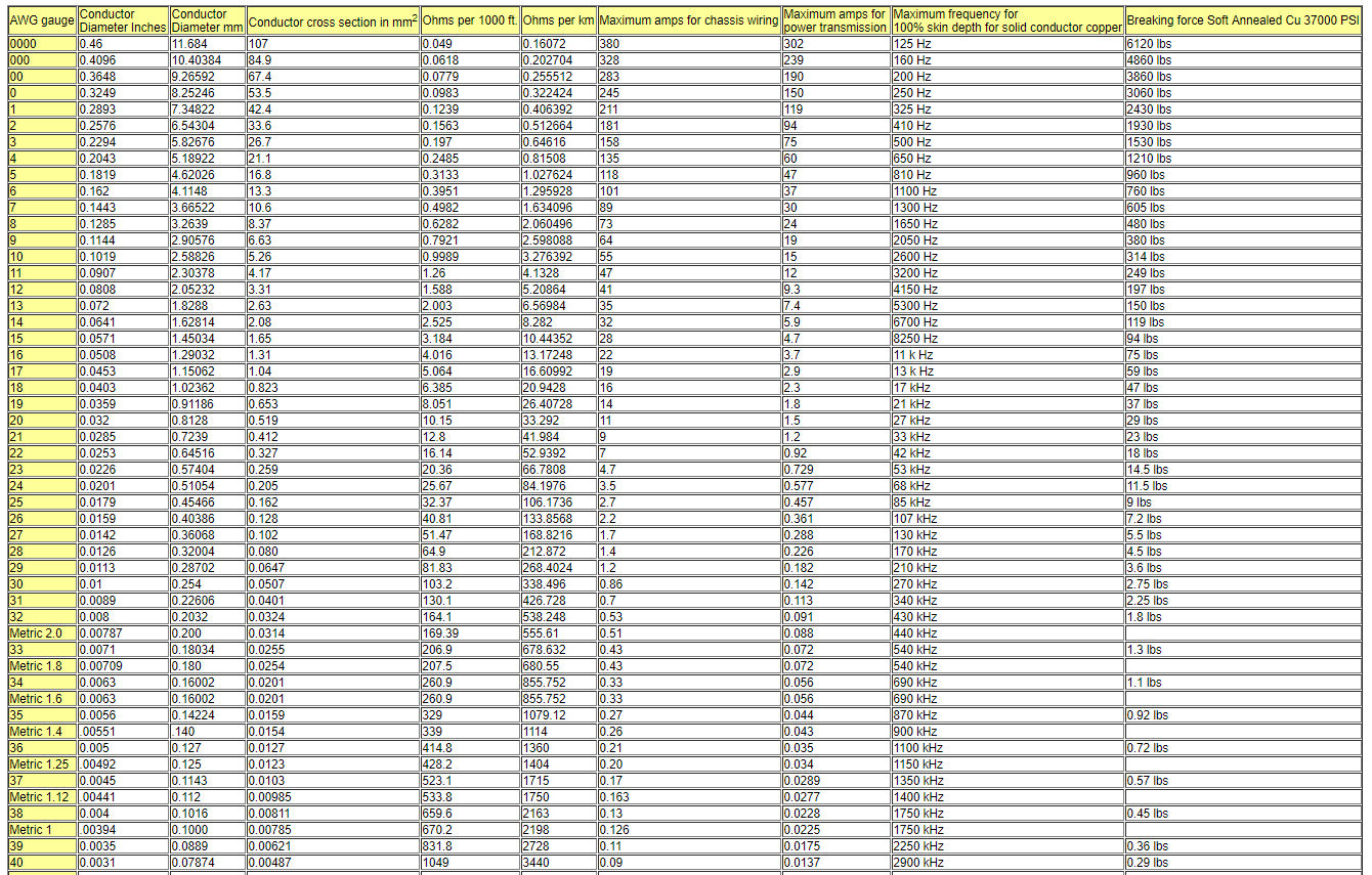

3) search fu a "Chassis wiring ampacity table". I couldn't care less if someone wants to wire their FW power rails with 2/0
too many people confuse NEC allowable ampacities as a golden rule that applies everywhere. I'll go ahead and drop that graphic here.

Based on the table I see two columns for ampacity and I'm hoping to get some clarity.
Can someone explain the nuances between the "chassis wiring" and "power transmission". Is power transmission out in the open "room", like a power cord? Does AC mains inside the chassis count as power transmission, or chassis wiring?
There's definitely a big difference in the ampacity allowance between the two columns.

Power transmission ratings are not applicable here. AC mains cables are for power transmission. There are no enforceable requirements or official published "best practices" that concern the construction of projects discussed here.
Marine wise, there's the ABYC standards which, while written in the same style as the NEC are merely unenforceable suggestions although they're widely adopted within the industry.
The chassis ampacity ratings are considered conservative and are used to size single, unbundled wires at relatively short lengths. You'll notice it's quite vague... don't trouble yourself over defining a bundle or looking for deratings tables. 3,4,5 loosely twisted conductors that aren't contained within conduit aren't a heating concern or hazard in any other sense. When in doubt calculate your voltage drop, set a reasonable threshold (5%) that you're comfortable with and have fun. Remember, the NEC is a product of the NFPA, is about life safety and applies to practically every electrified structure, wiring method and use case out there. Yachts, RVs, cars and utility service facilities excepted. Imagine, 3 12ga cables in a closed conduit, each safely carrying their full rated 30A for 150+'. The requirements are built largely around the heat produced in that environment, jacket temp and composition.
A 15" 18ga wire loosely run across an amp enclosure with 12-15A peaks looks quite reasonable
