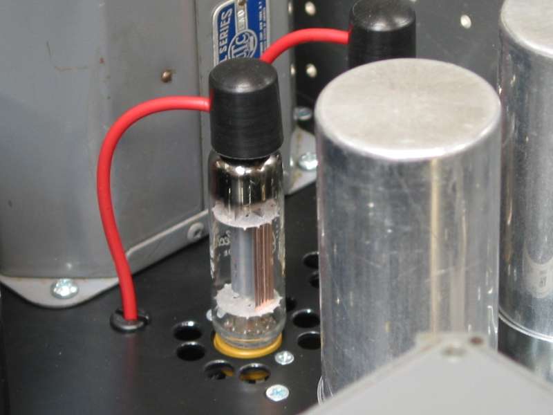

Here's my favorite method. I use test probe wire, because it's tough, flexible, and rated for pretty much any voltage I want to use. Through the chassis I use a "snub bushing" which is a 2 piece grommet that goes around the wire and pushes into a hole in the chassis, compressing and locking the wire in place.

5KV rated 18AWG (65x36) rubber insulated 90 degreeC, breakdown voltage 20,000V.

another vote for meter lead wire. Works great on my EL36/6DQ6/807 amps...
You can go punk and use a crocodile clip for the termination, but a cage is then a must have!

I too like test lead wire from Belden, #8899. It's 5KV 18 gauge rubber covered. I get it on eBay when it shows up. I also like Markel #3239 silicone covered. Very heat resistant (150ºC) and very flexible. Good to 30KV but not too thick. There is someone on eBay in China selling HV wire that appears very similar and in various sizes. I've never used it though so I can't be totally sure what it's like. Search for *high voltage* (under business and industrial) and you'll find it in short lenghts.
I use the silicone ultraflexible wire favored by model car enthusiasts. It has high temperature capability, withstands the voltage, and is available in a variety of colors (red, blue, black, and yellow). No need to use any gauge larger than 18...
