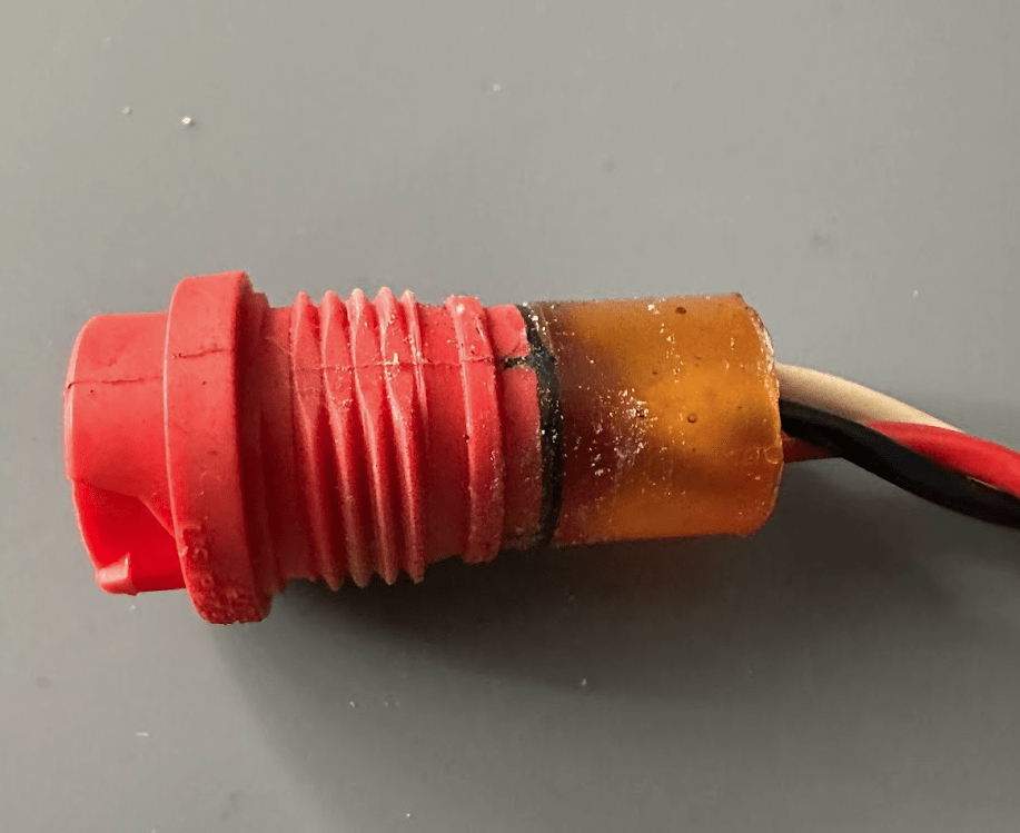

One of the connectors that connect the panel to the electronics of my Martin Logan Prodigy has failed. This is a known issue at ML but they no longer have the connector available.

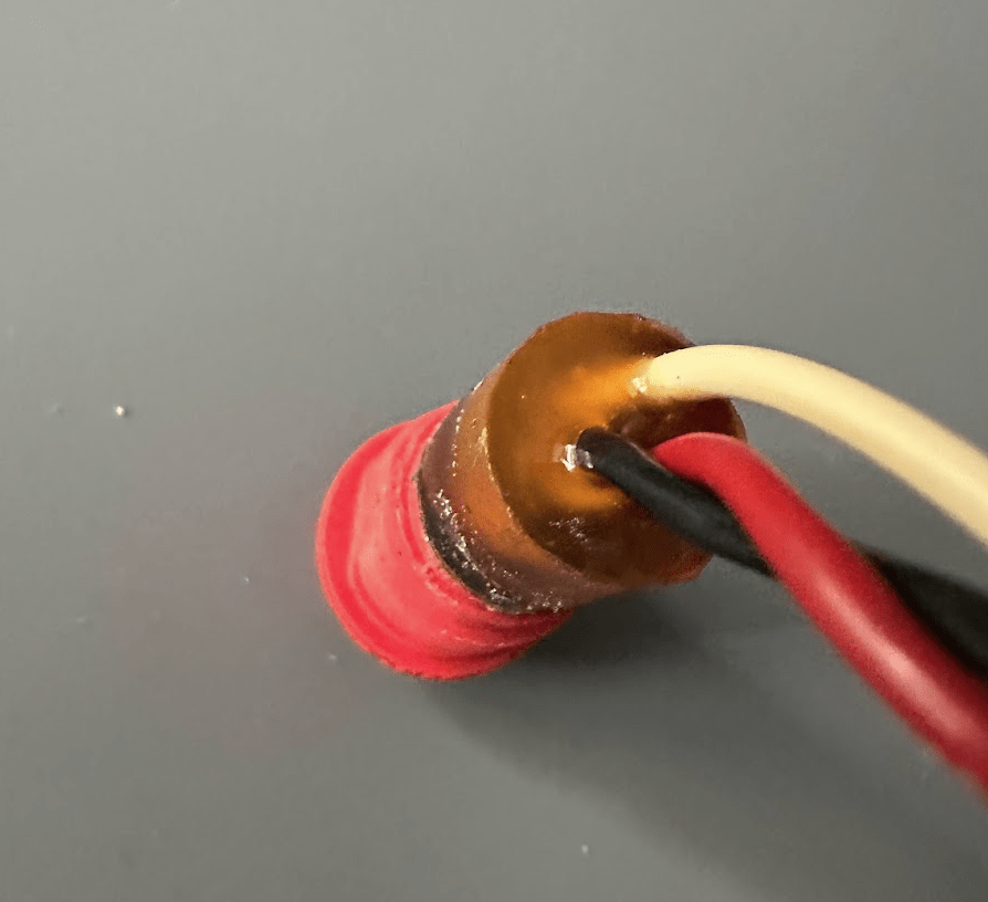

Does anyone have any ideas how I can remove that resin-like substance that the wires are embedded in? I would like to remove that to access the bare wires/connectors to fix the bad connection.
Or better yet, if anyone knows where I can get a new one that would be amazing. The connector is called Pulse-lok from Alden. Unfortunately ML says it is no longer available.
Seems like Pulse-Lok connectors are still available - https://www.amphenolalden.com/products-solutions/pulse-lok-medical-connectors.

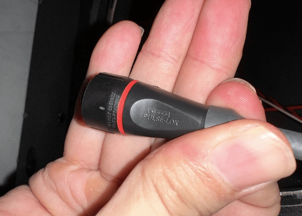

Difficult to tell from the photos which version of Pulse-Lok is being used. Is there a part number on the connector ?

Thanks for the info. I've contacted the local Pulse-lok distributor and will see if they have a replacement that will fit.
If it is hot melt glue, try an edge with a soldering iron. Should melt, with a little smoke sometimes.
And, if you have epoxy or car paint thinner, use a match head size piece of cotton on a tweezers, soak in fluid, touch the mass, might dissolve it.

Of course, use a heated soldering iron, a cigarette lighter or match stick is also quite suitable.
Then you can soften it, and cut it with a sharp blade, like those in the break off type utility knives, quite easy, safe for the insulation as well.
It looks like old hot melt or potting compound, the latter is usually epoxy with talcum powder in it for reduced cost and extra rigidity.

Agreed, solvents for epoxy will destroy the wire as well.
They are usually very strongly acidic or alkali compounds, of a strength that will burn skin on contact, you have to be highly trained in order to use them, and those usually dissolve metal.
Best is to cut the wires, put new connectors, of a currently available type.
Red plastic looks faded and degraded to me, might be brittle with age and heat.
So the repair effort may not give durable results.

Thats a high voltage connection. It needs to handle 5KV or more. Thats why its potted. It may be potted with Silicone. There are other high voltage connectors that you could use. I doubt you will find a direct mate from a different vendor so you would need to change both ends. There are high voltage connectors but nothing that resembles yours. Many of their connectors are custom and one-off which is probably why Martin-Logan says they aren't available.

If it is epoxy, then you can cut it away in slices using a scalpel. If it is polyurethane resin, then there will be a temperature where it will start to soften, so a hair drier can be used. On no account put it in a microwave.

Methylene chloride dissolves epoxi, dangerous stuff,
but can you not just cut it off and replace with a new connector?

Cured epoxy will withstand burning, so it is best to either cut it off, or dive in with mechanical means (and inhale epoxy dust in small amounts).
IIRC methylene chloride is a car paint thinner, worth a try as an epoxy solvent.
Be careful, it is volatile and inflammable.
OP is quiet, I would change the connectors and wires with what is readily available today, rather than buy an expensive obsolete product.
