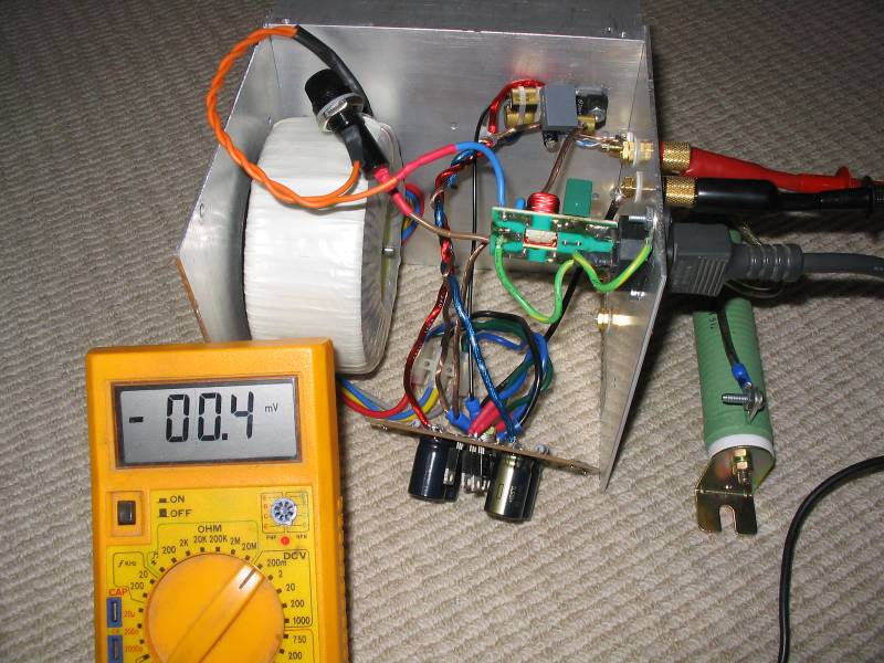

Well it passed the smoke test 😉
I've just powered it up and checked the dc offset on the output. 0.4mV!! is that too good to be true??? hoping that there isn't anything wrong :xeye:
That is with an 8 ohm dummy load connected and no input connected.
Tony.

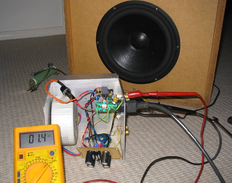

Thanks inguz 🙂
with shorted input the DC offset is 1.4mV 🙂 can't complain about that! 😎
also I hooked up one of my 3 ways (which has speaker protection) and it sounds very nice indeed 🙂 I've only got 1000uF per rail per channel, but to me it isn't lacking bass at all.
I cranked it, and I think it was starting to clip on the transients, got a bit harsh sounding.... but the ps was staying pretty steady. dropped from 27.6V to about 26.8V (though I guess my DMM might have to slow a sampling rate to see what is really happening 🙂
all in all very happy, now I just have to do the other channel and finish up the chassis properly as it is a bit of a death trap as is 😉
also this heatsink is way overkill 😉 played for 30 minutes on a bit higher than normal listening level and the chip didn't even get warm, and I don't even have any thermal grease on it yet! no switch on or turn off clicks or thumps either (especially surprising since at the moment the switch consists of pulling the plug out of the socket 😉

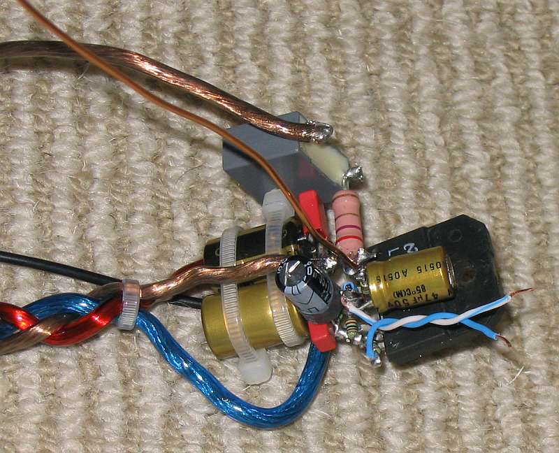

Hi Vikash,
I used the BrianGT LM3886 one (which is basically pretty close to the datasheet), I think the differences are the inclusion of the 22k resistor on input, slight differences in the NFB resistors and the increase to 47uF of the NFB cap)... I had already decided to go with 47uF on the nfb cap and decided to go with Brians other changes as the kit gets a good rap 🙂
I have the star point in the middle of my power supply board. It is common to both channels, so I guess I won't know if it has worked properly till I make the other channel 😉 ( the PS actually has separate rectifiers and cap banks for each channel but a single ground running down the middle...... did I post a pic of the PS earlier?? edit: don't have one, will have to take a better one with the bolt and bleed resistors installed... here is a post with the ps board ---> http://www.diyaudio.com/forums/showthread.php?postid=745654#post745654 before installing star point bolt... this was testing one side just in case I stuffed something up I didn't want to blow all my diodes or caps 😉
First thing on the star point is the transformer (center tap)* return, followed by the speaker return. Then I have the local power ground return, then the compensation cap return and finally the signal ground return. I'll elaborate below on the various local star points.

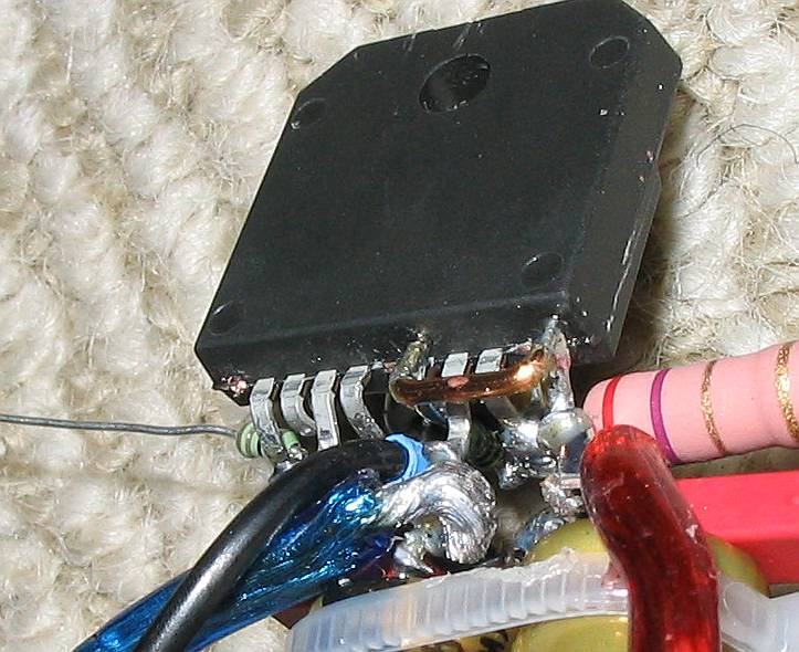

On the chip, I connected the +ve and negative leads of the two filter caps and also connected the mute caps earth connection at that point this made one local power star. That has one lead running back to the ps central star point. (Braided with the +ve and -ve rail wires).
I have a separate wire running back from the ground lead of the output compensation cap to the main star. I decided to do this based on the information in the datasheet.
I decided to use pin 7 as the local star point for the signal ground. It has the ground connection from the 22k input resistor, the ground connection of the NFB cap, and the ground from the input rca. The thin black wire is the run back to the PS star point.
This is my first try at star grounding, so I hope it is all still working properly when I hook up the other channel!! Pay to wait and see I think 😉
Tony.
* I know it is not a center tap since it is a dual secondary toroidal, but I don't know the correct term in that instance.

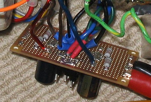

Vikash, here is a closeup of the PS (best pic I could find on the camera) not at home right now.... I thought I had a better one, but maybe I didn't take it.
Tony.
