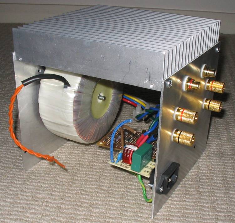

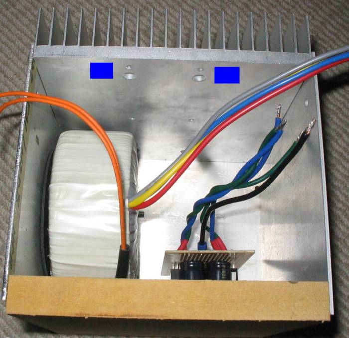

OK so I have just whipped up a dodgy chassis for it (first try at doing my own chassis, and this is only a test amp, so don't be too harsh.... the way it is going it'll probably end up in the ugly amp thread anyway 😉 ).... It's going to be relatively compact and I'm wondering about the orientation of the torroidal (its a 300VA one).
I've taken a pic of where I think I'll mount it ( the box is sitting on it's front in the pic)
The blue rectangles represent where the LM3886's (I'm doing it p2p) will be (the other option is to use a shortened version of the heat spreader that came with the sink and they will then be in roughly the same place but hanging down....
Now I read that torroids radiate pretty much in a narrow band straight through the center so I'm thinking that this orientation should be ok.... any cautions?
The main thing I don't like about this orientation is that it will not be symetrical ie the toroid is closer to one chip than the other, my original thought was to mount the torroid vertically on the front wall smack bang in the center.
I'm not worried about the asthetics as this amp will be used as a test bench amp 🙂

If you're building P2P, you might want to leave yourself a *lot* of space around the chips. Repairs & adjustments are much trickier when you can't just lift up a PCB. So I'd consider putting the trafo on the base or behind the front panel.
Thanks inguz
behind the front panel will certainly leave a lot more room around the chips, and also has the advantage that then both sides can be removed.... so that is probably a better bet. I'm a little paranoid about transformer induced noise as I have had problems with my other amp with this.
The base (as a mount point) is a bit tricky in that it makes it harder to mount my PS board because the base actually has the smallest dimentions (because I decided to put the heat sink on top) and the ps board wont fit beside the toroid!

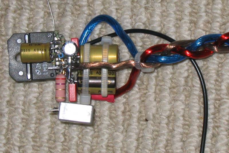

Keep going Tony, I'm a following 😉 Here's my LM3886 P2P work for some more data, and : Mark's intricate LM4780 work is inspiring.
Thnaks Vikash 🙂 I hadn't seen either yours or Marks 🙂, I've been trying to see as many as possible to give me inspiration 🙂 I'm trying to get it as compact (around the chip) as I can without going crazy 😉
Decided to have three earth returns..... one is the PS bypass caps and the mute cap. One is the NFB, chip ground, and signal grounds, and the other is the output compensation, the speakers will also have their own runs.

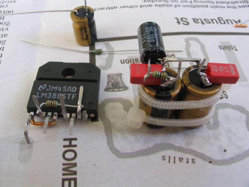

I've made some more progress, but when I checked my camera I don't have the latest pic (at GF's place now), I've attached the latest pic I took which has the rest of the FB components on the chip, I now have the input resistors and signal ground return wire too. only think left to do (for the first channel) is to put the output comp resistor and cap on, and solder the bypass caps and mute circuit to the chip 🙂
please excuse the poor quality and angle of this pic 😉
Tony.

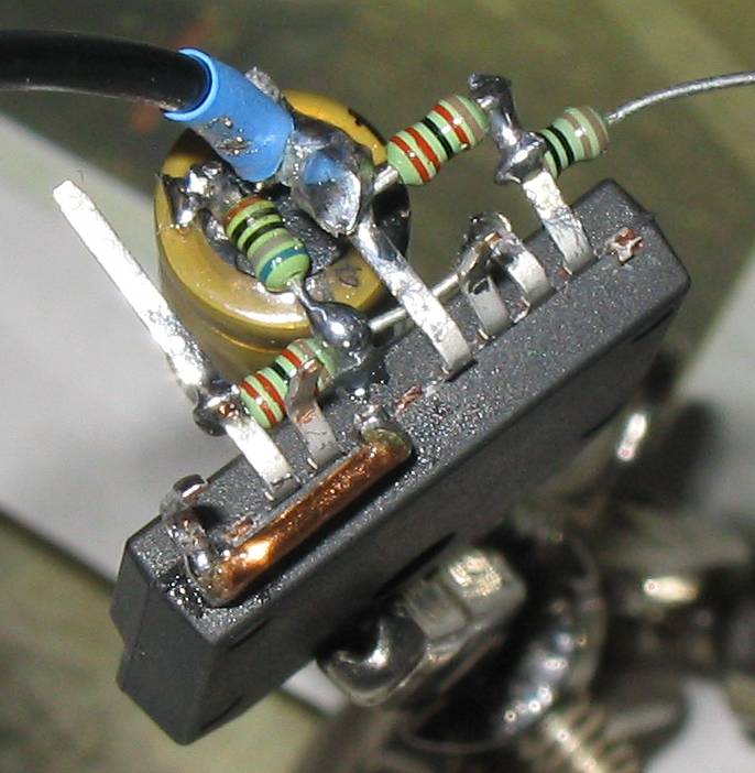

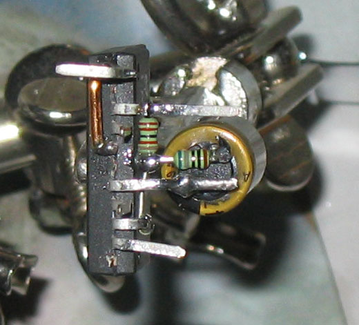

OK another status pic..... If I keep this up I might actually finish it 😉
this one with input resistors and signal earth wire attached. Its amazing what you see when you take a closeup 😉 looks much more horible than it does to the naked eye 😉 I think I need to stop shrinking the heat shrink with the soldering iron tip too
Tony.

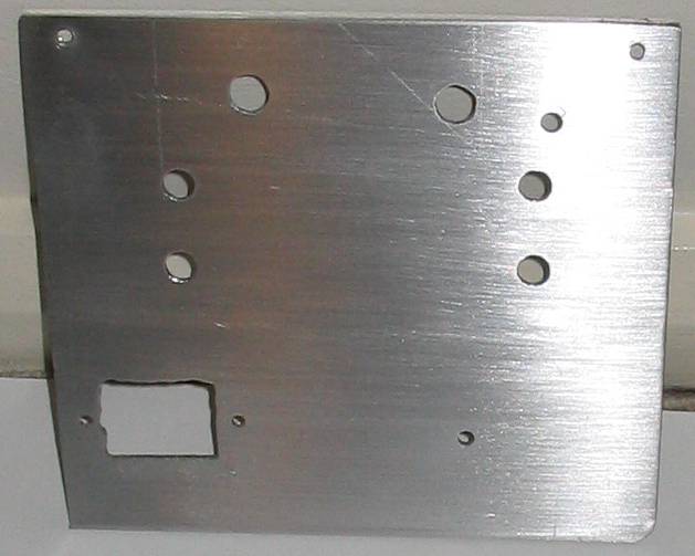

well I decided to do the rear panel...... holes went well except one where I don't think I centre punched deep enough and the bit must have slipped.... so one input socket is a bit wonky.....
but the real problem was with the hole for the power plug.... I got half way and my cheap nibbling tool decided that it had had enough of cutting 2mm aluminium and went on strike.... me being foolish and not thinking about it a little more carefully decided that the tungsten carbide cutting bit along with the mild steel case from the PC power supply that I got the connector out of would be real easy..... use the pc case as a template and just run around it..... hmmmm bad idea 🙄 If I had have thought a bit longer I could have used my jig saw, or if I was really desperate chain drilled it, but I let speed seduce me and well now there is some extra ventilation around the power plug 😉
Only other problem is that my fuse needs a 15mm hole and I don't have any drill bits that big!!
Oh well soldier on.....
oh and by the way there are some extra holes and a rounded off corner because this was a scrap piece of aluminium I had.....
Tony.

Here is another pic. It's starting to look like an amplifier now!! though after my gaf with the power socket hole, I'm feeling a bit hesitant about doing the switch hole!!! it's only a small one though, 13mm X 18mm, so maybe I should try chain drilling and filing it.....
man I wish I had some decent metalworking tools 😉 I have my battery operated drill, a jig saw and the dremel (and a now defunct nibbling tool).... a drill press would be very nice. I was reading Vikashes case thread earlier, came across it when I did a search on finishing aluminium. I'm so jealous of all your equipment Vikash!!! I've always wanted a lathe, and you have lots of other goodies too 🙂
anyway time for me to head for bed I think.
Tony.

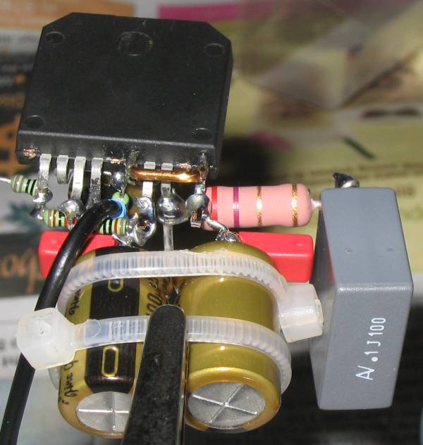

OK just attached the power leads..... I think this has been the hardest soldering job so far!!! I always dread soldering power leads on though
once again the camera doesn't hide any flaws 😉 and it also flattens the perspective making everything look like it is shorting together!! I think the closest gap between anything is at least 2mm, hopefully won't have any problems!
Tony.
