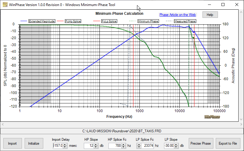

To design, you will have to generate phase. You can use my WinPhase app for the frd files, but I didn't write it to work for zma. Looks like I need to create one for impedance files since they'll need slightly different ways to set up the magnitude curve. There are other apps or Excel spreadsheets (maybe one of Jeff's) to do that. I've never looked into that, I always have measured data files.
When you generate phase for the tweeter file (TN101.frd) use 210Hz for the highpass, that will eliminate the bad data below that point. I think that the (midrange?) file 10fe330 FRD-png.frd should have highpass at about 27Hz. The woofer file WSN041.frd may be best at 60Hz highpass, but the default is very close, so for crossover design either one will do.
For the frd lowpass in all three you have no measured phase to try to approximate that when generating phase, so you'll probably be best using the defaults.

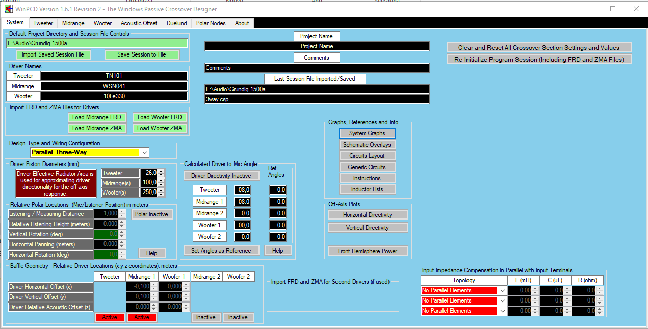

I made a check with the files generated with Vituix Cad..and following your suggestions as well...but not graphs..
I was trying moving the slider...but nothing there..
Should i change setting on my windows?
I will try to get some frd files from other sources to make a cross check.
Why the tweeter frd load disappeared..?

I've never seen a control on a form disappear like that for a the tweeter or any other control that isn't specifically coded to do that. When you change from a 3-way to a 2-way the midrange controls are hidden on the System tab, but never the tweeter. The code never changes any tweeter control on the main form so I have no idea how that would have disappeared. If you can supply the files for this test you made maybe I can see what might do that, but I know that it's not built into the code. If there was some kind of bug in the forms code, it would help to see what the Tweeter tab looks like. But I can't do anything without the files you imported.

Hello Dave.
I found the issue, and was related to Windows. As i changed the decimal separator from comma to period it started to work.
So finally the graphs are not empty anymore.
