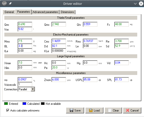

😉 Nail on the head but hang on. I take it that if I click on the edit button on the main screen and select parameters those relate to the speaker? Pe - not mentioned on the speaker data sheet what is it?
Anyway parameters shows all fields as blanks - or does now. The X max etc did work correctly when I noticed the adding a resistor effects and and spl still does with and without the resistor. Xmax is now blank. It did show the red line.
I set it all up following a tutorial that points out the order the speaker parameters have to be entered so that it calculates some correctly itself. Changing the box volume and tuning the port took several reloads of the project and saves. Vent velocity ok etc and then looked at Xmax. 🙁 It will need a subsonic filter. Then added the resistor. Still ok until Xmax went awol with a higher value R. A a quit andreload did work but doesn't now.
I'm running it under wine on Linux and have also used a different project directory than the default one. It's been set up like that right from the start.
I assume I can re enter the speaker parameters via the edit function but have to wonder how they disappeared or if they ever got there. I used start a new project initially.
Within an existing project: the driver, edit function creates a version of the driver parameters unique to that project only. If you create a new project using the same driver you won’t see the changed parameters. To permanently change a driver’s parameters I use the driver editor (the little loudspeaker in the menu bar or Alt-D in Windows). Load the driver, change the parameter(s) and save it. All new projects using the driver will have the updated parameters.

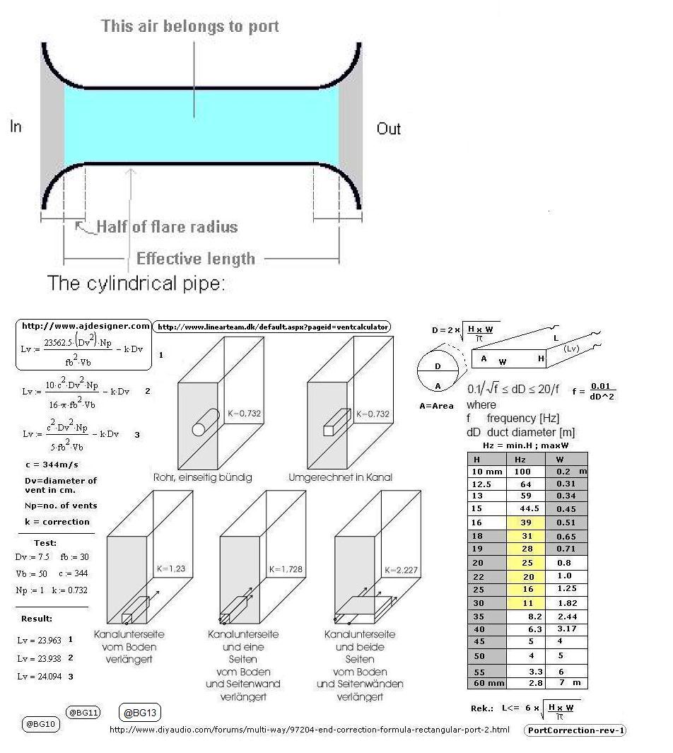

One for any package where the port is adjusted. I would be using an essentially square port rather than a slot. No flare. Should this use a specific end correction factor? To me that sounds as if it will be a better option than a rather elongated slot but may be wrong.

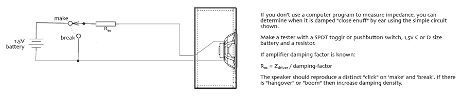

0.7 resolved many 'issues', but for serious/most accurate (freeware) designing, best to use Hornresp and yes, sometimes need tweaking 'in situ', especially WRT vent tuning, though most times using the pioneer's 'click' test to critically damp it is sufficient.
Convert square to round i.d. to find its basic end correction. Attached is currently the most accurate port chart.

Odd thing about the driver editor. It lacks a button that would be marked use. All it can do is save so a new project is needed to set the data. Ok now I know I can load a selected speaker via that.

Bit misleading. What I meant is it's not possible to see the speaker data that is being used other than by loading it again and cancelling.
I've been following a tutorial by midwest audio. It mentions that on 0.5.. the provided speaker database files can be deleted. 😉 0.7... isn't happy about that. The tutorial states a certain order to enter the data. Looks like that is needed and appeared to be ok with the data order given by Dayton. Maybe not with Visaton. Visaton don't state Vas so I assumed that Mms and BL had to be entered. That caused Vas to be calculated. The display maybe not as clear as 0.5.....
The html help file also states an order for entry
The suggested procedure for entering driver parameters is following (check first that "Auto calculate unknowns" option is checked):
1. Enter Mms and Cms
This gives fs. If either is not available, then enter fs and other parameter.
2. Enter Sd, Bl and Re
Now, you should get all but Qms (and Qts), Vas. Please note that Vas may not match exactly what is specified by manufacturer, because exact value of Vas depends on environmental parameters. See FAQ. 3. Enter Rms or Qms.
Either one will do, although I tend to prefer Qms over Rms, because it can usually be measured in driver measurement procedures.
4. Enter Hc, Hg and Pe.
If Hc or Hg or either is available, then enter Xmax and optionally either Hc or Hg if available.
5. Enter number of voicecoils.
This procedure is most accurate. Also note that it also calculates true SPL (1W/1m) value. So it might not match the marketing SPL value, which is generally somewhat vague. Not in all cases, though.
