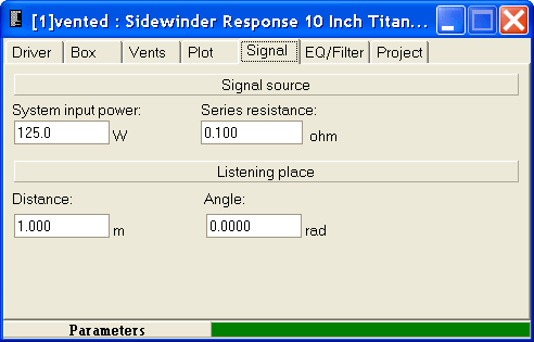

The specs you list show sensitivity of 89dB for one watt (2volts in to a nominal four ohms)The problem is, WinISD is giving the SPL as 116db, when it is 93db.
or 92dB for 2 watts (2.83volts in to four ohms).
Sounds like 180 (WattsRMS) or 540(WattsPeak) may be entered into the "System input power" input.
This screen shows 125W entered, ~+21 dB over 1 watt.

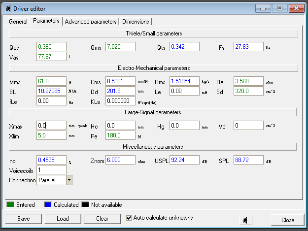

Only entering electrical and mechanical Q ( Qes , Qms )
The calculated total driver Q ( Qts) = .342
Which is close match to data sheet .35
they magically rounded it up.
Huge surprise ,... not really
Be more interesting to see if the fudged BL
So entering MMS , Re and Sd only
cross calculation for BL is 10.27
which is close to datasheet 10.2
So as far as small signal and electrical mechanical data.
Datasheet has no major errors.
No inductance listed so transfer function
wont show high end roll off.
I dont enter Fs I cross calculate it to see if manufacture
is lying or not. With shown magnet force and Sd
Fs is 27 Hz not 30 Hz
So likely rounded up the mass or magnet force
to make it seem slightly more special.
Good enough for a basic alignment.

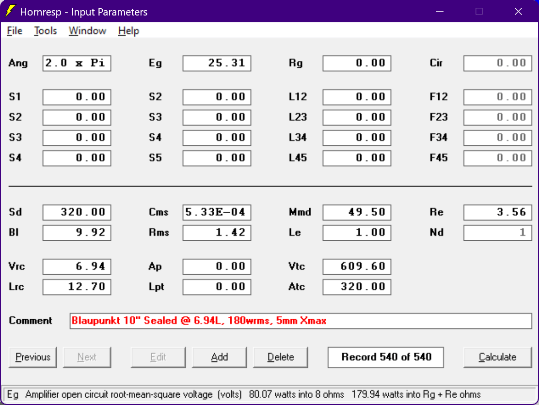

No, HR calcs ~88.1313 dB/4 ohms/w/m mid band sens. Vs published 89 dB/w/mHere are the drive's specs. Any look seriously off?
Ditto Cms 5.33 Vs 5.4, 9.92 Vs 10.2 Bl and guesstimate HR's 49.5g Mmd Vs 61g Mms (air mass load added)

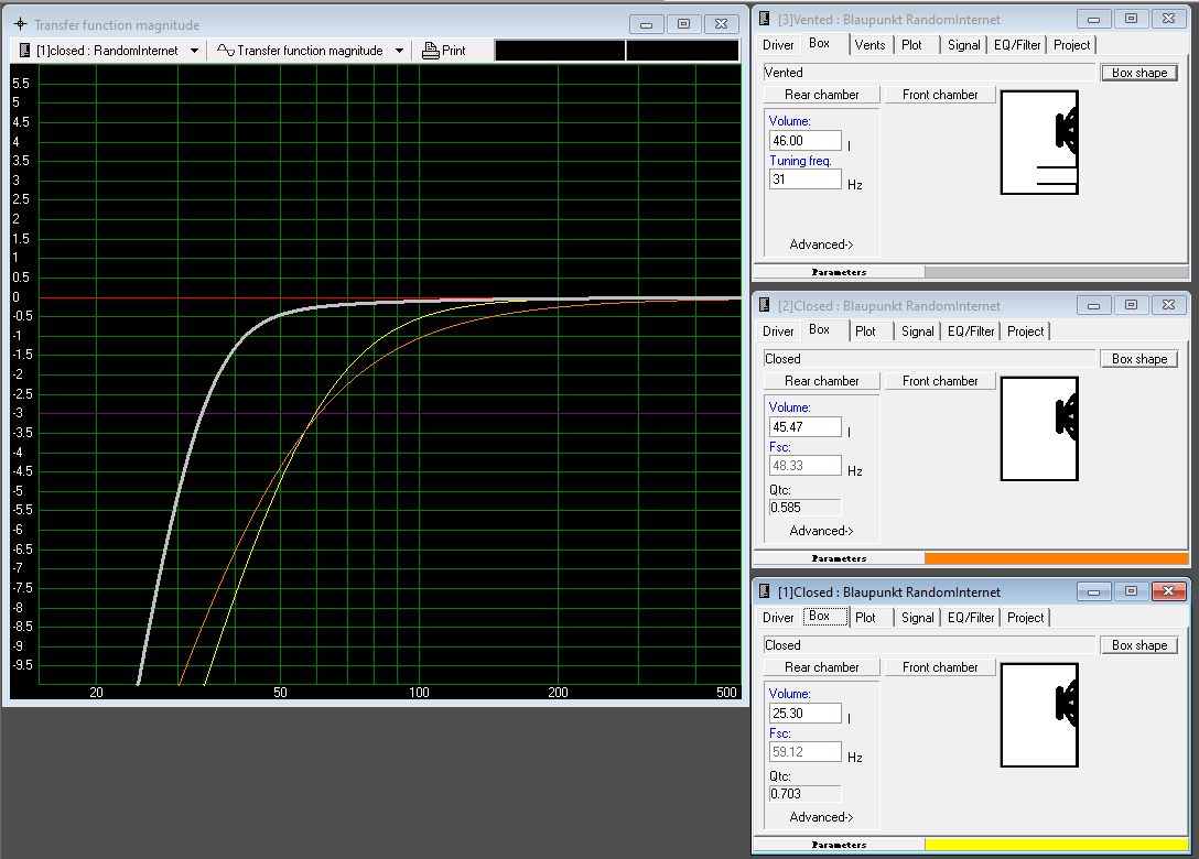

Qts is around .3
Vas 77 liters
Should instantly tell you about what your looking at.
Running numbers looks like my wild guessing

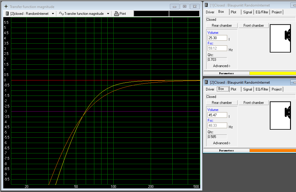

was close .577 Qtc = 46 liters .707 = 25 liters
Normal everyday butterworth will be just that
46 liters tune 3 Hz above or below Fs to get the alignment.
Here is closed Qtc
.5 = 46 liters
.7= 25 liters
No other magic nonsense to it.
Your either 3 to 6 Hz above or below Fs.
Im happy if butterworth ends up being below Fs
and will ditch the woofer if it has to go more than 3 Hz above it.
To get a alignment.
And there you go, 1 or 2 Hz above Fs
A normal everyday butterworth in 46 liters
all done

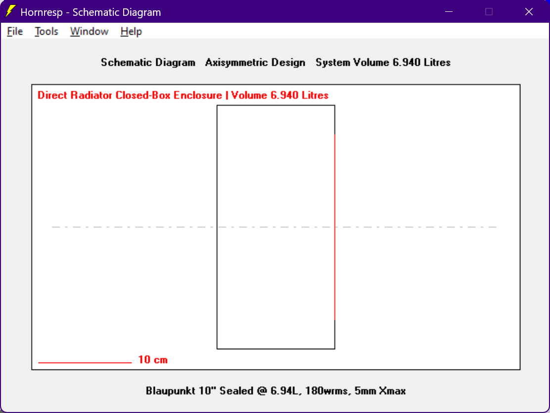

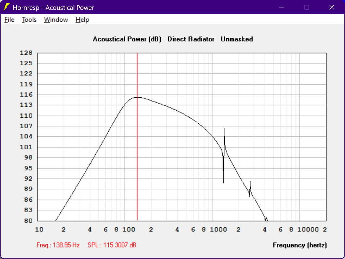

Blaupunkt is recommending enclosure sizes that pushes the driver past the 5mm Xmax at the stated 180 watts rms.
