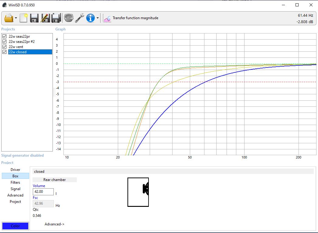

I have done some initial modelling in WinISD with the following driver and passive radiator -
Scan Speak 22W857 - https://www.scan-speak.dk/datasheet/pdf/22w-8857t00.pdf
Seas SP22R - http://www.seas.no/images/stories/prestige/pdfdatasheet/h9945_sp22r_datasheet.pdf
The box is 42l.
I have modeled a closed box, Qtc = 0.55
Vented with a 7.5cm diam vent, 29.5cm long, tuning freq 30hz
Single PR with 50g of extra mass
Double PR with both having 70g of extra mass
I have added a 25hz 2nd order Butterworth high pass filter to restrict low frequency excursion.

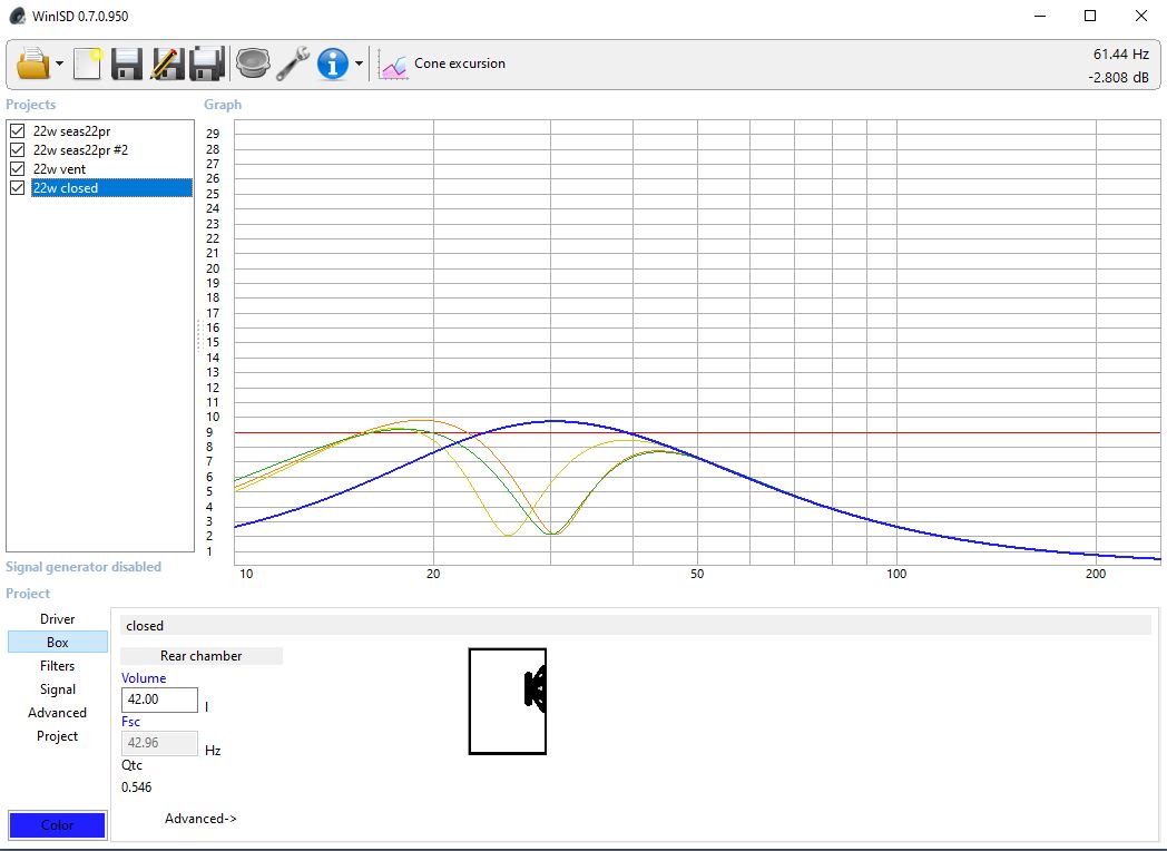

For a 60W max power (the max of my amps) -
Cone excursion is within Xmax (9mm).

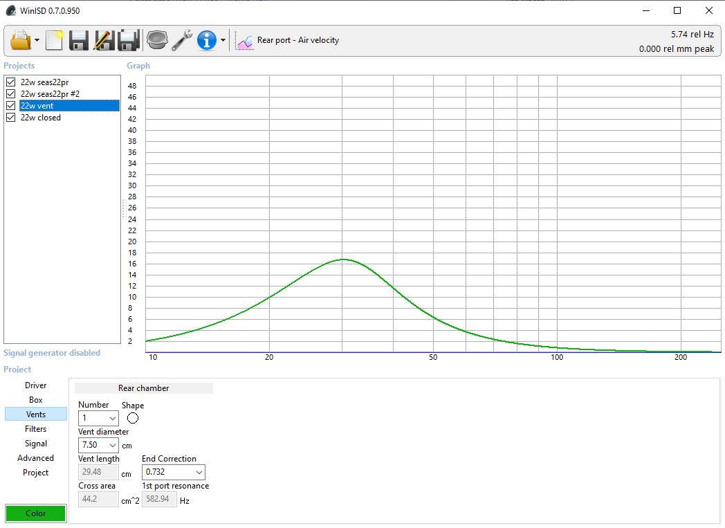

In the vented case air velocity is 17m/s.

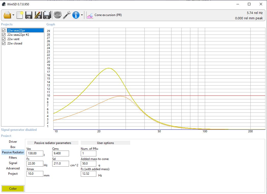

Now, the question is, I would like to use a Passive radiator (I actually like the sound of speakers with them) but with just one PR the PR excursion is - 18mm which I think it too high (I need to reduce the watts to 20w to bring it down to 10mm, half quoted P-P). With the dual PR it is all OK.
So, is my assumption right that PR xmax in WinISD is half quoted P-P max excursion on data sheets. If so I will have to run two PRs which gives the same frequency response as vented so no real point doing it. One PR give a more gentle tail off and lower F10 which is preferable but has high PR excursion.

Plots attached. Blue = closed, Green = vented, Yellow = single PR and Red = double PR.

Optimal solution to your case is a vented cabinet that gives you great bass capabilities at reasonable cone movement, especially having a 25Hz BW high pass. PR presents unnecessary expense at no benefit, very restricted in PR movements at higher power input.
@lojzek, I think I came to the same conclusion but good to have your confirmation, I do like PR and I have a difficult room to work with (almost square with lowish ceiling), but vented does look the best option.
