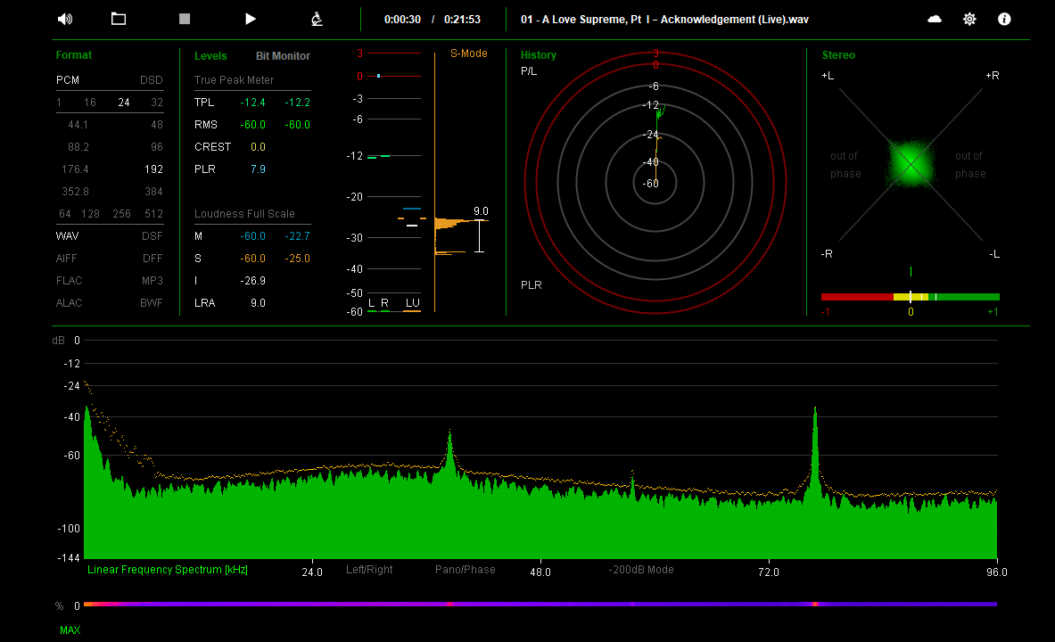

I found an old demo version of MusicScope, which looks like it was a great program. Oh well, the company closed its doors last year and their free 2.1.0 version is nowhere to be found. But the demo version 2.0.7 has enough functionality for me to capture this:
As you can see on the left side of the graph, most of the recorded information is centered around 400Hz. That makes sense.
What's alarming are the three ultrasonic spikes, which can't have anything to do with musical information.
The lowest one is at 38.4kHz and is at -49dB level. The next one up (to the right) is at 57.6kHz and is at about -70dB. Then there's the big whopper of a spike at 76.9kHz and is down only -34dB.

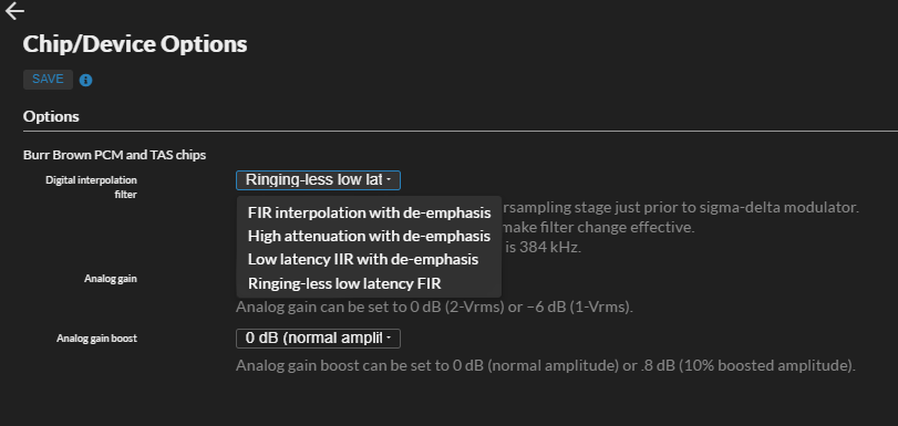

Is this ultrasonic noise generated by noise shaping? Or is that quantization noise recorded into the track? Does the DAC filter that out? (I suspect it does, with all those FIR choices I see in the PCM5322 chipset options in Moode Audio.
With all these whistling oscillations going on, and the switching frequencies of all my wall warts and class D amps, not to mention the clock frequencies of my laptop and my Raspberry Pi, there must be a lot of ultrasonic energy bouncing around my living room.

Hello.
I read on your graphs that the music file you tested is Coltrane's "A Love Supreme".
It must have been recorded on tape.
Though I am not versed in analogue recording techniques, I wonder if the suspect 38.4 and 76.9 kHz tones you have observed are not simply the tape bias signal or related to it.
