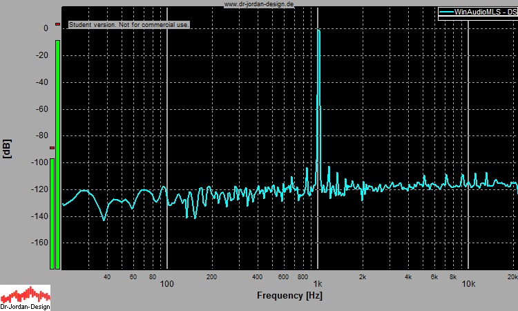

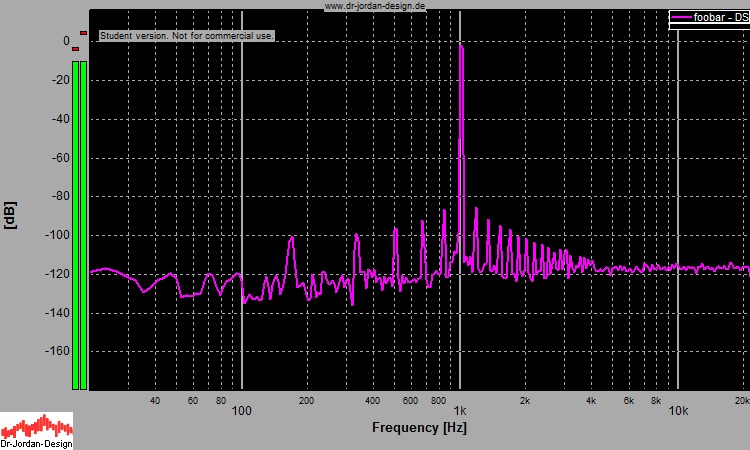

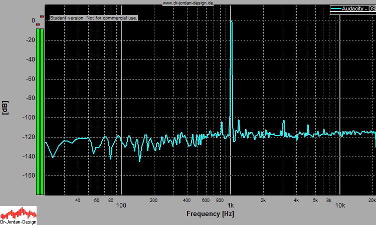

I just found that the data associated with directsound are not correct due to incorrect mixer volume setting.
Please ignore post #20 above. I double checked.

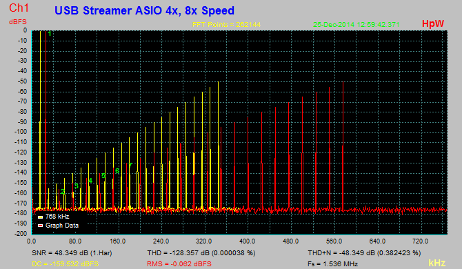

After I set USBStreamer to 48 k and 24 bits in control panel, I got new FFT plots for directsound. The default setting was 44.1k and 16 bit. Sample rate conversion (SRC) involved in the above data since source setting was 48 k.

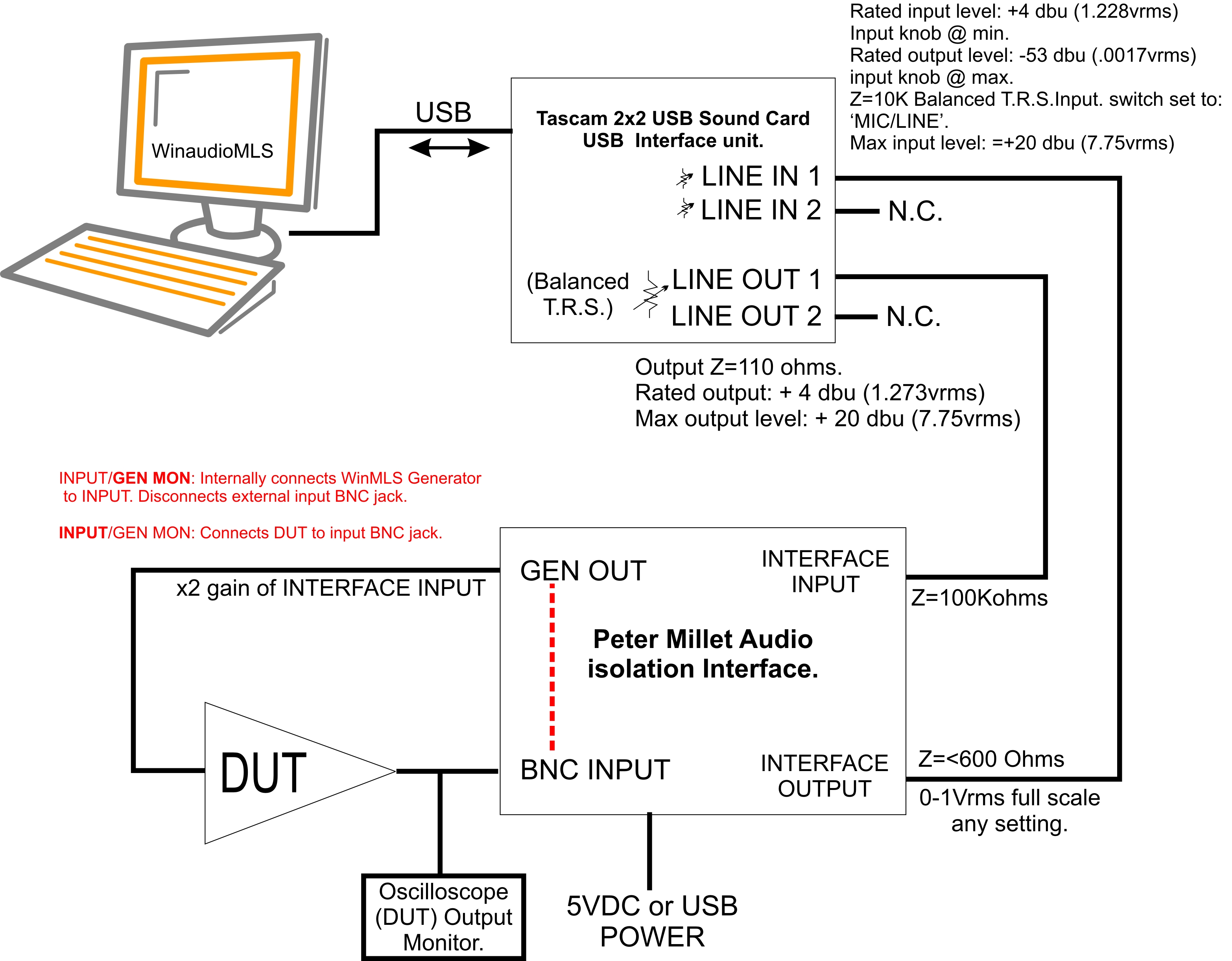

Well It's been a few months now since I last posted. I went ahead and committed to Winaudio MLS from Dr. Frank Jordan. It seems to have a software bug pop up once in awhile where the sig gen GUI interacts with the main software. I'll have to email them about that.
Additionally, I purchased Peter Millet's interface box with this.
The sound card I committed to, was the Tascam USB 2x2, which is a pretty decent unit.
Lookin' good so far, but having a heck of a time marrying all this together. I blew out one of the op-amps on the test interface by probably a ground issue, so gotta get that fixed.
Does anyone have experience using this software with Mr. Millets interface box, that may be able to assist? I have several questions.
