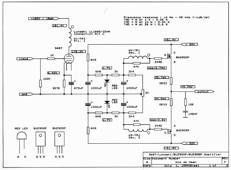

I need some assistance regarding too much DC on the output of this amp (300 mV). I would appreciate any input in troubleshooting this issue. Scematic is attached. Thanks😕
