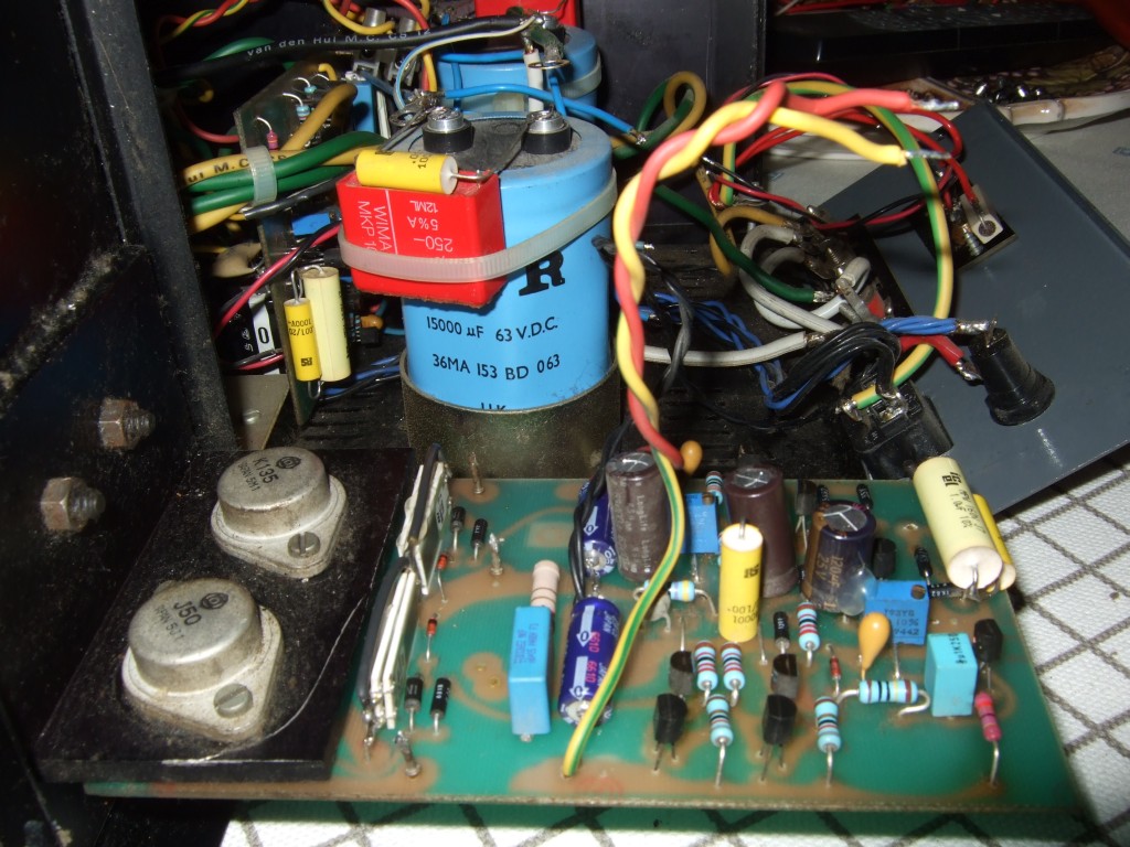

I had MKP 10 over 15.000uF LCR PSU caps in my old lateral Mosfet JLH 100W amp. When I made a restoration, I pulled them out and the amp became subjectively more coherent in the treble, by a good margin. Andrew is right, we must know we don't upset an amp that has been designed with lossy filter caps when making additions.
