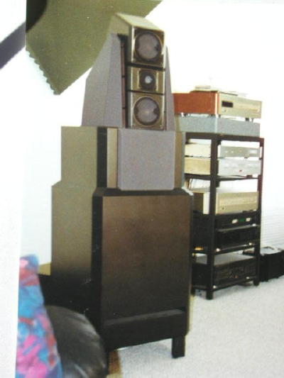

I was so impressed with Wilson Grand Slamm speakers when they came out that I built my own version. However after using them for 2 years I switched to open baffle design and didn't change anything since then.

Hi HPotter,
WOOOOOW............!!!
These look better than the orginal. A friend of mine has the original X1 but all middriversurrounds were rotten due to the harsh tropical climat; oversea.
We resurrounded the cones but I am still not sure it is right. Did you know these middriverss are very firmly glued to the cabinet?Almost impossible to replace. What kind of drivers are you using?🙂

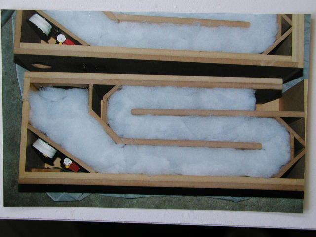

Here is another try at copying other famous design. Tweeter is original B&W, Accuton midrange and Cabasse woofer in transmision line enclosure. All the walls are 1.5" mdf, midrange inclosure filled with sand, separate crossover boxes. I always liked those speakers in Black&White.
