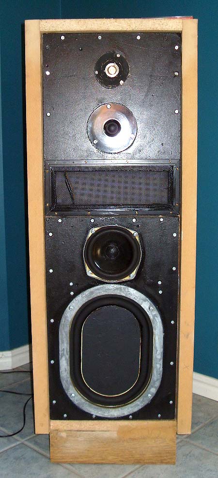

Wilmslow Audio TL12/Prestige problem
Volt RV3863 bass (8 ohm)
Volt VM752 mid (8 ohm)
Scanspeak D2904/710003 treble (4 ohm)
The Volts were easy to match but it took a lot of trail and error to get the Scanspeak to integrate. Ultimately I rolled it off from about 4.5k at 2dB/octave and matched it with a series resistor. Finally, they were raised by 12cm on custom spiked stands.
I have never heard more accurate, realistic or uncoloured speakers at any price and that includes electrostatics.

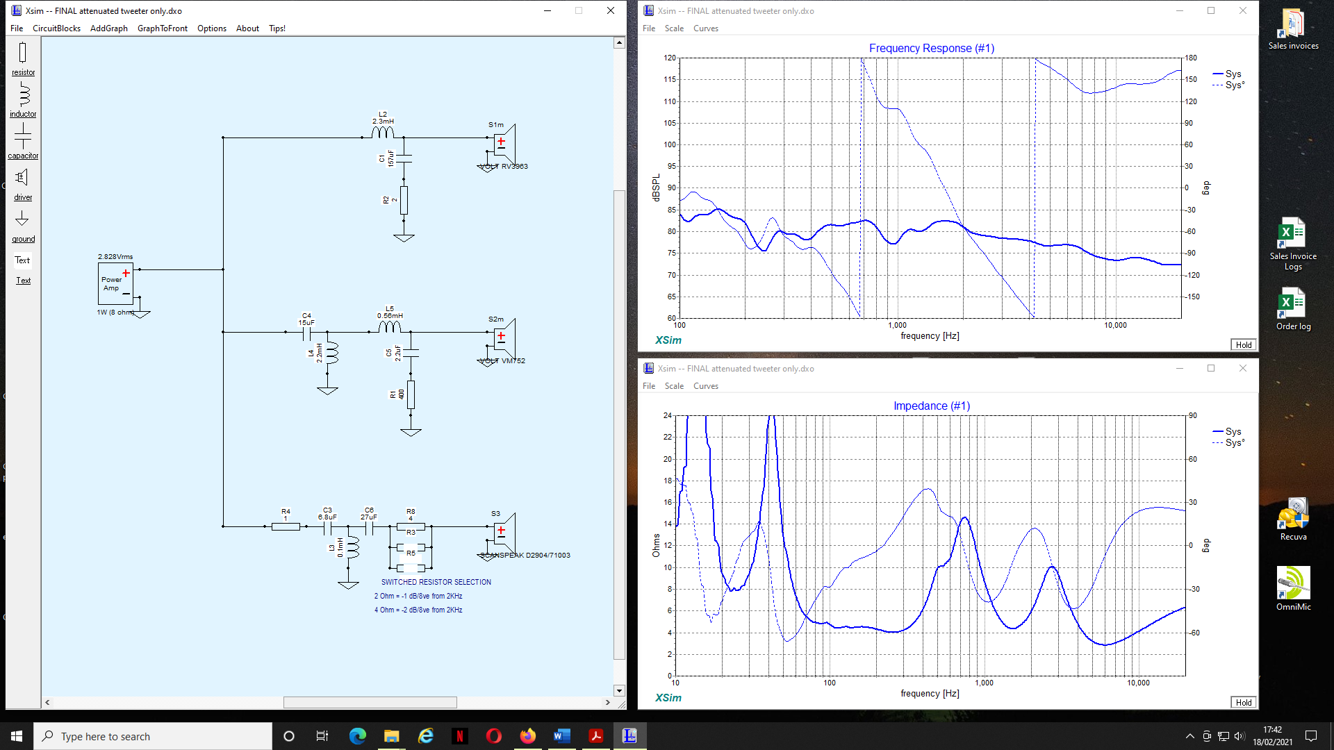

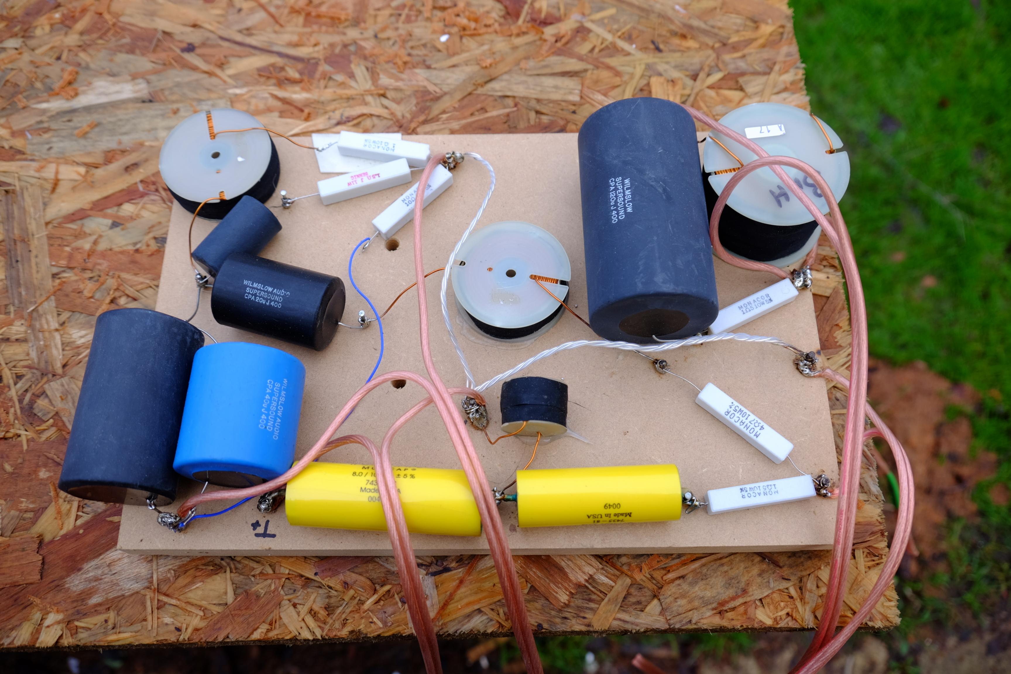

I've uploaded the XSim page. I wouldn't recommend trying to adapt the WA crossover. Better to start afresh. Get XSim (it's free), buy Omnimic, connect up to laptop, play the CD sweep tracks
and take readings for all three drivers individually (installed in the cabinet). Create FRD and ZMA files, load them into XSim and play around with the circuit until you find a good setup. It's really easy and intuitive.

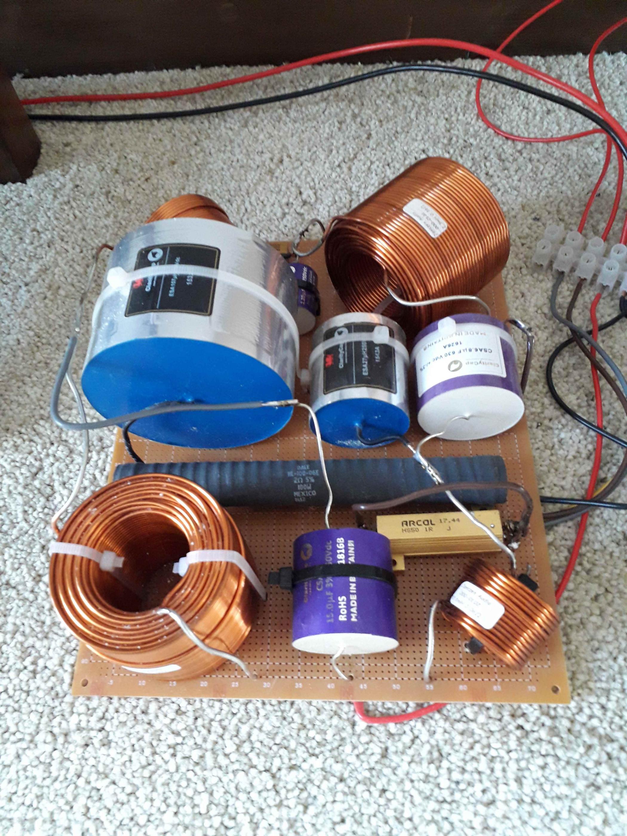

If it helps here is the crossover before the final tweaks. I have boxed it separately from the cabinet because (1) I can make changes easily and (2) it can advesely affect air flow in the line.

Thank you everyone, that is very helpful indeed. And CD94's circuit diagram looks like a very good starting point.

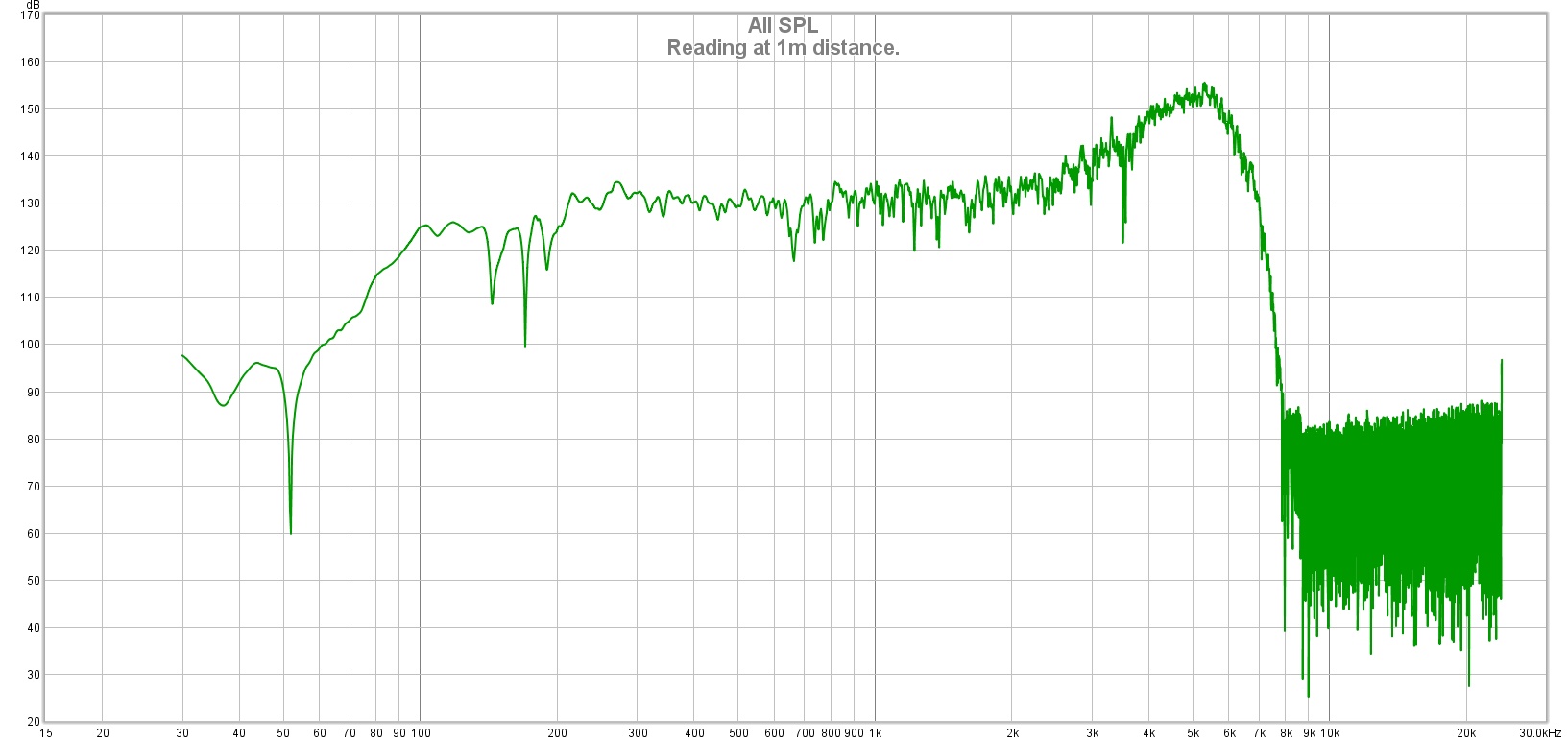

I have eventually got my microphone to work after unplugging all other USB peripherals. Rather than swamp you with graphs here is the one I took on REW at a distance of one metre. I am not an expert but surely the fall off at around 7K can't be right ?

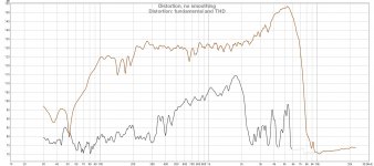

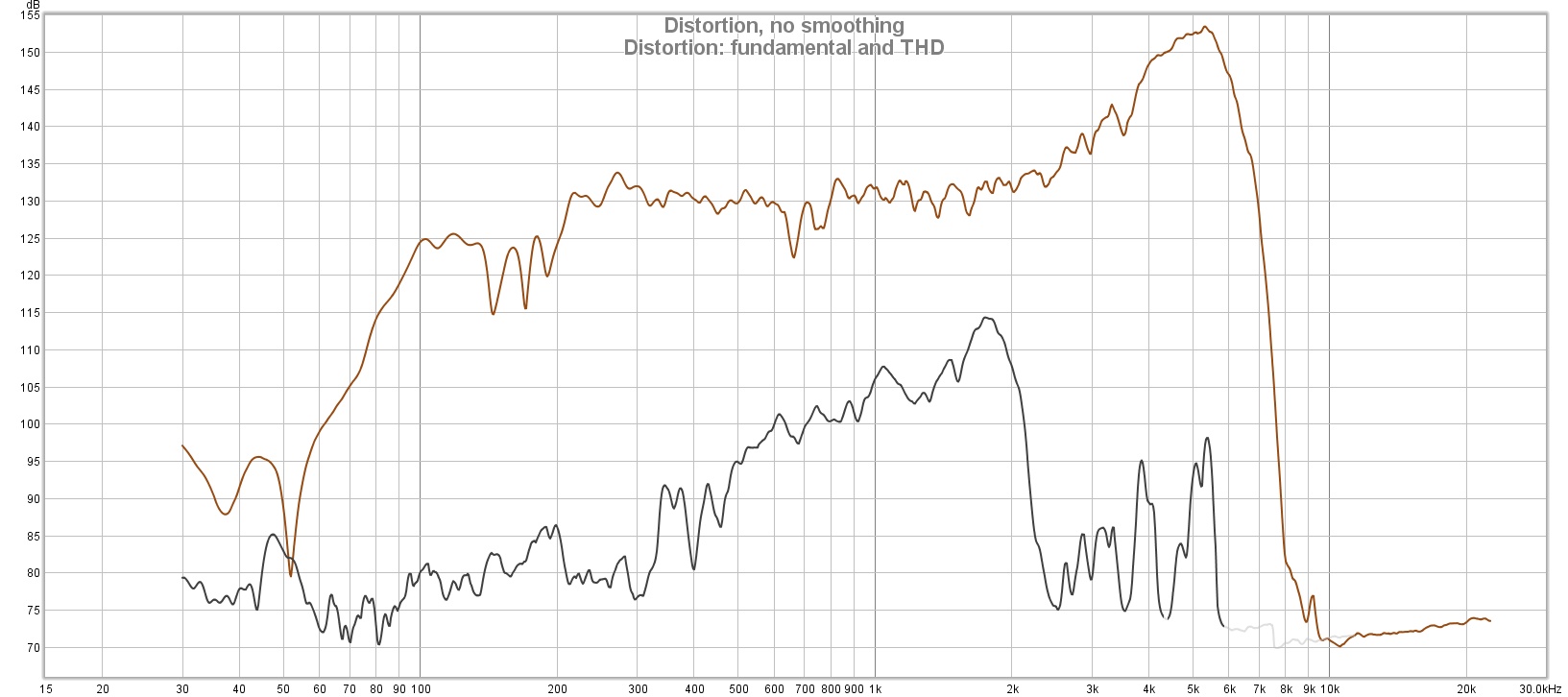

And this is the distortion plot but my studies of the subject so far haven't given me any real understand of what this is trying to tell me😕

But note the cheap mic I am using optimistically claims a freq range of 50 - 16KHz.

The roll-off and possibly the rise is likely the response of the microphone. The crossover regions look smooth suggesting the crossover is not broken like the one in the long thread.
The distortion curve shows OK levels for the tweeter and woofer but high levels for the midrange. This is solid evidence that the midrange is broken in some way. Are both drivers the same? What can you see from inspection? Is there something in the coil gap?
PS This is the full speaker and not just the midrange?

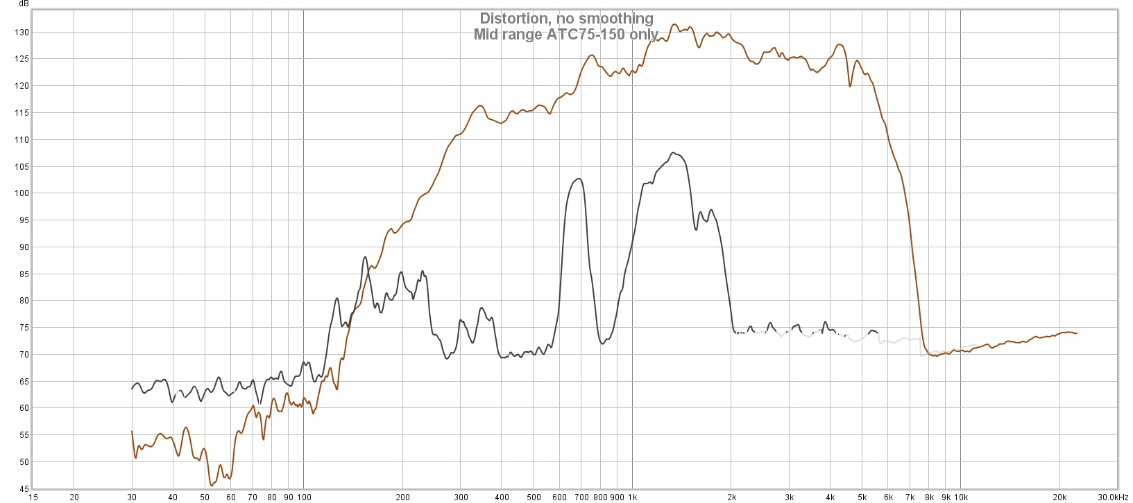

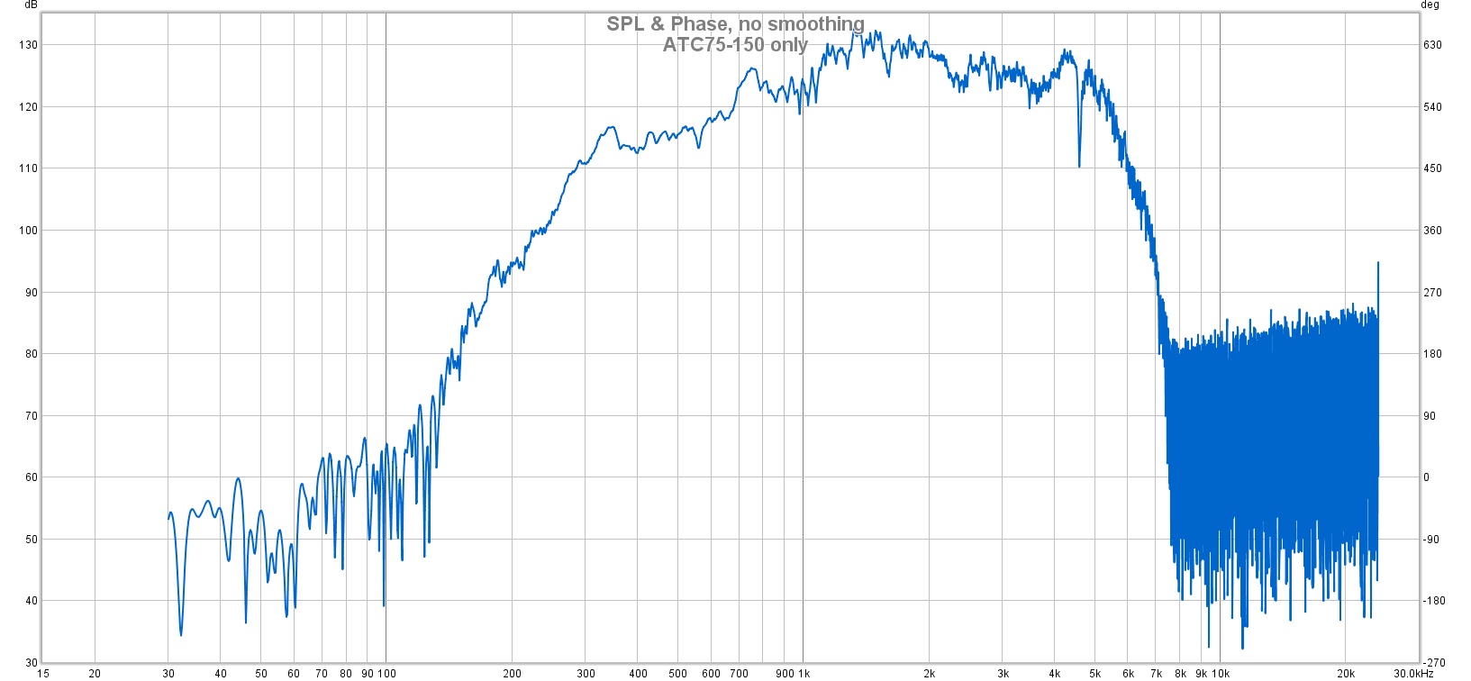

Yes all the graphs are from the full speaker ( where the xover is very hard to get at now ). Both the ATC mid ranges give the same distortion. The other one isn't yet in the cabinet and the following graphs are from this one on its own and just resting at the edge of a table.

Btw the ATC on its own was fed through the crossover. I assume it is unsafe to connect a driver directly to the amp's output?
One needs to take care with the fine wires in a tweeter to take account of the significant additional power from the mid and low frequencies and perhaps the turn on/off thumps from the power amplifier. Woofers and midranges generally have higher power handling and do not need to be handled with the same level of care as a tweeter. The motor in your midrange is not far off that of a typical 12" woofer and can be expected to be pretty robust.
If there is any question about the crossover (DIYed and from Wilmslow) I would suggest a quick check without it in circuit would be wise.
I connected it direct to speaker outputs. Still plenty of distortion. I aso checked there was no DC present on the speaker outlets: hardly likely but easy to check.
