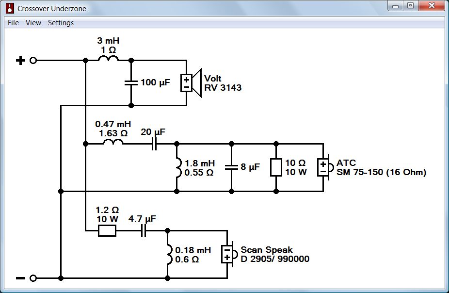

If you look below you can see that I have removed R5 (10 ohms) from the mid range section of the crossover. Is this likely to cause any problems?

Much "know-it-all" tedium from S7 in this thread. The purpose of R5 is to
suppress the Fs impedance peak of the midrange, it is not superfluous.
C2 and C4 cannot be combined as S7 erroneously implied.
You can't just remove C6.
You can't imply anything modelling a x/o in Boxsim with the
wrong 3 drivers, as though the x/o is independent of drivers.
Nothing could be further from the truth in reality, phase ....
rgds, sreten.

Hi sreten,
yes I figured out the purpose of R5 after some thought.
I have just finished re-building the crossover... pics to follow ;-)

When the crossover was first rebuilt, the tweeter output level was obviously too high. As stated by sreten, Boxsim is modelling using different drivers than mine so such tweaking was to be expected. Anyway a series 1.2 ohm mills 10W resistor sorted that out. The design of each crossover is now much simpler, with 2 less capacitors and 4 less resistors!
I know it takes a while to fully appreciate the changes that have been made. However, first impressions (after a 20 minute blast of my fav tracks) are as follows. The speakers have imporoved immeasureably!
The female vocals of London Grammar are achingly pure and alive. Imaging is suddenly sensational. I first thought these speakers imaged badly, there was no stereoscopic depth and no moments of 'what is that sound behind me?'.
Bass response and output is higher due too one less resistor as per the juancho design. Overall efficiency is much better. My Linn DSM listening volume is back to my normal setting 55. With the old crossover I had to listen at 63.
Any way thanks for the positive imput from all who did... mostly system 7 to be sure. I can see why people might think him a know it all - but I appreciated his no nonsense approach and his practical help, thanks Steve.

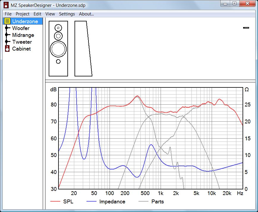

Pics of the final design and 'approximate' frequency response/impedance response:

Can you confirm that you have taken no measurements and designed a crossover using parameters and curves for a completely different set of drivers to the ones in your speaker? Each to his own I guess but is there something about Wilmslow Audio Prestige speakers?
Correct a mundo! I used Boxsim to model the differences between the standard crossover, the juancho crossover, and the suggestions made by system7.

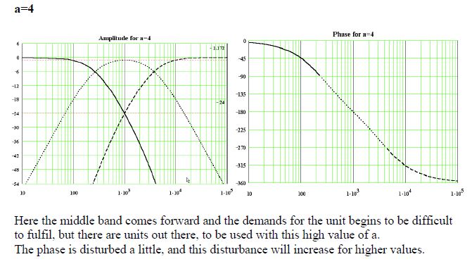

The fourth image is my generic solution followed by its frequency response and phase on ++-. I'd be comfortable tuning the tweeter and mid level by ear just by changing resistors, but I'd need to model the precise bass carefully because slopes are very driver dependent.

The modification of the woofer filter is not as harmless as Boxsim makes you believe. Attached a simulation of your current crossover using the correct drivers. It shows a serious problem at 340 Hz.
Using wrong drivers in a simulation is a bad habit of System7 and is pointless. You really have to import the actual driver data files. 😉

What is the simulation response with the original network?

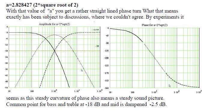

I am not a ******** merchant. I adhere to the Einstein of speaker design aka Steen Duelund. It seems he was right with his curves of speaker response. 😱

But you didn't do this. You didn't enter the data for your speaker but used some unrepresentative preloaded Visaton drivers. Visaton make it more awkward to use other manufacturers drivers because boxsim is part of their marketing. System 7 doesn't bother to enter the correct drivers I would guess because he is chatting on the internet but you are trying to sort out some expensive speakers sitting in front of you and not taking a few minutes to do this is rather weird.I used Boxsim to model the differences between the standard crossover, the juancho crossover, and the suggestions made by system7.
I am not scoffing I am interested in what might be guiding your decision making. You are behaving in a very similar counter-productive manner to katieanddad with his WA Prestige.You may scoff, however I am here listening to vastly improved loudspeakers 🙂
Why have you chosen to look to system7 and ignore the contributions from others who are pointing out what you are doing wrong and backing their statements with supporting evidence?
Why would you think some of the components in your original circuit had no function? Do you now understand what they did, why it was important and why your simulation using the wrong drivers did not contain this information?
I doubt there are many readers who think you are listening to vastly improved speakers. If the original circuit was competent, which we won't know if you do not measure it to find out, then you have messed it up. If the original circuit was faulty in some way then your circuit just might be an improvement but it will be poor compared to a properly designed and implemented basic one and significantly worse than a conventional DIY crossover developed using measurements.
Being pleased is good but do you think the crossover is better in terms of technical performance, worse technically but it sounds better and that is what matters or perhaps something else?Plus it didn't cost me any money, I used the parts available and unwound one inductor. I could not be more pleased.

Without the actual drive unit frd and zma files any sims are going nowhere.

Most of what I did with this 3 way was about the mid to tweeter crossover. Phase and level. Evidently that worked.
I really never made much comment about the bass to mid filter which hugely varies from Prestige to Prestige. IMO, the bass to mid filter is so poor that it hardly matters what you do. Gotta laugh really. 😀

Loudspeaker design using passive crossovers is quite complex and a 3-way is much harder to get right than a 2-way. According to Vance Dickason (Author of the Loudspeaker Design Cookbook) it separates the men from the boys.
I'd either buy some measuring gear and spend some time learning how to get accurate measurements. Or I'd beg for help on various forums, and with any luck you'll find someone who lives near that knows how to measure and design crossovers. The most important part is getting accurate measurements because you can always upload them and get others to help design the crossover.
