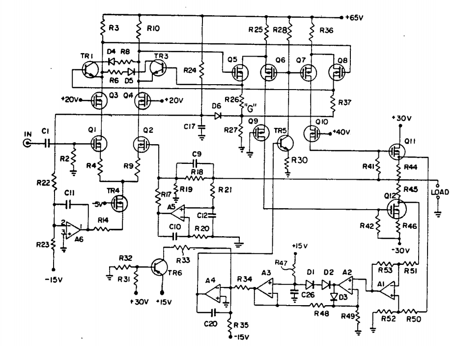

In 1988, Mr. William Chater published "A 40W All-MOSFET Power Amp" in Audio Amateur. I was quite taken with it at the time. Not the all-MOSFET design, but the 4-opamp servo he was using to set the bias current of his output transistors. I'm attaching a picture from his patent, which is for the servo, not the amp.
http://patft.uspto.gov/netacgi/nph-...50&s1=5055797.PN.&OS=PN/5055797&RS=PN/5055797
I adapted that bias servo to a triple-EF design I was working on at the time. It's really a very cool idea. The minimum of the voltage across R44 and R45 is proportional to the idle current, regardless of signal level. Let's sense the voltage across those resistors, and detect and hold the minima with a large enough time constant to control the DC bias.
Ultimately, I found the bias servo to be impractical. The reason is that R50 - R53 must be very closely matched to have enough common-mode rejection for this to work. I built it with 1% resistors for R50 - R53, and initially it seemed to work. However, when I hooked it to a loudspeaker, it fell apart. With a resistor load, zero-crossing of the current and voltage coincide, so not much CMR is needed. With a reactive load, A1 is trying to sense a very tiny difference voltage on top of a very large common-mode signal. Bias jumped all over the place, and I was afraid the amplifier was going to burn up.
I replaced R50-R53 with 0.1% resistors, and that helped a lot, but bias was still kind of jumpy with certain music and certain speakers.

- A1 senses the difference across R44 & R45.
- A2 and A3 sample the minimum of that difference. A2 quickly samples the minimum, and R47 lets it decay (very) slowly.
- A4 is an integrator, of course. The bias control signal must be well-below audio frequencies. A4 sets the current of TR5, which sets the current of Q6 and Q7. Q6 and Q7 set the bias of Q11 and Q12 with currents into R41 and R42.

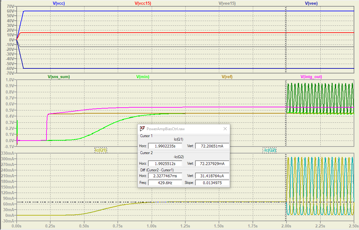

The amp is running at low bias by 500 ms, is at 95% of full bias at 1 sec, and is fully settled by 1.5 sec. How long do most amplifiers take to settle to their final bias current?
The thing I worried the circuit would not be able to do is keep a consistent bias with full power signals from 20 Hz to 20 kHz. At 20 Hz, decay on the min detector causes an error in the average sensed minimum voltage. At 20 kHz, the op amp U4 may not be be fast enough to detect the minimums. With the values of C and R I've chosen in the min detector, bias is down by about 3% at 20 Hz, but up by 25% at 20 kHz.

Here are some plots from the .tran. Supplies start at 0V and ramp up in about 100 ms. Then, it's off to the races. The 1st plot shows the startup with no signal until the 2 sec mark, when a 10V, 20 Hz signal is applied.

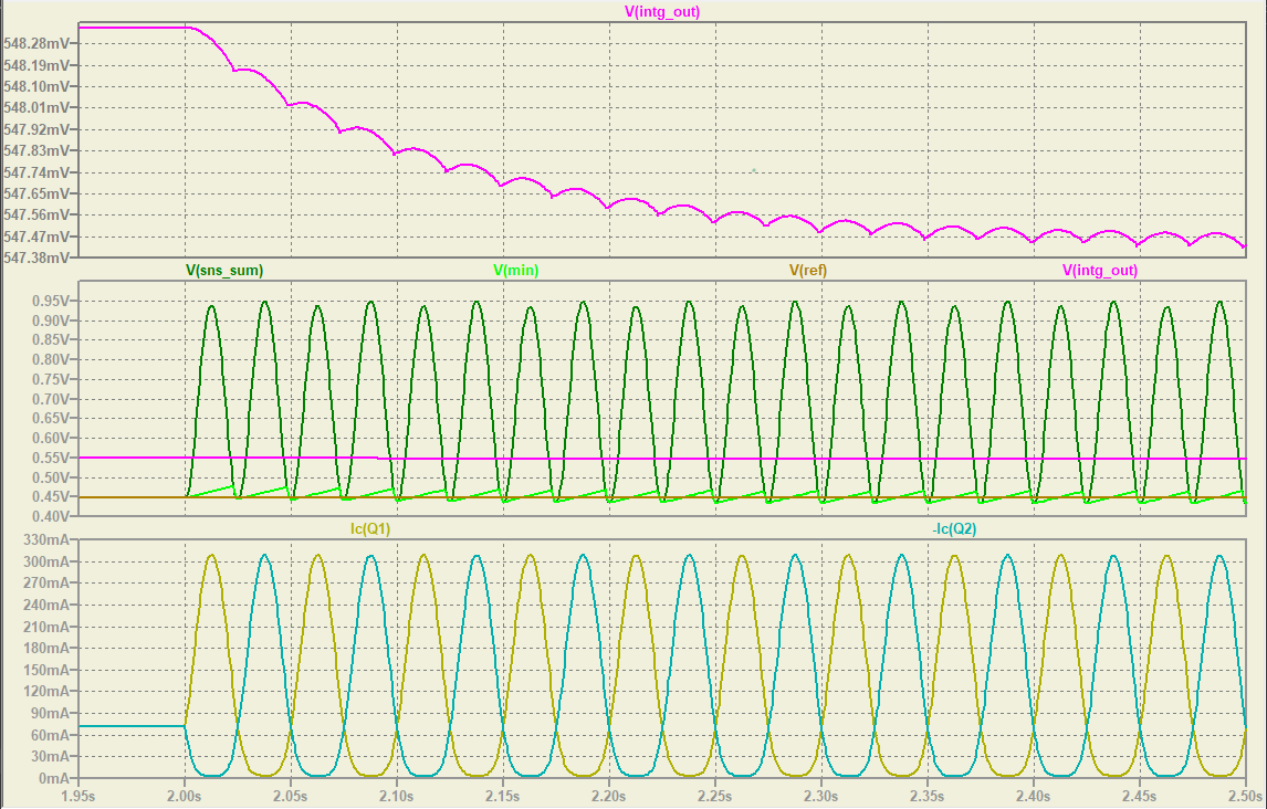

The 2nd plot shows a close up of the circuit operating with the 20 Hz signal. The green V(min) signal shows the decay of the min detector with a 1.1 sec time constant. The magenta signal shows the integrator responding to this decay (which looks like a bias current that's too high) by dropping it's output slightly, which reduces the bias, settling to a lower value in about 400ms.
So, if heating or whatever, changes the bias, this circuit responds withing 1/2 a second. That time constant could be made slower, but I'd be afraid of interacting with the thermal time constants.
There's nothing to trim in this circuit, once you have the bias you like, all subsequent production units should have a bias within 5% of that value (provided 1% resistors are used throughout).
