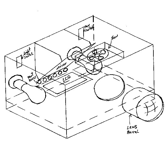

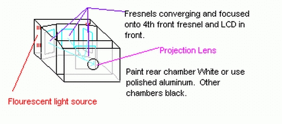

Since this is a will it work thread I will post my proposal. Probally won't work but... The design is fairly simple use flourescent light source in the rear chamber and use 3 fresnels to focus on to one. I can use as much flourescent light as I want. The picture shows the fresnels far apart but they would be closer with the lights to the sides, this should prevent hot spots.
A question about fresnels, you can pick them up off of ebay cheap, are they any good and with a 3x lens, does it make something bigger and smaller by 3x each foot? The threads that talk about such things are 3000 posts or so and I don't have the time to go back through them.

Hi Jimbo,
When I first started I had the idea of using compact flourescents. I thought these twisting molecules in the LCD would somehow align the light so you just had to blast light at it. I imagined these molecules like tiny optic fibers that would transport light wherever they point. Not true. The good people here got me straight. Each little pixel acts like colored glass. It filters but doesnt change the direction of the light.
The same thing goes for fresnels in that it will change the angle of light by a set amount - like a prism - which is what it is. A wide angle of light going in will not be focused. It will be a wide angle coming out.
When you have a large light source the light hits each pixel from various angles in a kind of funnel shape in and funnel shape out. If the funnel angle out misses your objective lens it is wasted. If it is at an angle your lens cant refocus, it is destructive! It will hit your screen as background light and wash out your image.
The angle of light must be controled and that is easiest with a small source. Its near impossible with a big one.
