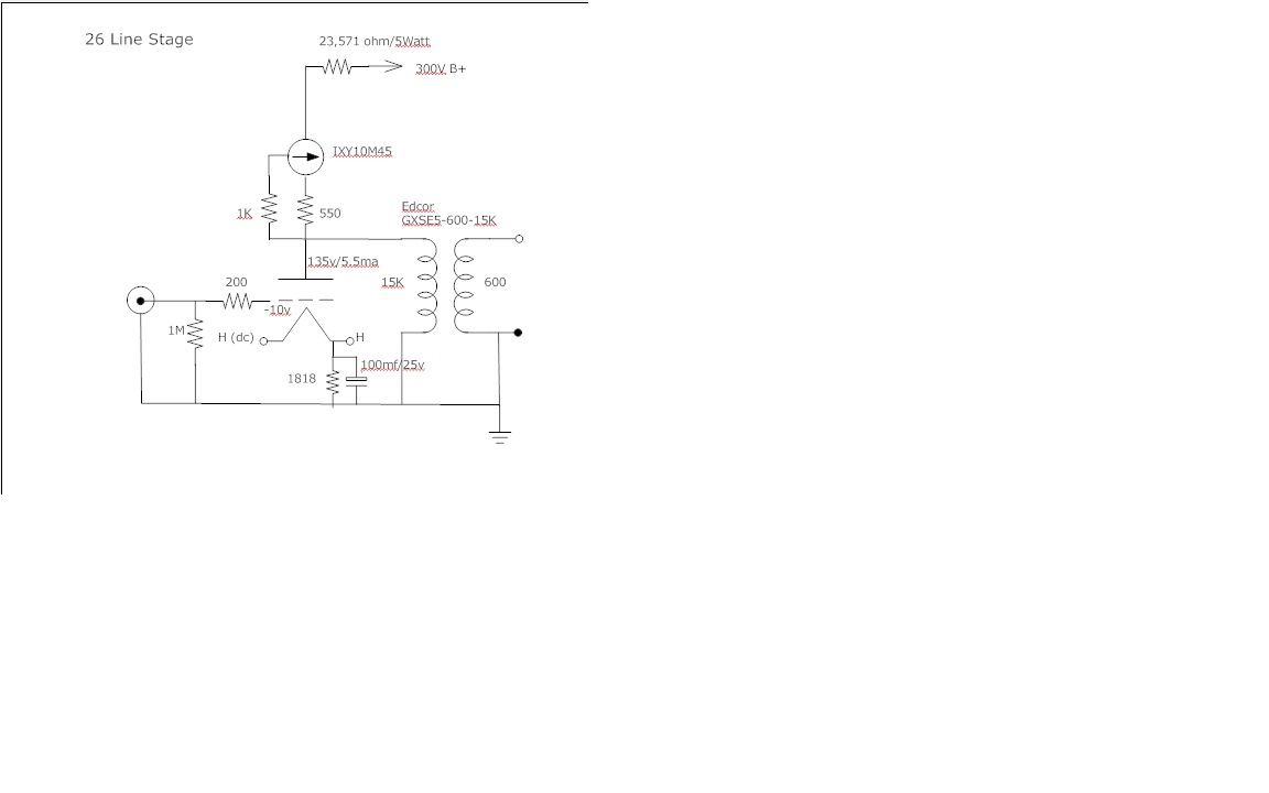

Hi Tom
I'm using a 10Y - 1.25A filament. Right now I'm using the LM1084 in current mode. 21v in, 18.7v out. Heat sink is 4" by 2" by 1.5" and is cool to the touch. That works. It didn't work in voltage mode - kept switching off on fire up. Even with the LM1084 in current mode it's not ideal - with 12v at the cathode the filament is at 6.7v not the specified 7.5v. That would require the cathode to be at 12.5v for a 10R resistor (filament 1.25A) and thus the input to be at 20v - 12.5v bias plus the 7.5v filament. So the supply should be 23v or more. I prefer the sound of the voltage reg mode, and would also like to end with a CMC which would absorb a little more voltage - around 1v. Does this help?

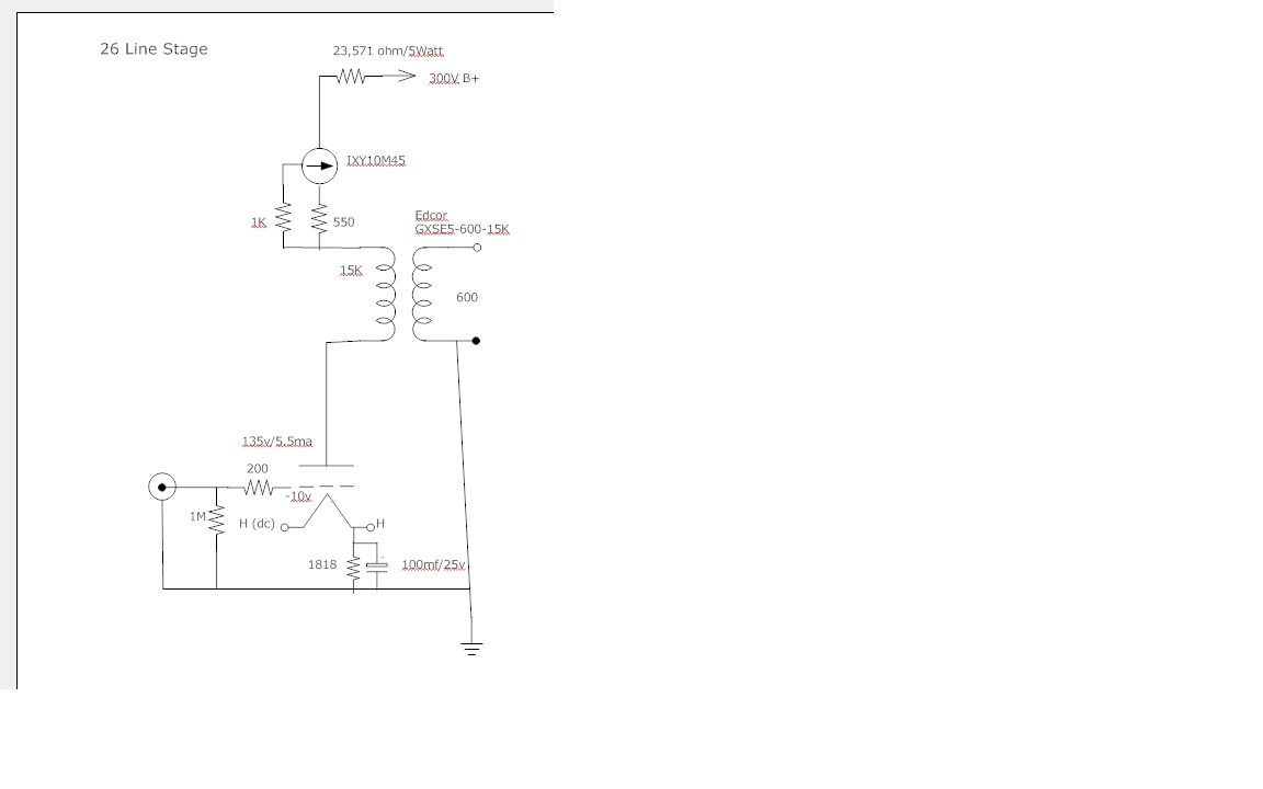

Hi Tom, I believe Andy's amp is in filament bias mode, as in my diagram in post above:
http://www.diyaudio.com/forums/tubes-valves/179197-will-work-26-linestage.html#post2400596
So if the chip delivers 18.7V out, and a 10R bias resistor is used, then for current-connected mode [1.2A]: bias resistor drops 12V, filament drops 6.7V = 18.7V - OK.
so the thermal load for the LT1084 is 2.3V x 1.2A = 2.76W
The heatsink Andy describes will work fine.
At switch-ON the story is changed by the filament resistance dropping to ~1R. So transient thermal pulse is 1.2 x 7.5 = 9W, which still should be OK, providing the heatsink was below 30 deg C at switch-ON.
For voltage mode, at switch-ON you get a current ~18v/(10+1) = 1.6A, and a drop of 10V =16W
The LT1084 in TO220 pkg, which shows 2.7K/W to the heatsink (more like 3.2K/W with a mica insulator). To keep the chip below 125 deg C, you'll need to keep the rise below 100 deg C. At 16W, that's 6.25K/W - or 3K/W from the heatsink, bare minimum! THat's a bigger sink than Andy describes, so the cutout is not surprising.
Andy, I'll get your kit made up for the filament bias operation. Would you like it for #26, or for 10Y? actually I can send both resistors so that you can adapt it.
Take care that you have enough voltage headroom in each case - 4.5V minimum up to about 8V. For 10Y and 10R, your proper output voltage is 20V, so 25.5V to 26.5V is the target for the raw supply.
With (say) 6V headroom, you get about 6W burned in 2 TO220s, and the heatsink should be 5 or 6K/W.
