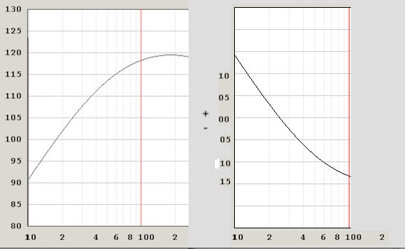

I have two subwoofers using B&C 18TBX100 drivers currently installed in my HT system. Recently, it was pointed out to me that the natural response of these drivers looks like this:
Note the falling response below 100Hz. By 20Hz, it is -37dB compared to reference. It was pointed out to me that I might get better performance if I changed the driver to something which was more linear across the frequency range which I am using, which is 15Hz - 100Hz. I ideally want something with excellent low bass performance, particularly between 15-30Hz.
Since my subwoofer boxes have already been constructed, I am seeking opinions as to whether this replacement subwoofer driver will be a good fit. Any replacement driver MUST fit in these boxes.

The replacement driver has a much more attractive frequency response curve:
It is -12dB at 20Hz (compared to -37dB for my current driver).

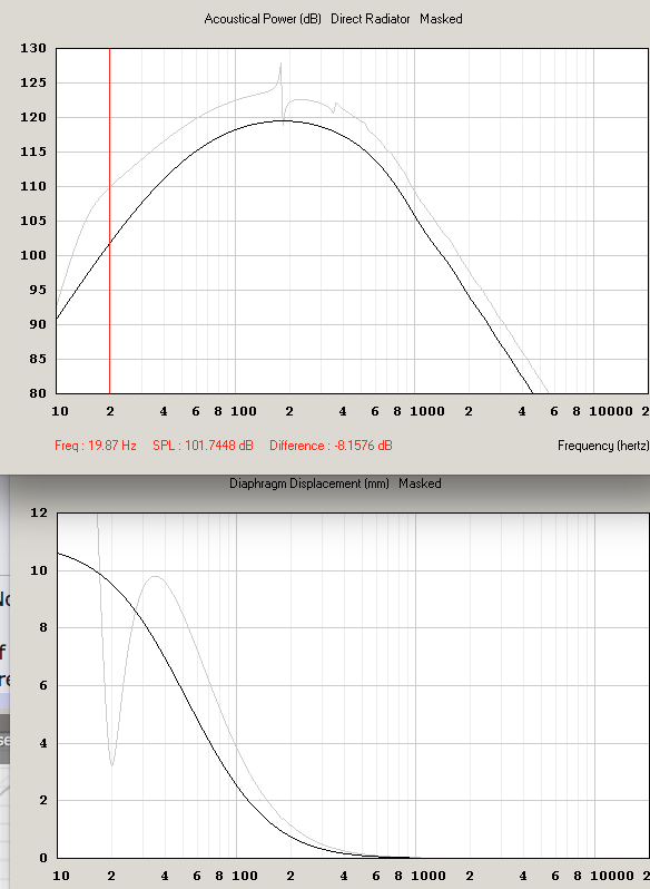

The way the two drivers have been measured does not represent the lower frequency response in a 165L box,the natural frequency response curve looks better
the Faital 18HP1030 is the upper gray trace, the B&C 18TBX100 is the lower black trace.
The frequency response is nearly the same, the Faital 18HP1030 has more excursion (Xmax) so using more power (47volts compared to only 35volts) may go slightly louder and still sound clean.
No, the drivers are virtually identical in efficiency- the parameters are too close to make much difference.

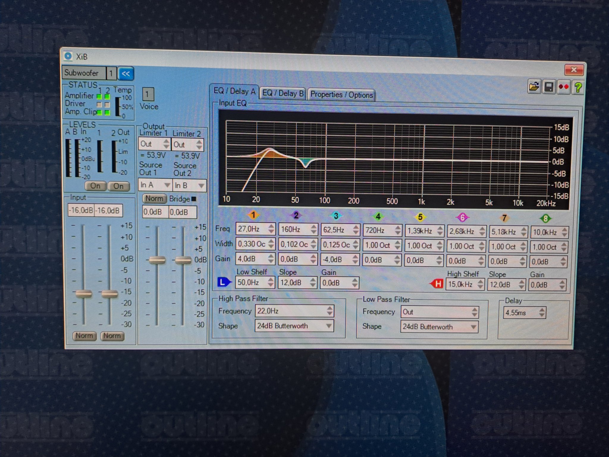

Thank you for your responses. I think it is clear from your replies that this driver will not be much of an improvement over what I am using currently. It looks like I have 3 options:
1. Choose another driver
2. Use DSP to equalize the response to boost the LF area between 15-30Hz - I am already doing this but I am concerned that I will increase the distortion by "forcing" the driver into operating outside its design parameters.

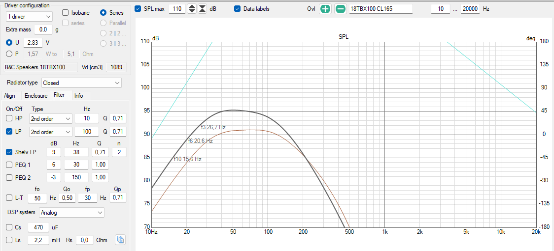

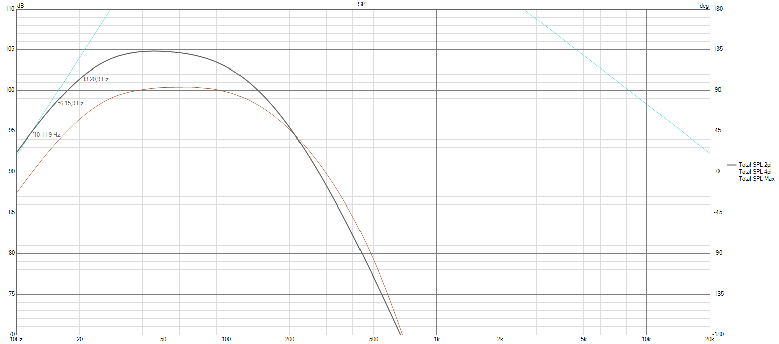

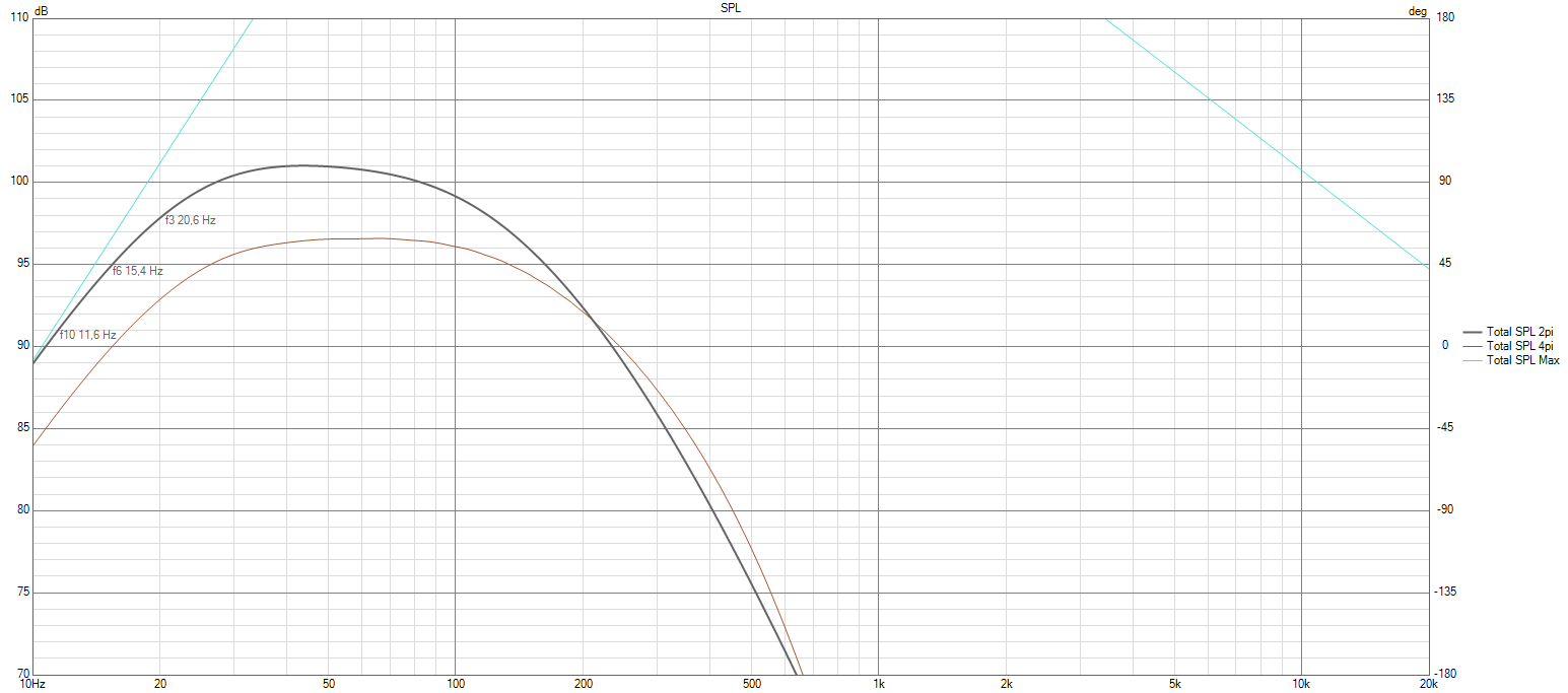

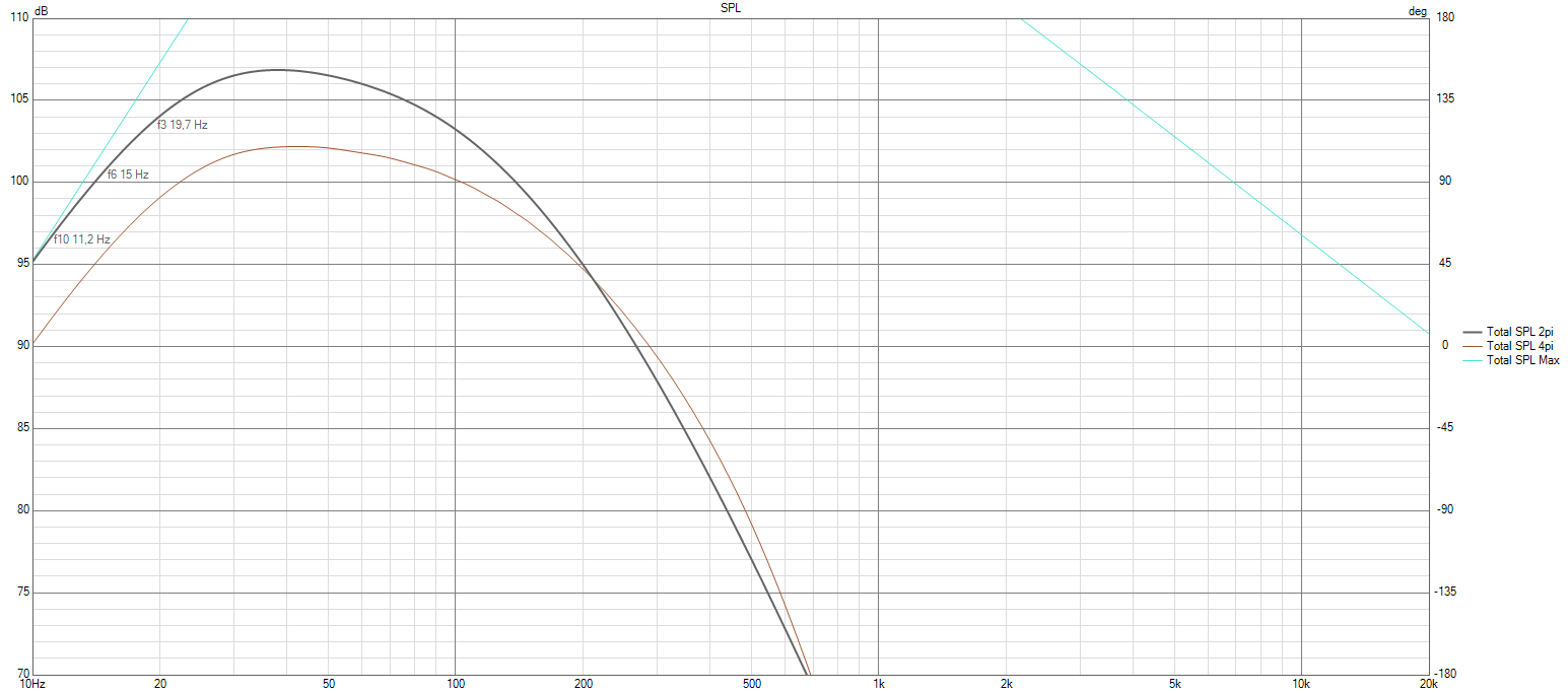

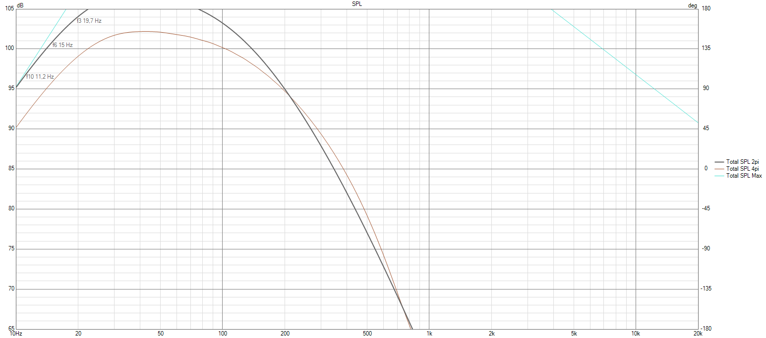

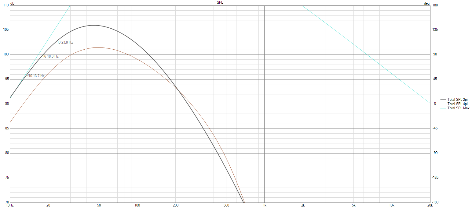

165L box / completely stuffed with the DSP parameters shown below
Your woofer - F3 21Hz / spl max 96dB / 10W to reach Xmax at 10Hz
B&C 18SW100 - F3 21Hz / spl max 100dB / 22W to reach Xmax at 10Hz
BMS 18N860 - F3 20Hz / spl max 103dB / 36W to reach Xmax at 10Hz
FaitalPro 18XL1800 - F3 20Hz / spl max 102dB / 41W to reach Xmax at 10Hz
SB Audience Bianco-18SW450 - F3 24Hz / spl max 102dB / 18W to reach Xmax at 10Hz

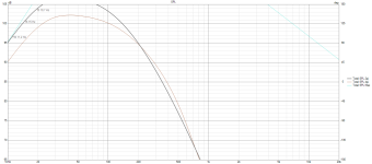

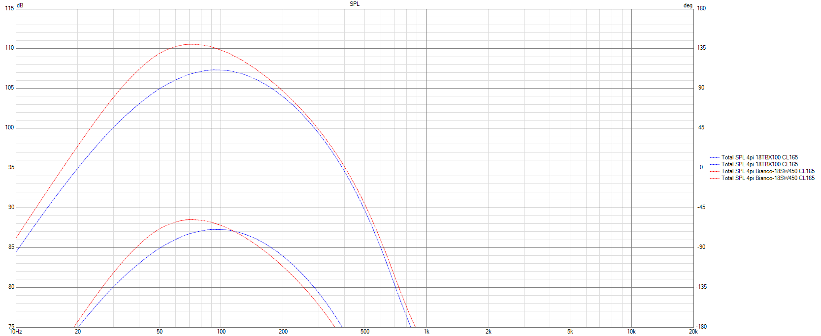

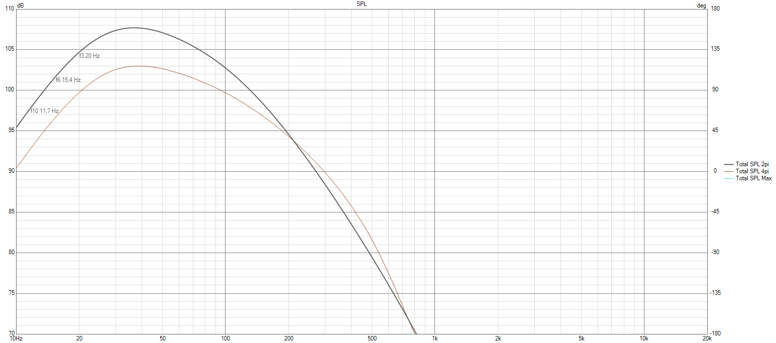

He has then a lot of power and the box volume is huge for this kind of driver (Qtc is always lower than 0.6) so you have the ideal conditions to use DSP EQ but you have to consider that if you want to go lower in frequency you get a reduced max SPL and you need a longer cone excursion.
Below you can see the differences between the SBA Bianco (red) and the B&C he currently has (blue) with x-over frequency at 100Hz (no DSP applied). The SBA has a lower F3 and a better max SPL because of the higher Xmax.
The choice is obviously related to what is better for your friend: low extension, sensitivity, spl max, etc. and consider that a driver can have a lower distortion and/or better specs.

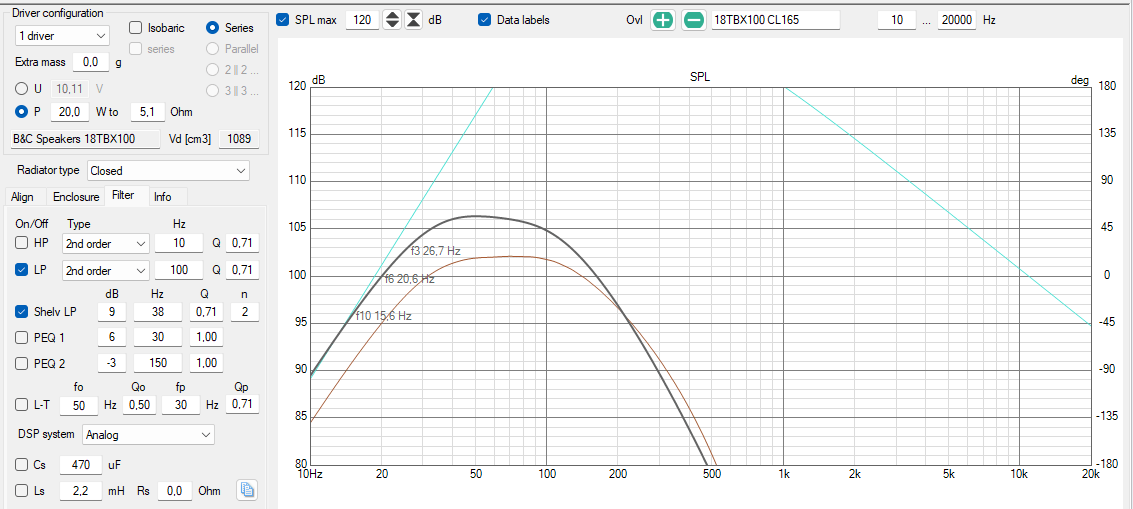

1) No reason to choose another driver until you have applied EQ and found your present driver lacking in some way.Thank you for your responses. I think it is clear from your replies that this driver will not be much of an improvement over what I am using currently. It looks like I have 3 options:

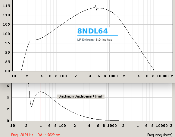

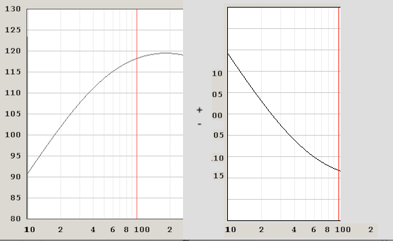

2)Equalizing a driver to flat response, or any desired response shape has no effect on distortion, as long as does not exceed Xmax/Xvar, it's linear operating range.
As an example, I am using a pair of 8" B&C 8NDL64 drivers (Fs 80Hz, Xmax 4.5mm, Xvar 5mm) each in a 16L box with an Fb of 25Hz with external ports. The pair can do around 102dB at 25Hz without exceeding Xvar, enough clean output for my use below Tannoy PBM6.5 at moderate levels. They require a lot of EQ to flatten the response, and a steep crossover slope to counteract the rising response.
The B&C 8NDL64 Vas is 9.6L, the box volume almost twice that.
3) Adding a port does not require building a new box unless interior bracing makes the long vent path impossible.
The simulations in post #2 deducted the vent volume from 165L.
1&2)Vas and Fs are primarily a concern if you are trying to achieve a "flat" alignment.
Flat response in the 15-30Hz range in a sealed 165L box would require an Fs below 15Hz...
Since you have EQ available to adjust the response, go ahead and do that before considering other drivers.
The BMS 18n862 does have near double the Xmax of your B&C 18TBX100, so will be capable of about 6dB more output down low- near as much level sealed as the B&C 18TBX100 ported.
The pair of your drivers in 165L sealed is displacement limited to ~108dB (clean) at 20Hz, 116dB ported.
Whether you want more SPL than that should be the determination of changing drivers, not response shape.

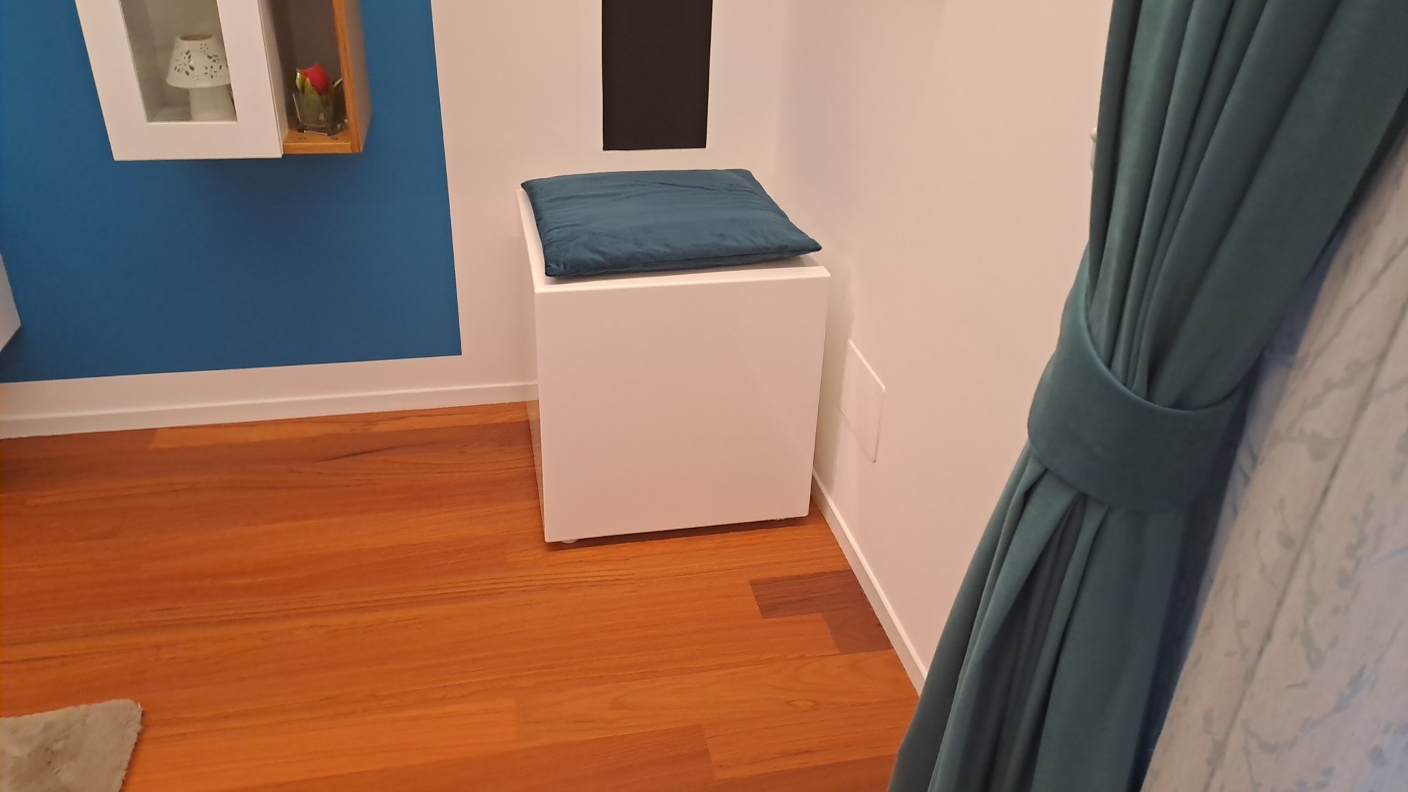

As i said, own 2 tbx, both are una closed cabinet.
The cabinet are situated near the angle of the front wall, so I have one on the left and one on the right.
The subs are feeded with the outline Dpa 1002 (those are powersoft rebranded amps) see attached pdf.
I cannot say that I'm not satisfied with my actual sub's, but I'm searching something that is pushing more.. and a little bit more of extension on the low frequency.
So a friend of mine is suggesting to replace the tbx with the lavoce SAF 184.03 and replace my actual amp with something more powerful, having at least 1200 watt on 8 ohm.
So the question is, with this replacements I'll feel something different compared to my actual configuration?

The B&C 18TBX100 drivers are very popular here. Reliable, not too expensive and provide a pretty decent output in the right box.
You wrote you would like to cover the range of 15Hz - 100Hz, with excellent low bass performance between 15-30Hz.
Exclusive of room response, your sub has ~+21dB rise between 15 Hz and 100Hz, so to achieve flat response would require around 21 dB of EQ, +10@15Hz, -11dB @100 Hz, the inverse of the response:
There are many ways to achieve the response, whether using Low Shelf/High Shelf, parametric EQ or a combination of both.
You are only using a +4dB boost at 27Hz, and a narrow band slight cut of -4dB at 63Hz, about 17dB too little to achieve your goal.
Your settings on the amp DSP has the HP (low cut) filter set at 24dB BW, to achieve 15Hz response, it should be reduced to around 14Hz 24dB BW. The LP filter (high cut) is set to "Out", it should be set to around 100Hz 24dBW or LR (LR will be -6dB at 100Hz, BW-3dB at 100Hz).
Your limiter(s) are set to "out", to protect against over excursion <15Hz, set to 35volts to be conservative.
35 volts will limit the upper SPL to 118dB, but considering the sealed output at 15 Hz is around 98dB (104 dB for two cabinets) should be plenty.
As the suspension of the 18TBX100 limits excursion above Xmax,you could be a bit less conservative with the limiter setting and still not worry about excursion damage.
Doing this, how many watts ill send to the subs?Your limiter(s) are set to "out", to protect against over excursion <15Hz, set to 35volts to be conservative.
So applying all this changes how my sub response will change between my actual configuration?Your settings on the amp DSP has the HP (low cut) filter set at 24dB BW, to achieve 15Hz response, it should be reduced to around 14Hz 24dB BW. The LP filter (high cut) is set to "Out", it should be set to around 100Hz 24dBW or LR (LR will be -6dB at 100Hz, BW-3dB at 100Hz).
Can I ask you a graph with both configuration, in order to understand the behaviour of the subs?
Also this will reduce the transient response? I like how is fast and punchy right now, so I don't want to loose this characteristics...
