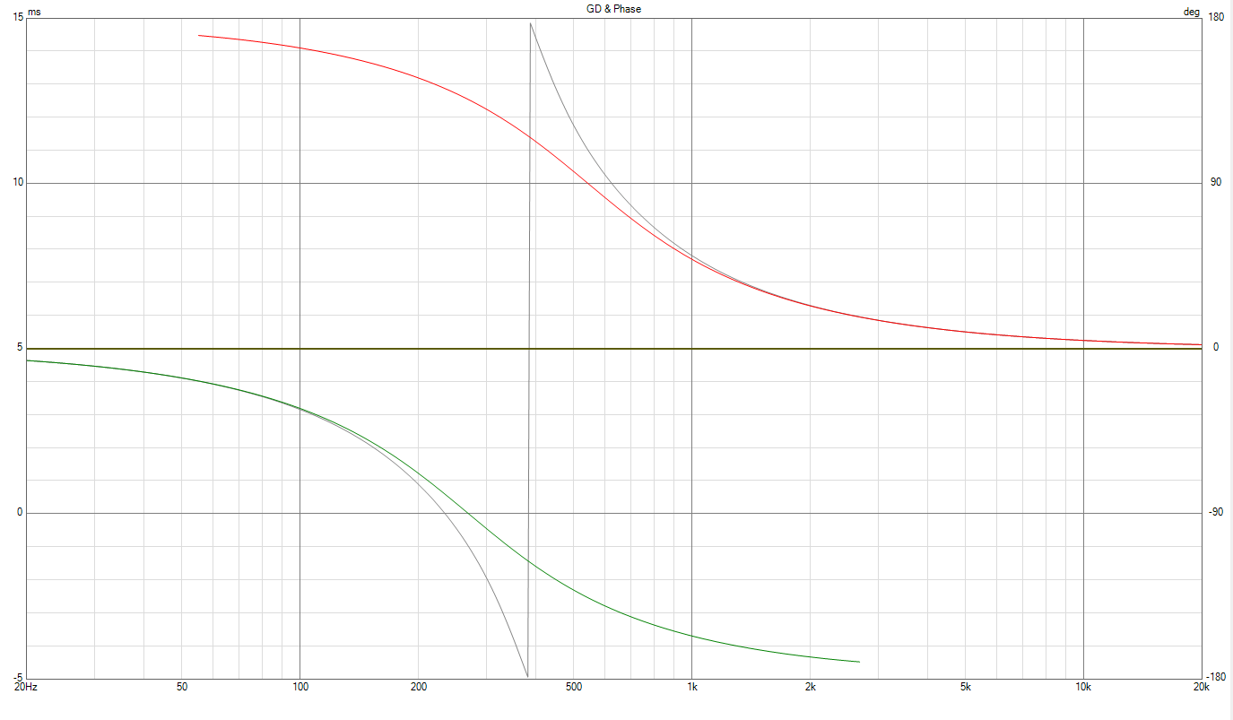

I'm working on a project to convert a passive two-pole crossover to an active four-pole crossover. I've been having fun with the simulations. It's getting close to the end. I've arrived at the sweet spot. It is a transition point that provides nearly identical frequency response curves between two cases--reversed and unreversed polarity of one driver in active four-pole crossover system. Despite having nearly identical FR curves, their phase plots differ. Nonetheless, it begs the question of whether these two cases will produce the same sound that we would hear. In brief, if the FR curves match but the phase curves do not, will we be able to tell the difference between the two cases? Also, this creates a tough decision, so which case do you believe is superior?
...In brief, if the FR curves match but the phase curves do not, will we be able to tell the difference between the two cases?...
It depends on how extreme the phase growth is...
If one crossover has less than 90 degrees of total phase shift (i.e., essentially first order IIR filters) and one has significantly more than 90 degrees of phase shift, you will hear a difference if your loudspeakers have full range directivity and you've treated your listening room with absorption to suppress early reflections just around the loudspeakers and the listening position(s).
If however you're talking about the difference between something like 360 degrees and 450 degrees of total phase shift and you're listening on-axis, your loudspeakers are direct radiating (i.e., have essentially no directivity control outside of the highest frequencies of each driver/way) and you have a lot of early reflections just around the loudspeakers and/or the listening position(s), I don't believe that you're going to hear much difference, if any, if the amplitude response is within about ±1.5 dB.

Hi Chris,
No, you didn’t miss the phase plots. I didn’t post them because the experiments I was doing were based on simulations by software only, therefore, there were no FR or phase measurement results.
However, I recognized the phase difference because it’s obvious that the polarity of one driver on one experiment was inverted while the other wasn’t.

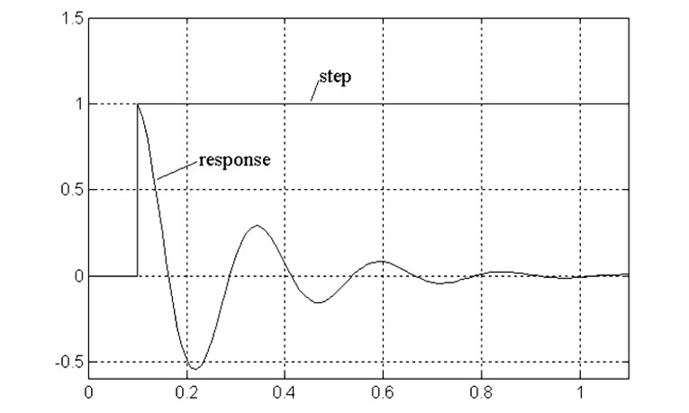

If you look at the step response, the closer it is to a perfect loudspeaker step response, generally the better it sounds, although my caveats stated above still apply to being able to hear direct arrival energy over first (or subsequent) reflected energy, e.g.,

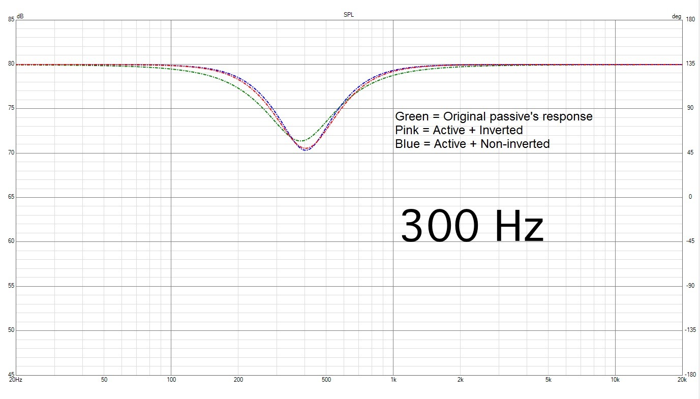

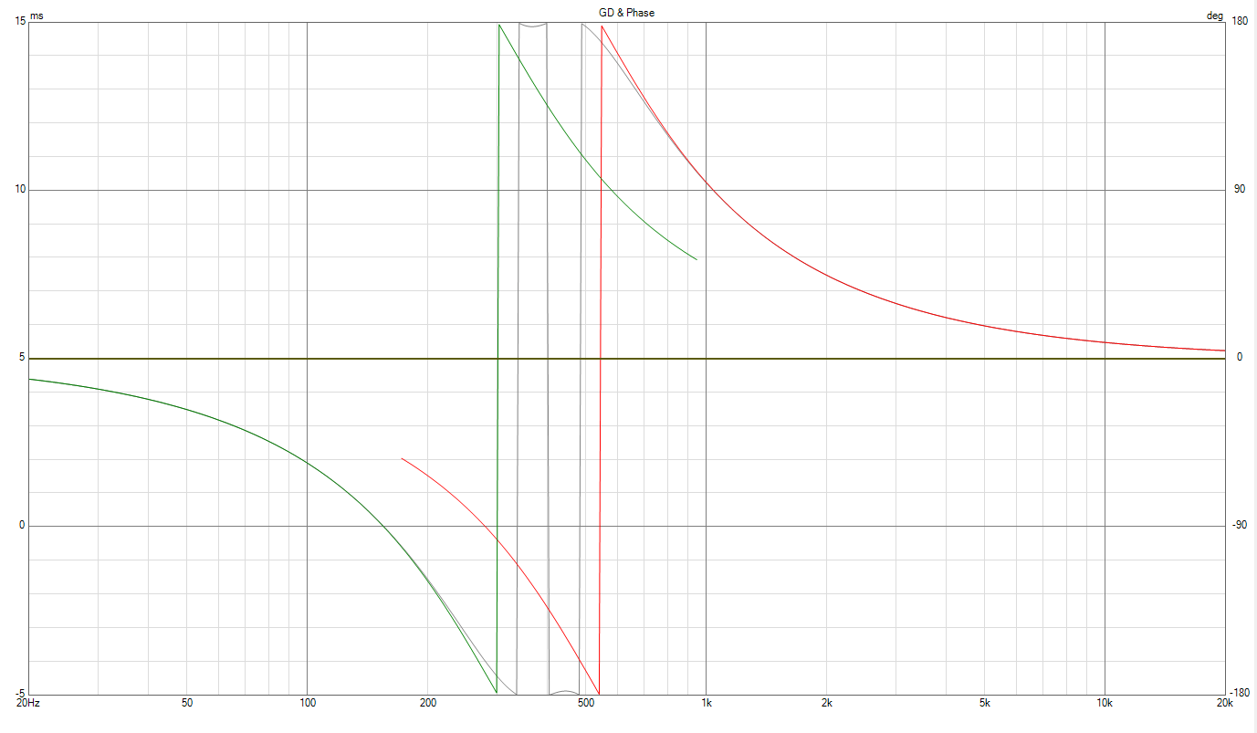

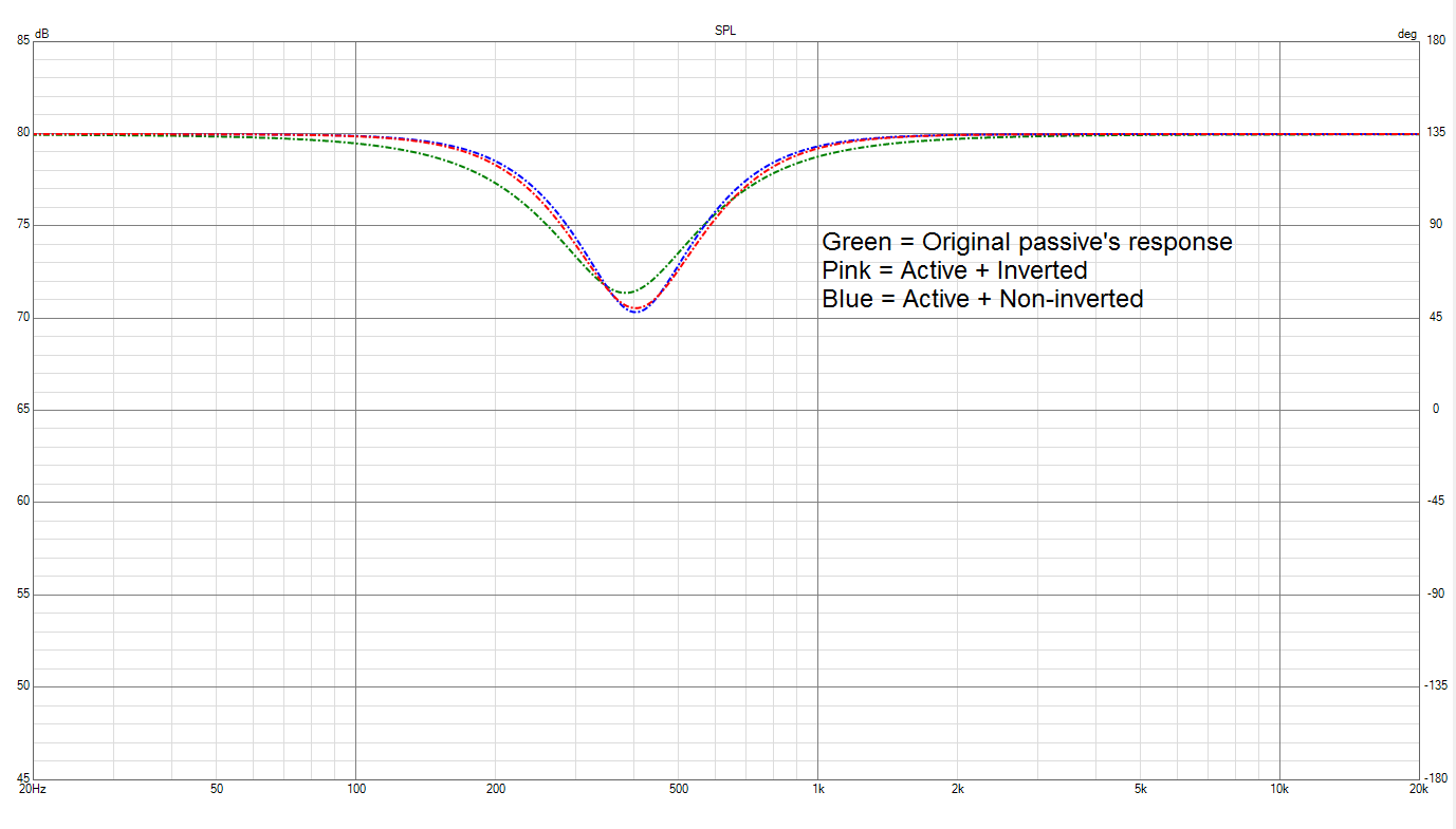

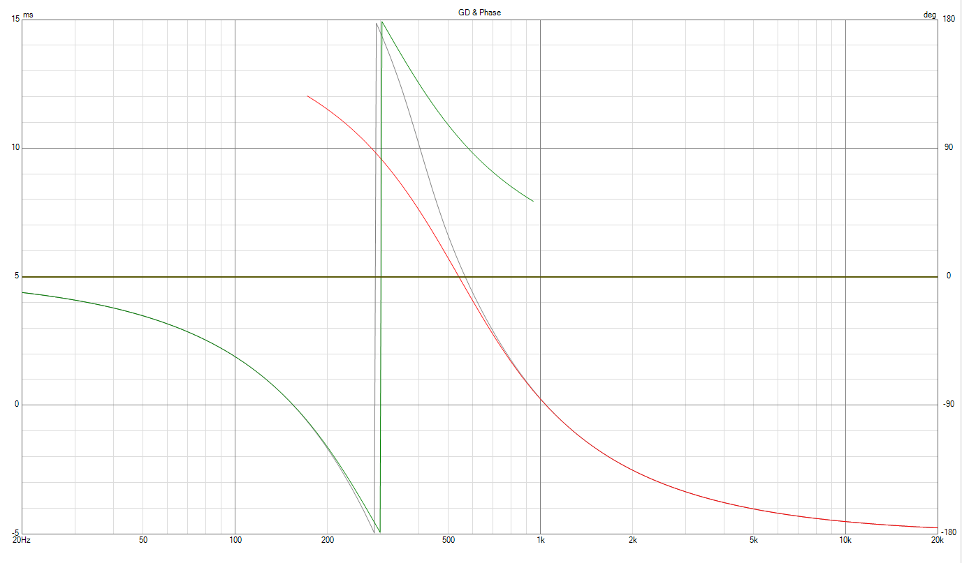

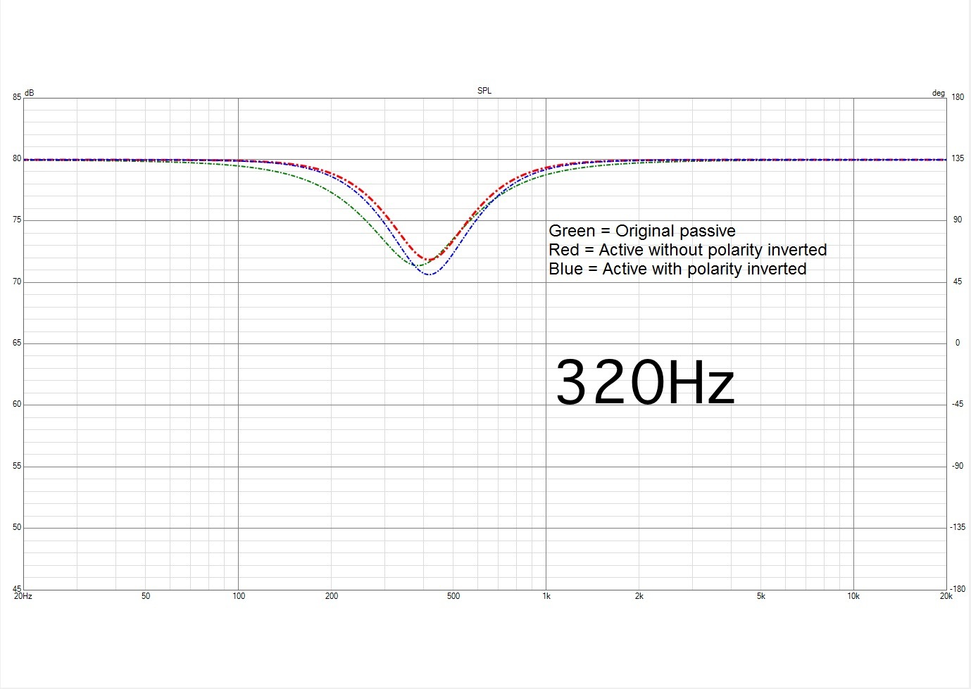

To date, I have had the opportunity to conduct listening tests. I discovered that the two scenarios had different outcomes! Nonetheless, they were distinct from the prior post.
Previously, the low-pass section's cut-off frequency was set to 320Hz, with a slope of 24dB/octave. It was altered to 300Hz with the same slope on this thread. Still, the high-pass was the same at 540Hz @ 24dB/octave in both situations.
According to simulations, 320Hz would provide a "obvious" difference on the FR curve regardless of whether the polarity was reversed or not on either low-pass or high-pass, and it would also be valid when listening. However, there was a mild difference on the FR curve of the 300Hz case. The results exhibited that the 300Hz produced less dip on the FR curve with polarity reversal as oppose to the 320Hz.
And the listening tests verified that the sound in these two circumstances would be more pleasing when their FR curves had a shallower dip. Is there anyone who understands and can explain this?
