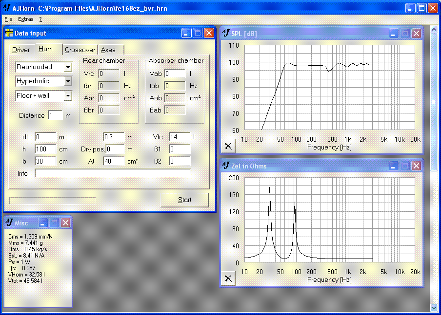

Hi Scott, you are 100% right - AJ Horn expects one continuous expansion / section and then you choose parabolic, conical, expo, hypex, octo-hyperbolic, geometric or tractrix. (It can do non-horns as well, by treating them as variations on a FLH/BLH.)
yeah - for BIB, AJ-horn using "parabolic", appropriate driver position and very small starting area replicated what I've seen with MJK's sheets. Dunno if it can do a so-called tapped horn but Hornresp can handle a lot of those situations. It would be interesting to see real-world measurements of a lot of horns. I have a BK20 which measures rather roughly outdoors - indoors with a cheap Sammi speaker in a certain (accidental) position its response looked very smooth. RCA-Fan used AJ-horn to illustrate his K (or Fulmer slot) blh. I don't know how he arrived at the input but his graphs were good with Fostex. When I use his input with a known 1772, response looked pretty poor. FWIW I'm having fun with 1772 in the early 12" Karlson - wish TB would make a 10-12" version :^)
It can, from the POV that a BIB is a tapped horn; the DSL style boxes are what might be termed as 'double tapped' viz. tapped into the horn at two separate locations rather than one.
It's interesting that it's the parabolic function in AJ that's most effective, as the BIB has a conical expansion; just proves how different software all have their idiosyncracies.
