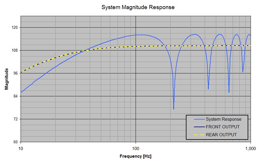

Unless you give the "width" (For a baffle) or "length" (for a U-frame) you can't answer the question about SPL because these determine the level of cancellation between the front and rear waves at any given frequency and thus the SPL at Xmax.
Since you didn't mention the size of the baffle you had in mind I will just pick a few:
FRONT TO REAR PATHLENGTH OR BAFFLE WIDTH --> MAX SPL @ Xmax @ 20Hz FOR ONE DRIVER:
40cm / 16 inches --> 87dB
80cm / 32 inches --> 93.7dB
120cm / 48 inches --> 97dB
160cm / 60 inches --> 99.7dB
These distances are from the center of the cone on one side to the center of the cone on the other, so the 16in value is for the driver used nude. For each additional driver an identical open baffle (including both in the same baffle), add 3dB to the total SPL. The frequency response will have a shape something like the blue line in the attached plot (of the 60in wide baffle). Note that for some frequencies the SPL of the dipole is as much as 6dB higher than for an infinitely large sealed box. This happens between 37Hz and 180Hz in the plot.
Here is how I modeled the OB response:
I used a Thiele Small box model of the driver in a closed box of infinite volume. I then adjusted the input power until Xmax was reached at the frequency of interest, which you mentioned was 20Hz, giving 104dB. This calculates the SPL from one side of the driver cone in free air. I will assume that the front and rear output is the same (a good approximation at low frequencies). Then I generated an FRD file of this response. I created two "drivers" in the Active Crossover Designer, one to represent the front of the cone and the other two represent the rear of the cone. The phase of the rear cone is inverted and the "acoustic delay" of the "rear cone" is set to a delay that correspond to one of the lengths listed above. The "System Sum" is the sum of the SPL generated by the two sides of the cone and represents the response of a open baffle when positioned in front of the baffle.
