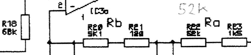

leadbelly said:
Well, I am still confused, since you refer to a 52K resistor, but in richie00boy's schematic we see a 68K resistor combined with the 1.5K.
Yes, I was intrigued by this as well. I'm using the schematic published in "Self on Audio". I don't have a copy of the original magazine articles at home, but will look them up when I get back to work.
As I said before, I spoke directly to D Self about this, and he confirmed that the sum of R22 and R23 should be 53.5K - what more can I say? Feel free to email him yourself if you want to be doubly sure 😉
Just to show you the problem I faced, I've scanned in a section of the schematic from the book. As you can see, it's pretty hard to read, which is why I originally approached the author.
The "pixelisation" is present on the page - it's not caused by my scanner. It's almost impossible to guess at a value for R22, but note that R18 is 68K, and that the value for R22 looks nothing like it.
I scanned at 1200dpi in an attempt to show the problem. But of course the above image was downsampled to make it fit here. So here's a full resolution close-up of R22 - not sure it helps! 😉
I looked at the Lipshitz equations, albeit rather superficially, and I've had a play with a simulator. And I think R22 should be 62k. Which is a plausible interpretation of the page as printed. I'd be intrigued to see what Douglas said.

Well I can vouch that what I posted is what is in the magazine. Whether Doug then changed his design slightly when publishing in the book (which came along a good few months, maybe a year or so, later) is the only guess I can come up with.
richie00boy said:Well I can vouch that what I posted is what is in the magazine. Whether Doug then changed his design slightly when publishing in the book (which came along a good few months, maybe a year or so, later) is the only guess I can come up with.
Yes indeed - that was my best guess also. For info, the book was published 4 years later in 2000. And IIRC, it was 2002 when I had the email conversation with him.
For kicks, I went back to the original scan and put the text for R22 next to the text for R18 (68K) and R20 (5K1). Looking at the "6", I don't think R22 could be mistaken for 62K - the left hand edge is much more rounded. Compare it to the "5" of R20.
Incidentally, if anyone is considering building this, please note that the output is a bit on the low side as the Precision Preamp was designed with a nominal line input level of 200mV. It really needs another 10-20dB of gain to make it match better with other source components. I effectively "fix" this in software in my preamp, but did ask Douglas about modifying the RIAA preamp for more gain, but he politely declined (understandibly - it's not a trivial exercise!) If I was building it again, I'd add another op-amp after the IEC filter. Or consider removing the IEC filter function from the second op-amp and using that to provide the gain...

Thanks for the very useful spreadsheet peranders. Using it, I can confirm that the correct value for the self circuit is 62k.
