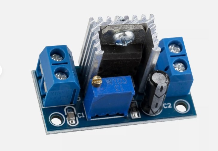

Same exact 317 regulator with led display and "banggood" capacitor. drop in a few Nichicon's , perfect 1A PS.
Actually a little cheaper than the 10-12$ ebay price.
I guess the same backroad board house sells to all .
Seen the same product on ebay,walmart,amazon,temu. And even cheaper on Alibaba ! If I buy 100.

Yeah , I have quite a few "banggoods" , use them for my breadboarding. NOT for any final product.
"ChangQ" is another dubious cap.

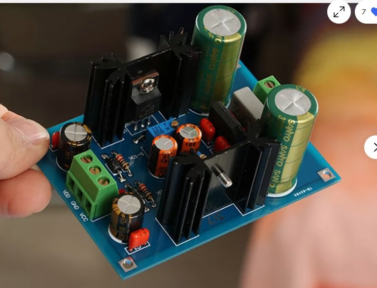

(below 2) Temu has these , Ebay has these. Must be legit , It will happily run (12V) all day with 10R , lose .02-.03V (1.2A).
I have 3 of these , One did not have "banggood" caps !

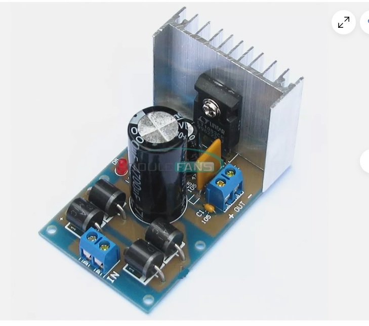

(below 3) I am pissed !! Bought a LT1083cp. Would not adjust below 5.1V , advertised as 2.5 -30V. Hmmm
Has big 7A diodes and a 7A poly fuse. Most I could get was @ 2A before the voltage collapsed !
I think this semi is actually a repackaged LM7805 in a TO-3P case and they designed a PCB to make it adjustable.
#1 is not worth my time. (screw TEMU) - #3 I'll either get my $$ back or tell the seller to give me a free #2 , which I know is legit.

PS - #2 you don't get Sanyo's ..... you get "banggood" - banged good.

LT1083CP is one of the most copied regulators since it went out of production. Both LT1084 and LT1083CP apparently have a magical status with chinese DIYers.
All the stuff you show seems a waste of time and resources. Even if they do work they don't have known quality electrolytic caps and they don't meet expected specifications.

Finding a real LT1083CP is quite hard. I had trouble finding original LT1084 in the superior TO-3P package but found a full rail.
