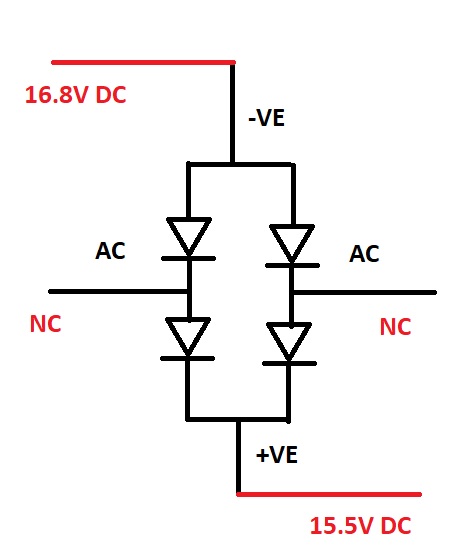

I would be cautious about running it over 16V.
Part of me says that no engineer would specify a max safe operating voltage as the maximum voltage rating of the parts inside.
Then again this is an amplifier designed for use in a car. Nominal 12V, on alternator around 14.5V max.
Now car electronics standards do specify parts that can survive reverse polarity connections, transients up to a couple of times the nominal operating voltage of the car and operation with the engine on and the battery disconnected.
It's basically a toss up. If the JBL engineers have done their jobs correctly it will survive, especially as the 18650s will sag under load.
I wouldn't expect higher output power from the higher running voltage though. I'm assuming an internal boost converter with a fixed output voltage for the power amplifiers. This should remain constant regardless of input voltage (within reason).

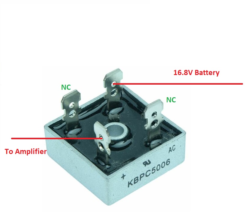

The simple answer is to use the diodes to lower the operating voltage.
JBL Stage Amplifier A9004 | Class D Car Audio Amplifier
However says that all stage amplifiers have overvoltage protection implying it will shut down if you give it too much juice. So who knows.

Do 18650's have that flat of a discharge curve to be worried (more than to add a single diode drop)? It would be the only battery chemistry I've heard of -- if it could maintain the 'fully charged' voltage more than the first few seconds, or 10's of seconds, of C/2 or 1C discharge.
