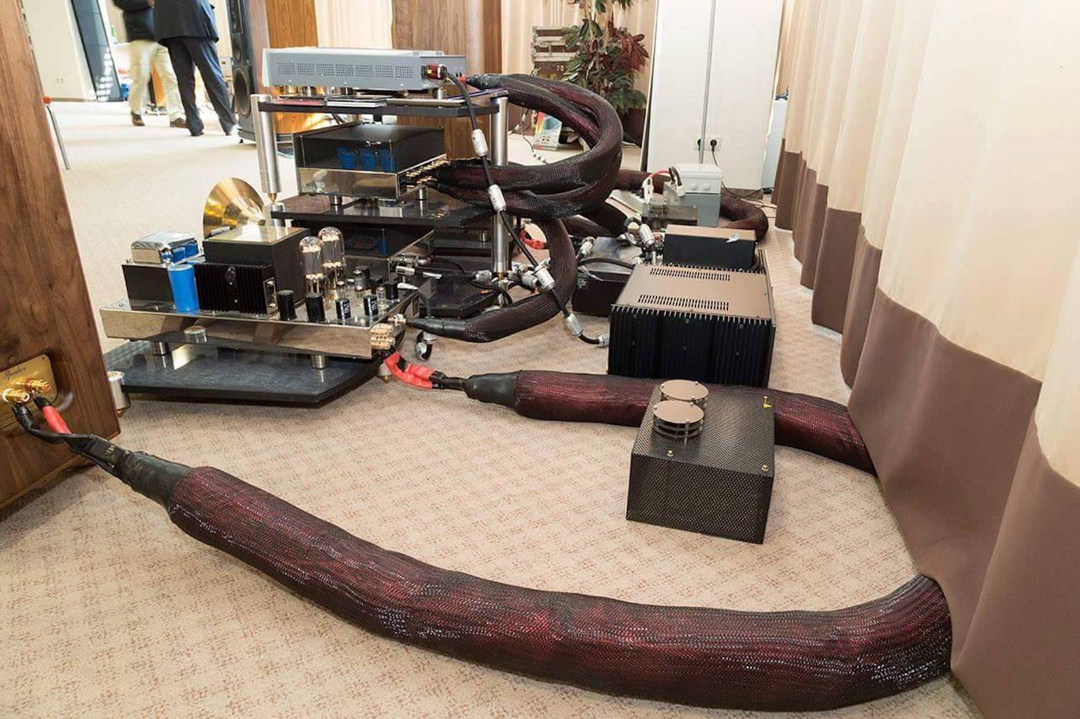

Here is a picture for your article. Enjoy it, and have a nice year!
Do I dare even ask about those anacondas in that picture?
Hehe, this is the stuff for the hype society😛
Looks like bologna skin stuffed with newspaper. For $10,000 cable, it should at least have a flashing LED string wrapped around it to show the sound going through it.
Thanks, that picture made me laugh out loud.
