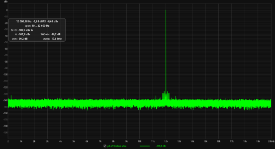

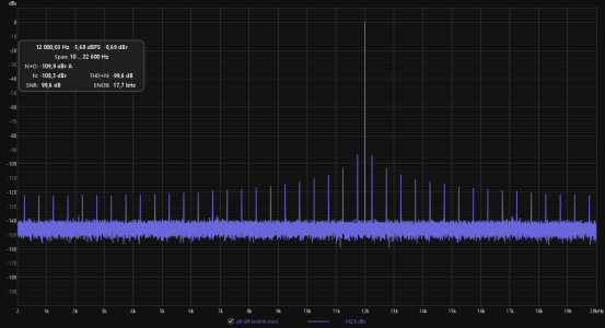

Now, there are difference in jitter performance between different WiiM streamers with 44.1 kHz .
WiiM mini toslink out :
WiiM Ultra , toslink out same signal
These measurements are done by onlyoneme using a dac where he could switch off the recklocking and dejittering function. So, above pictures are the raw jitter performance of the WiiM mini and WiiM ultra without any sort of dejittering at the external dac.
With the dejittering at ”on” with the Holo dac , the measurements went to be perfect from both units with 44.1 kHz material.

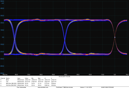

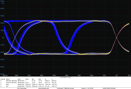

Eyepattern for WiiM ultra at 192 kHz spdif :
Eyepattern for WiiM pro/pro+ at 192 kHz , spdif :
As one can see - big differences at 192 kHz, the ultra is better, but those differences on the digital spdif out are almost gone at cd material, 44.1 kHz.

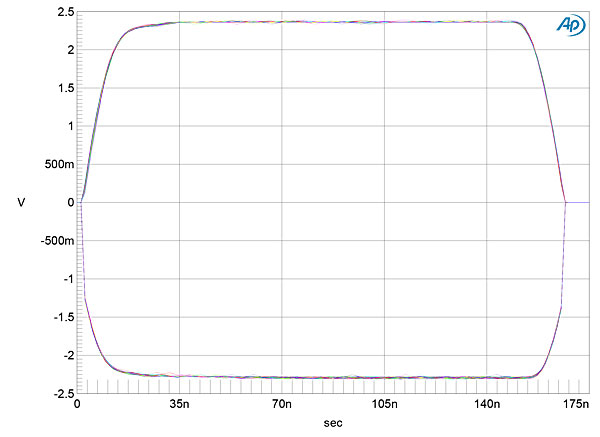

This time Stereophile, Eyepattern for WiiM mini, toslink out at 16 bit 44.1 kHz .
As one can see, almost perfect at 16 bit, 44.1 kHz material.
Many ”high end transports” are not better than the WiiM mini if one read the measurements done by stereophile.
Conclusion: the highend industry is for the most part, a hoax.

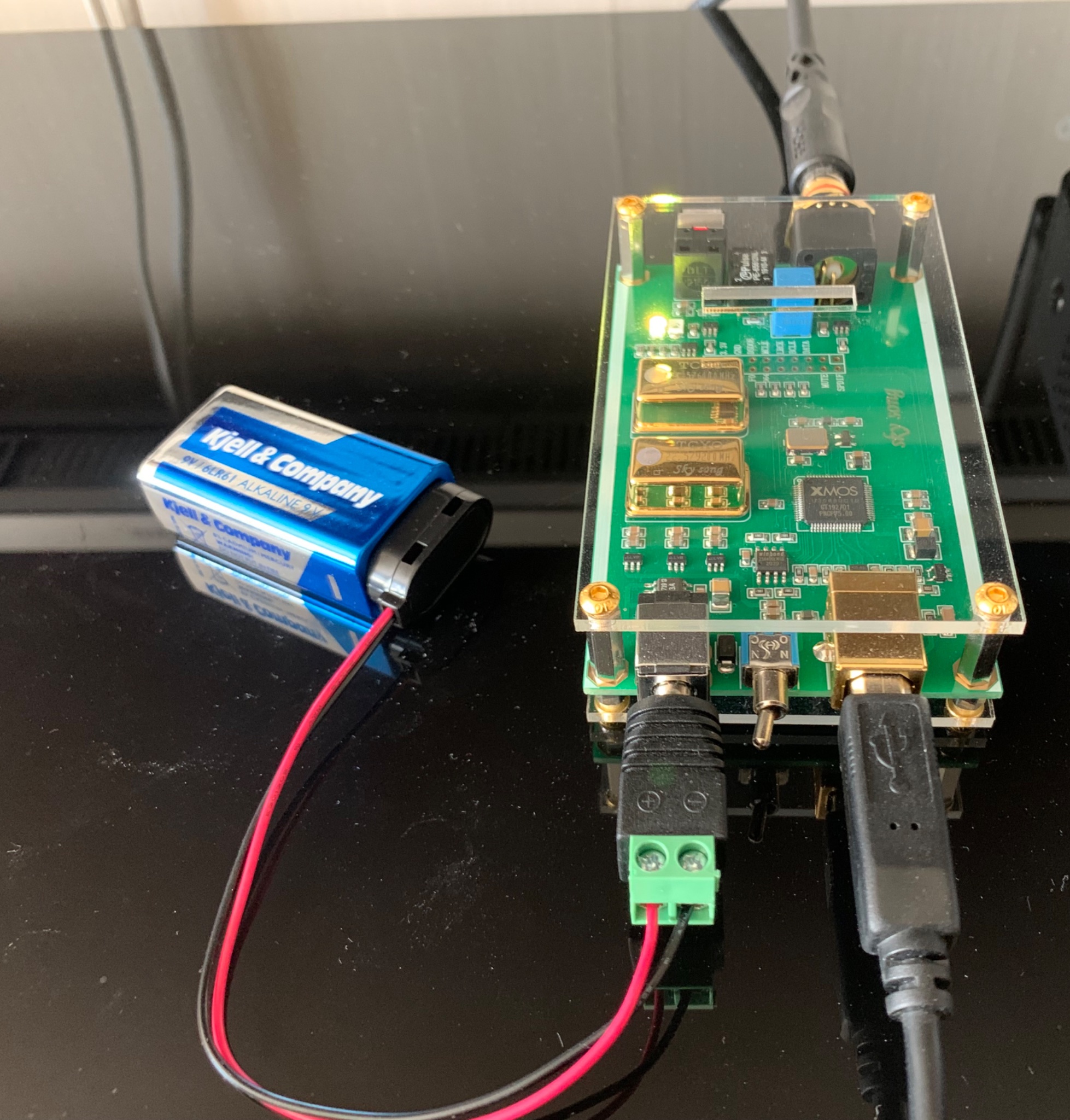

As it stands the separates, especially external DACs doing better than the built-in one. Looks like there are some updates to improve jitter performance of the internal DAC. Has anyone found these of substantial improvements to justify removing external devices?So the Ultra, a USB hub, a USB memory stick/disk and a USB reclocker to a USB DAC without cover because of discrete opamps. Efficient 🙂
The saber chip .....inside ......As it stands the separates, especially external DACs doing better than the built-in one. Looks like there are some updates to improve jitter performance of the internal DAC. Has anyone found these of substantial improvements to justify removing external devices?
