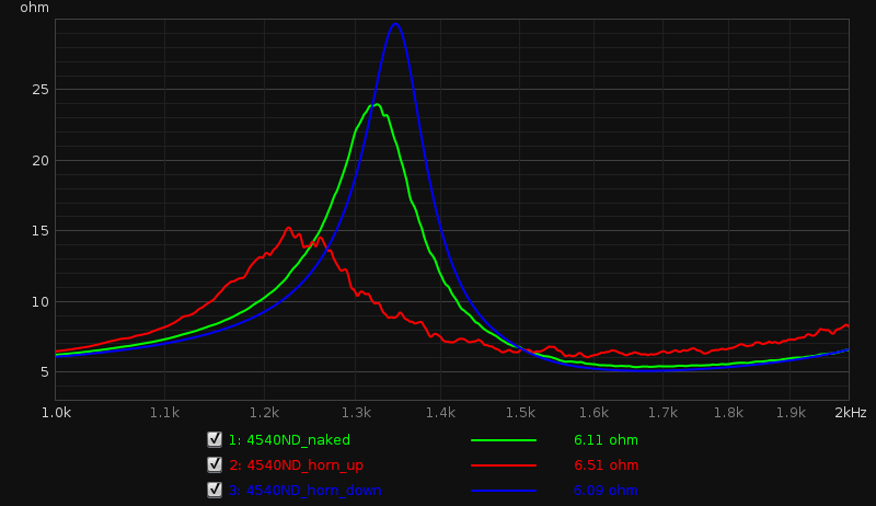

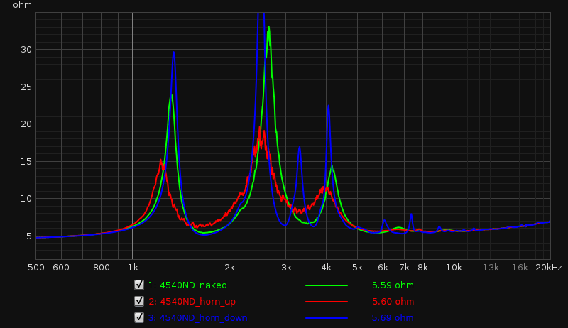

Ok, perhaps I have a bit of conclusion on the impedance wiggle issue. It looks like I severely under-estimated the compression driver and horn combo's ability to pick-up ambient noise. Of course it's then more obvious that putting it on a horn amplifies said noise to the driver's exit - actually entrance in this case - and placing it face-down on the table makes for a clean trace.
I was able to repeat my test on BMS 4540ND mounted on the JBL 6" PT waveguide in a hearing aid practitioner's soundproof booth, with all the same gear and settings and the trace comes out much cleaner.
The laptop and/or audio interface self-noise is there on the trace, mostly noticeable as a fuzz on lower measured impedance levels above 4kHz or so. The noise creates a peak-to-peak variation of ~0.04 ohm. Interesting thing I noticed with the help of the soundproof booth; when turning on the audio stream by opening REW's "'Measure" screen, I can actually hear the high-pitch jittery noise from the laptop hardware!

Here are the graphs.
Red - measurement at home
Green - measurement in soundproof booth
1kHz - 2kHz impedance:
5kHz - 20kHz zoom to show laptop/interface self-noise:
Reactions: 6thplanet
I had wrongfully dismissed that issue despite several factors pointing towards it, hindsight 20/20 and all... I almost decided not to try the soundproof booth thinking the USB interface noise dominated at that point.

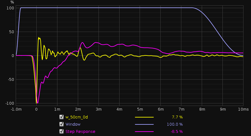

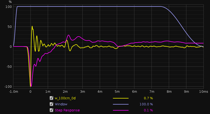

My concern was initially with similar ripple on the IR of the tweeter, but I can't do anything louder than impedance measurements at this time in the evening, so hence the impedance comparison above. Here are the IR traces still, tweeter's to begin.
The woofer's IR does not have these OTOH.

I was first scratching my head with the 2ms blip, but I guess It's a driver thing? It is unchanged with measuring distance afterall. I seem to remember another TD15M user chasing a similar issue, I'd have to search.
This impulse issue is shown in every measurement of Acoustic elegance 10/12/15 i ever saw.
