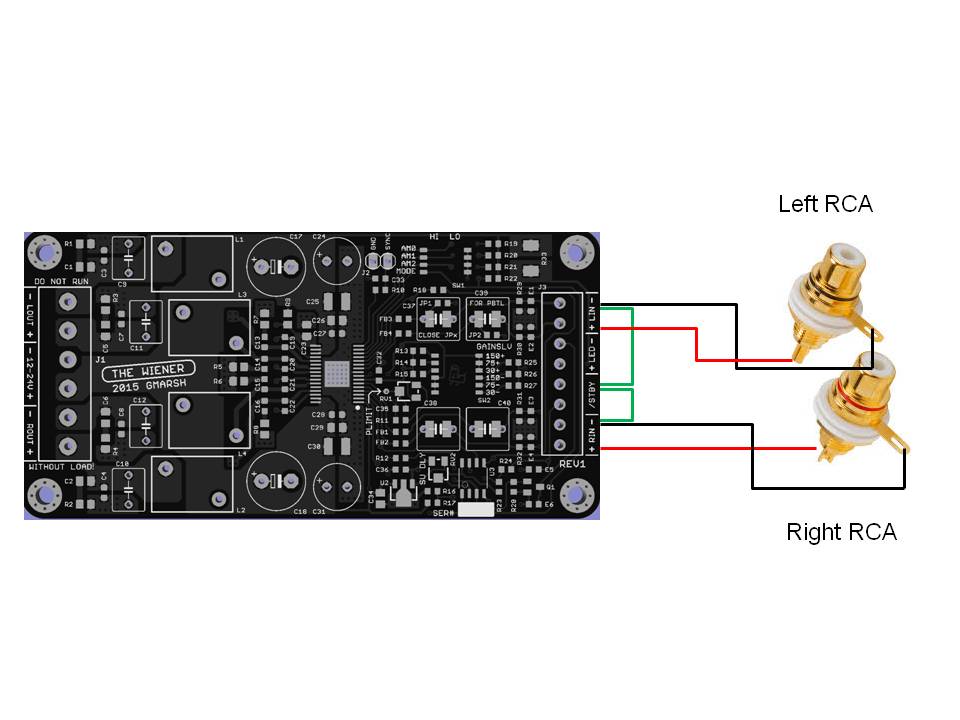

Connecting your standard RCA input jacks to The Wiener stereo amp is just as easy as connecting to the YJ TPA3116 amp. If The Wiener stereo amp is identical to the first iteration, which I have, you do the following:
- Connect the center pins of the RCA connectors to the "+" inputs for each channel
- Connect the ground lugs of the RCA connectors to the "-" inputs.
- Additionally, you should put short jumpers from each channel's "-" input to the right-side Stand By connection, which happens to be Ground.
The microprocessor controls when the mute is active or not active to prevent power-on and power-off thumps/pops from going through your speakers.

OK, I think I'm grasping this. I normally think of the negative terminals of the RCA inputs of going to a common ground, where do the negative terminals of the Weiner board go to?

On most of the chinese amp boards, the negative audio input on the TPA3116 chip itself is connected to the board/power ground through a capacitor.OK, I think I'm grasping this. I normally think of the negative terminals of the RCA inputs of going to a common ground, where do the negative terminals of the Weiner board go to?
On the Wiener card, the negative audio inputs are set up electrically just like the positive inputs, providing a differential input.
You can technically hook up an unbalanced source just by hooking RCA shield to negative input, RCA pin to positive input. However there's a small snag, you want the power ground of the audio source and the power ground of the Wiener to be connected together, and it's hard to guarantee that unless you're really sure what you're doing.
In this case, connecting the RCA shields to the board ground of the wiener is highly recommended. Wiring the amplifier like rhing described above accomplishes this.
