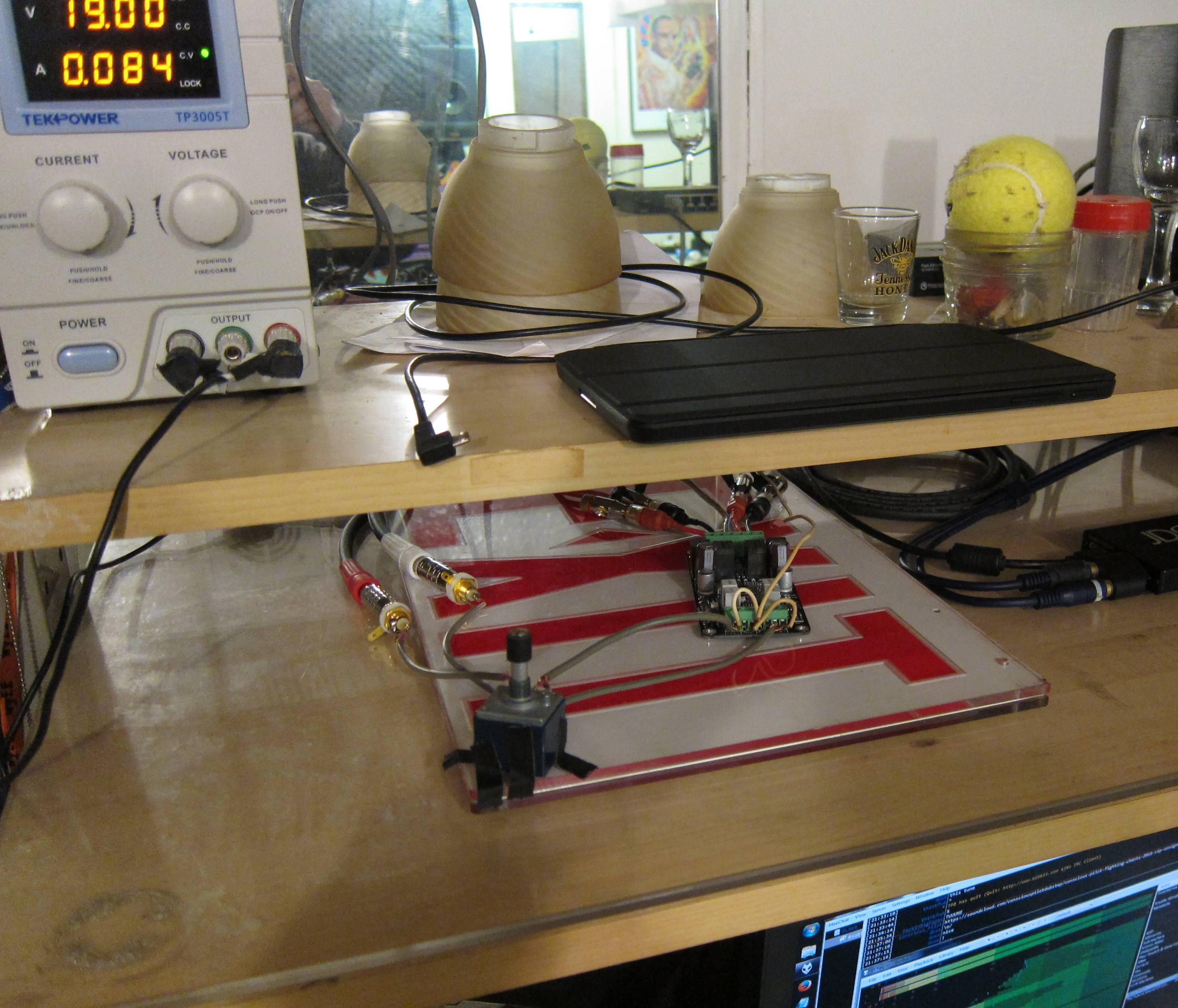

Still have to rewire the pot to make a change, but this is it. Sounds incredible completely blows away the other (supposedly premium, but china) TPA3116 i have .
The card is 6ohm model, set to 1200khz pwm frequency, 1SPY mode, 20db gain. The pot is a 10kOhm ALPS which seems about right. Powered by Linear PS@ 19V, JDSLabs ODAC revA, feeding ascend cbm170se and a dayton 12" split off the odac.
