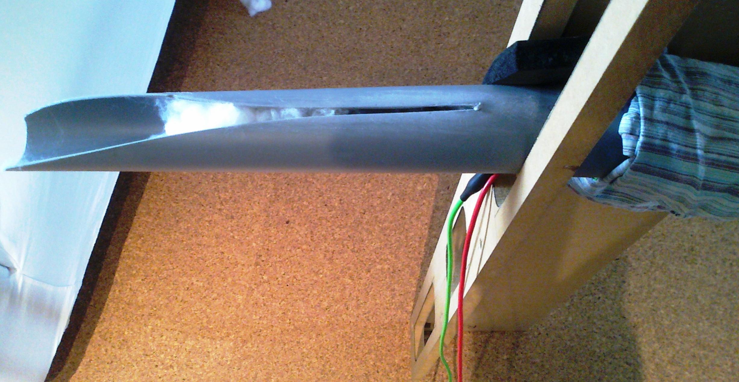

Some investigations concerning selective stuffing/damping ...
Curves taken at
- about 1m distance
- about 30 degrees above the tube's axis (at the slot side).
(that means falling slope even in "unstuffed" setting)
"Stuffed throat" means about 10cm in length of the tube from
driver to beginning of the slot, not "pressed hard" but not
"loose" either.
In my view, stuffing such a device is essential to get balanced
output, like in any quarterwave design.
Of course highs are muffled by doing so, maybe the
"covered slot" setting can be refined if highs are essential.
Here the "stuffed throat" condition is the only one giving
a quite acceptable midrange from say 300Hz to 3Khz.
A lining of the tube has not been tested yet.

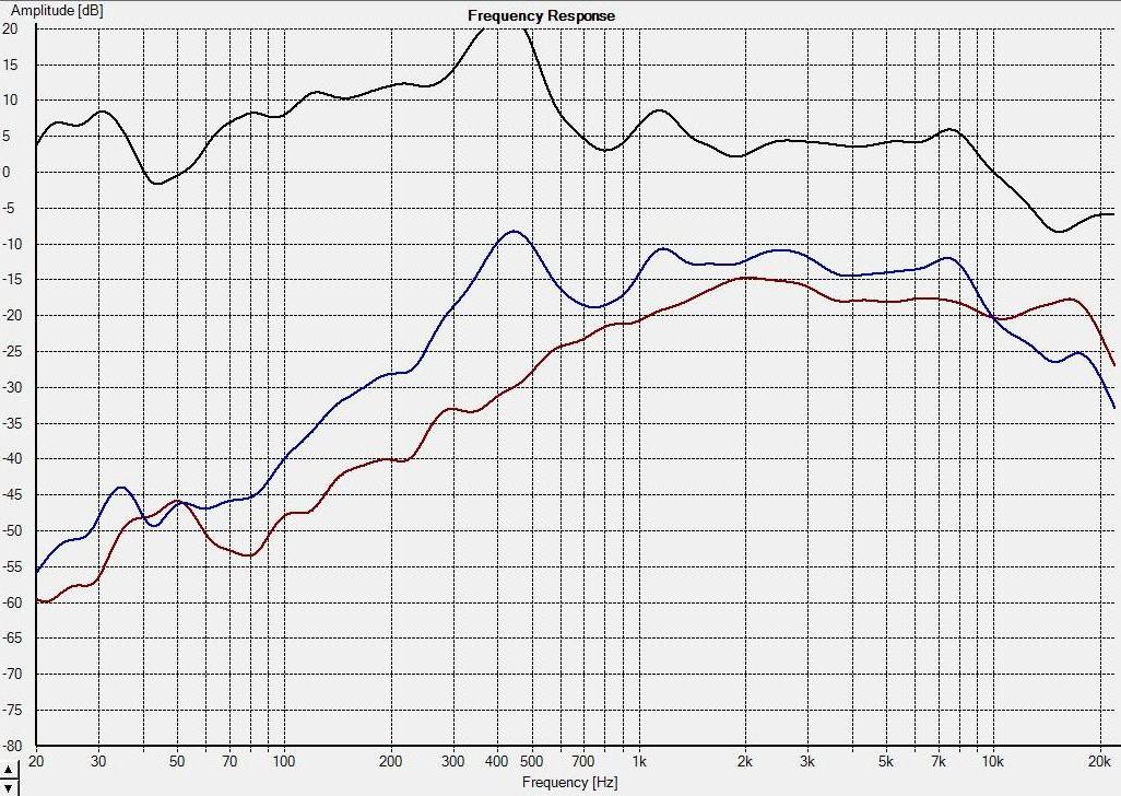

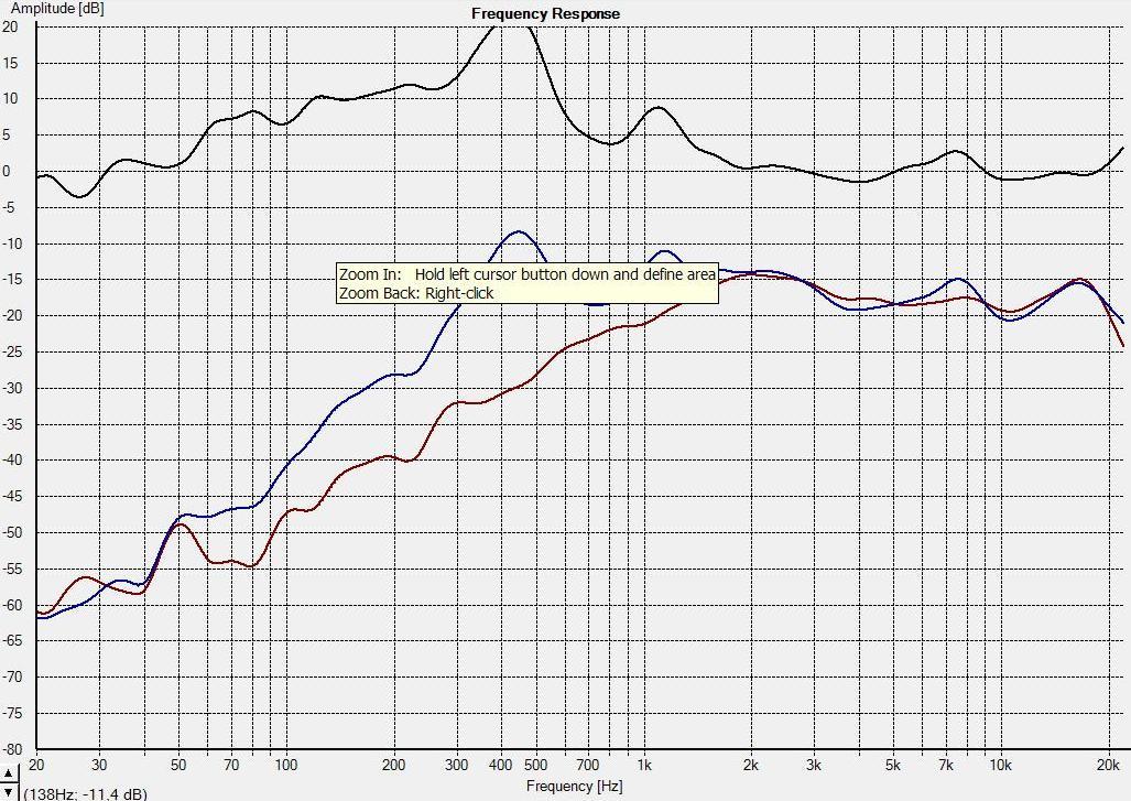

Now a 30cm long straight cut tube ...
A) Stuffed throat (approx 10cm) vs. unstuffed, on axis
B) Stuffed throat (approx 10cm) vs. unstuffed, approx. 20deg off axis
C) 30cm straight vs 38cm K-Slot both unstuffed, Caution: Conditions and
levels not identical, just for qualitative comparison
__________________________
What are the effects of the K-Slot compared to straight cut ?
- effective acoustical length shrinks > lowest quartewave resonance rises in frequency
- higher order resonances have lower Q, dampening effect similar to stuffing
- little/no effect on overall efficiency
- little/no effect on radiation/dispersion of high frequencies with wavelengths
comparable to diameter of tube
Some personal conclusions:
1) K-slotting may be used to complement damping by porous materials due to resonances of low
to mid order numbers.
2) It is questionable, whether noteably shrinking the effective acoustical length of the tube
by "K-slotting" is worth that potential benefit, since an effectively shorter tube tends to have
worse modal overlap.

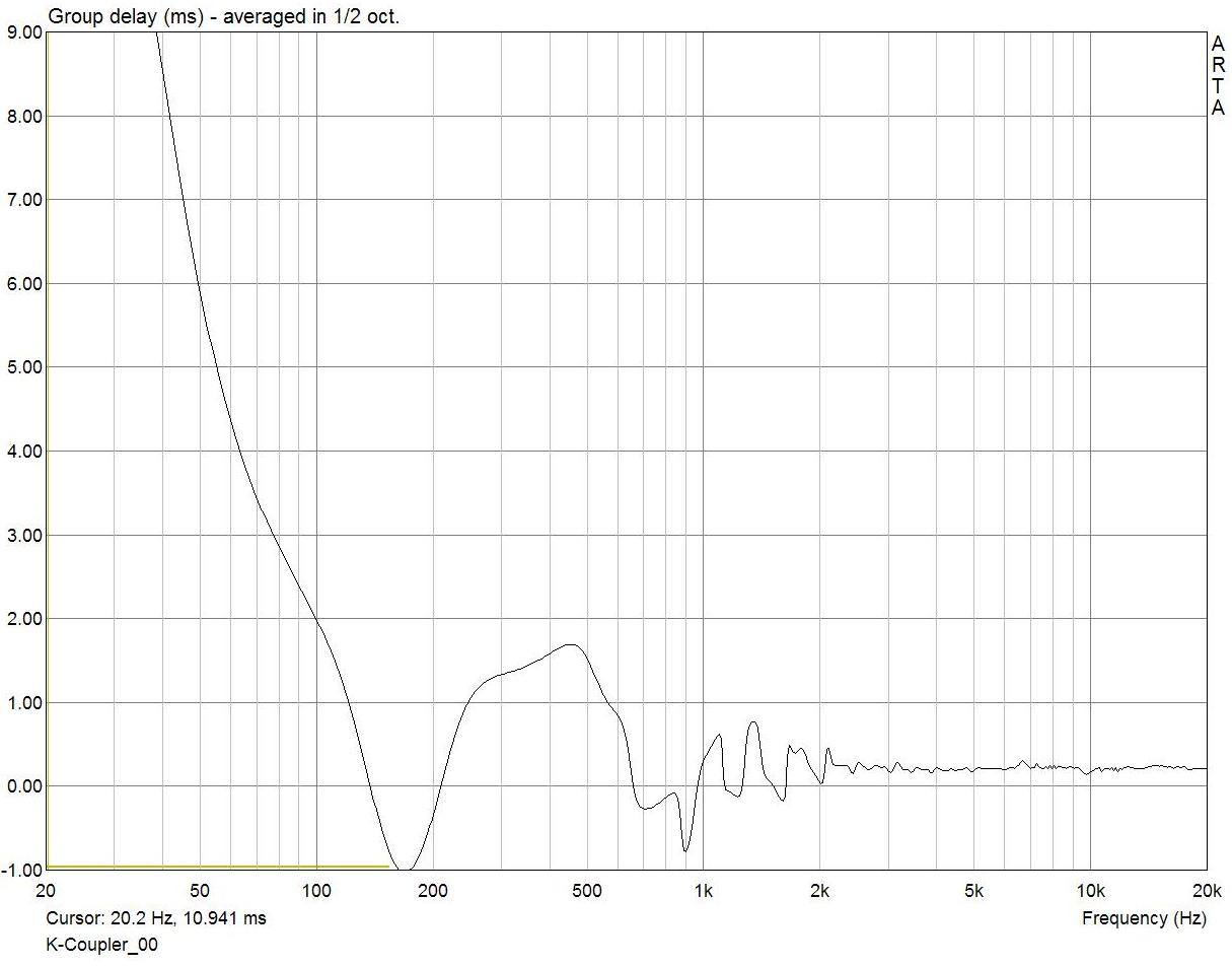

Thanks IG,
now for some "alternative" design for comparison ...
From left to right
A) B) C) "Making Of" a 35cm in length quarterwave tube with "resistive bypasses",
............only estimatedly positioned at potential area of max. pressure
............for the lowest resonance and the "near mouth pressure maxima" for
............the higher order modes.
............(Bypasses at throat and in the last third near the mouth)
D) K-Coupler style 37cm in length
E) Measurements of "bypassed tube" without stuffing
D) some measurements including stuffing (approx. 8cm in length between the bypass areas)
F) K-Coupler measurement from a setting before, not directly comparable due to signal level and
positioning, but same smoothing (1/6 octave) like E) and D)
All measurements "on axis approx. in line with the tube / K-coupler respectively
Of course the bypasses could be optimized in position and also a "mouth slot" in line
with the tube would be possible - but this kind of PP tube better keeps circular cross
section if slotted this way ...
Even the "resistive bypass slots" cause effective acoustical shrinking of the tube
(lowest resonance rises in frequency) as a (in my case unwanted) side effect, but
that is no surprise.
The last measurement did not hit the "most beautiful radiation angle" of the K-Coupler
style tube ... nevertheless the "bypassed" counterparts are able to keep up in terms
of bandwidth and ripple/smoothness.
In fact from these measurements the K-slot type does not look very well.
More precise comparison and optimizations would have to be done, but at this point
damping and "resistive slotting" seem more attractive to me to get a usable midrange.

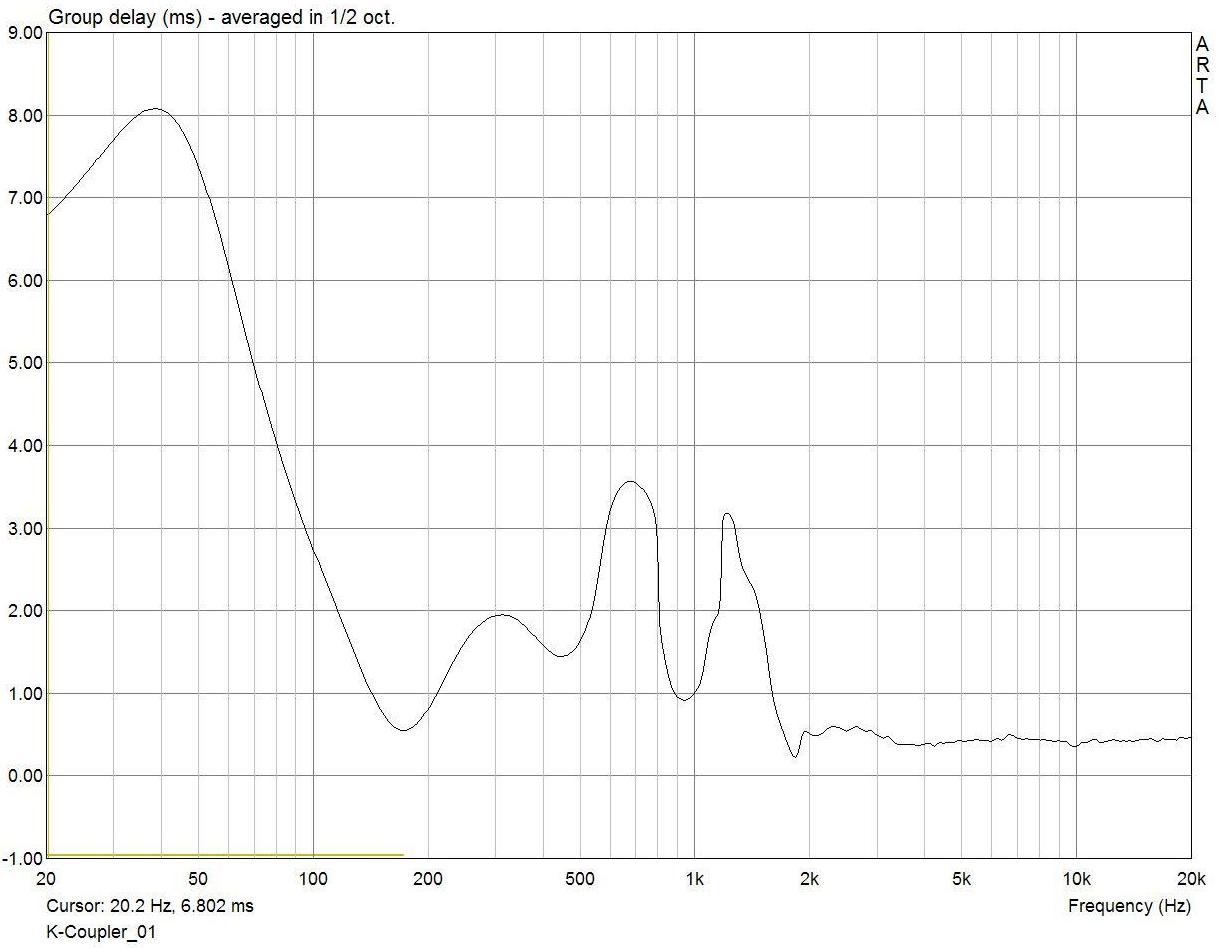

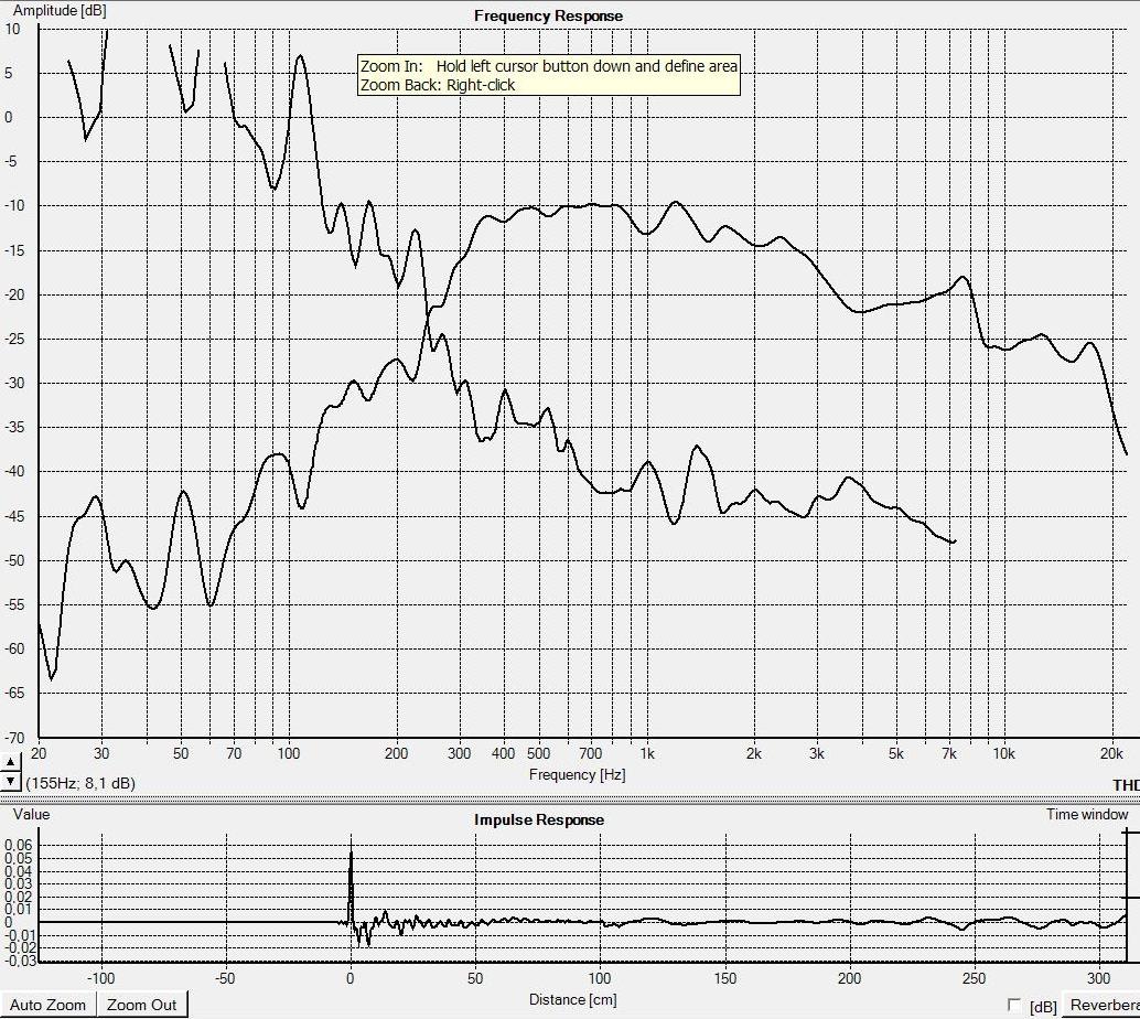

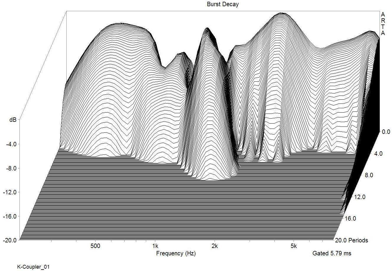

Yes, i thought about doing so. Resonances should not be any different,
than using half of the tube (single side open) and only one driver.
Anyhow, i used the
- 35cm slotted one from above,
- single (rear) side open,
- completely stuffed (from driver to open rear end)
to mount the driver in conventional arrangement.
So some "tube modding" was used to make a usual quarter
wave tube virtually free from resonant conditions in midrange
and mount a driver to radiate conventionally ...
I guess all who followed this comic strip might agree,
that smoothness in midrange is not approached by any of
the "tube radiators" tested before.
Even in this state, the lower rolloff is quite acceptable and
should integrate well using a simple filter slope.
Geometrical length including the tin adaptor is about 40cm.
With that rather tight stuffing used the tube seems to be
effective down to about 250Hz, which would propose an
effective length of 0.3m assuming c=300m/s
(which might be approximatly right inside the stuffed tube)
or
0.34m if using c=340m/s (when using sound in air for
estimation of effective length)
To have the tube effective down to Fs of the driver the
tube could even be extended to 0.53m effective length,
about 0.34 x 1.6.
But depending on how to use it, that length may be somewhat
impractical, because the new tube would have to be about
0.64m long geometrical, protruding most woofer cabinets in depth,
when keeping it straight.
