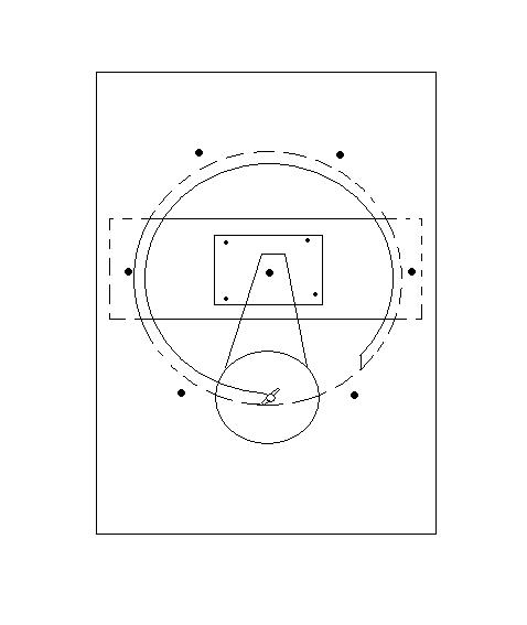

Sorry Im late to the game but an easy and accurate way is by using a router. Attach a scrap piece of plywood to the inside of the speaker baffle using the existing mounting holes. It needs to span the hole and be centered in it. Then you add a shim in the center of the ply that is flush with the front baffle. Then just use this as a center pivot point for your router/circle jig. The toughest part of the procedure is finding the exact center of the hole.

Not hard if you draw lines between the speaker mounting holes. Can't miss.
My question is: it sounds like he has rebated holes and you have him fastening the board through holes that need to be cut (inner hole and rebate hole). I would suggest drawing lines (using the speaker mounting holes) further out and mounting and mounting the board there. Can you remove the baffle so you can get at thee back to mount the board?
You might also want to shim the board to keep it away from the back of the baffle for better clearance?
Good, never thought of that - some trades use hot glue for temporary jobs like this.

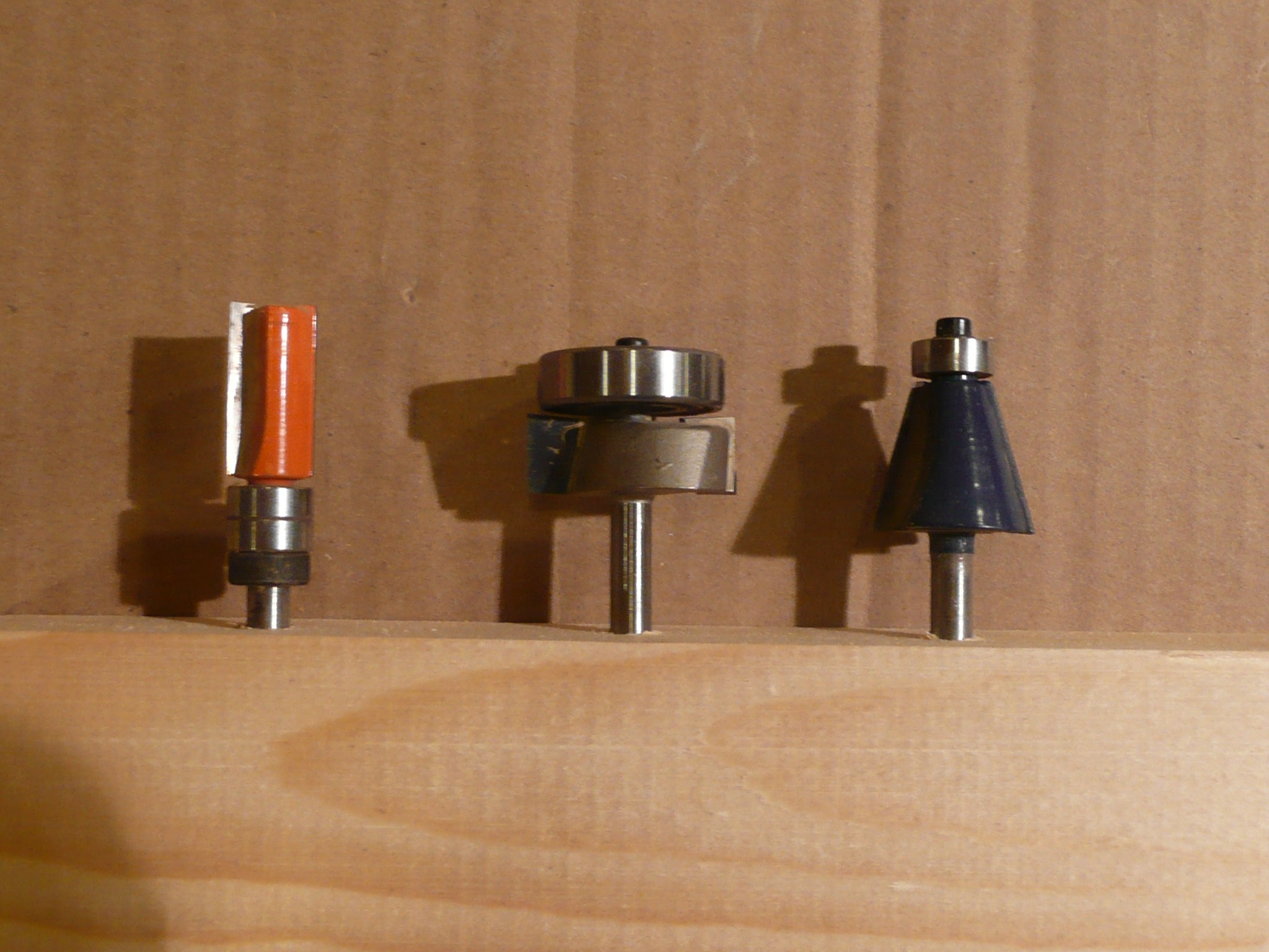

Here's a few couple of bits that I use (all very, very cheap). I swapped the bearing out on the middle one, the idea is that you make a
shallow pass and then come back with the flush bit (on left).
The taper bit works really nice, I bought that and didn't know what to do with it. Same idea, make a very shallow pass and then come back and clean it up.
Sometimes you can make a large hole in scrap wood - and then come back and use-the-outside-edge of the router. This is the slowest way, but works nice.
btw....this is the bit that any speaker builder will enjoy, about $40 but cuts wisper clean and has a bearing top and bottom.
Down Shear Trim Router Bits with Upper Ball Bearing by Amana Tool
