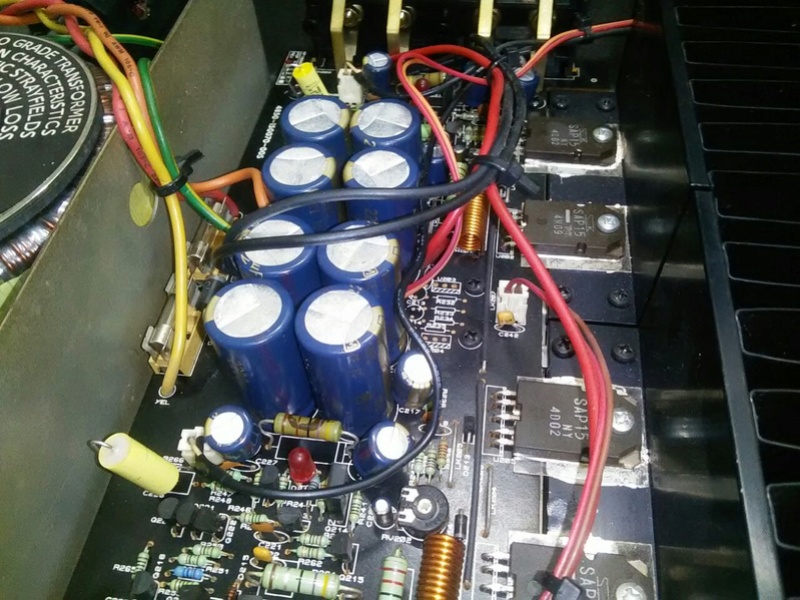

The failure point in the SAPs was the on-die resistor.. it would fail long before the transistor itself. The STD is simply the same transistor, but with the resistor left unused.
In the Cambridge Amps, the usual mode of failure is overheating due to a cheap folded sheet metal heatsink.

Thank you, that makes sense. An outdoor resistor has mostly a load capacity of at least 5W - much more than the internal resistor - so I think.The failure point in the SAPs was the on-die resistor.
It would fail long before the transistor itself. The STD is simply the same transistor, but with the resistor left unused.

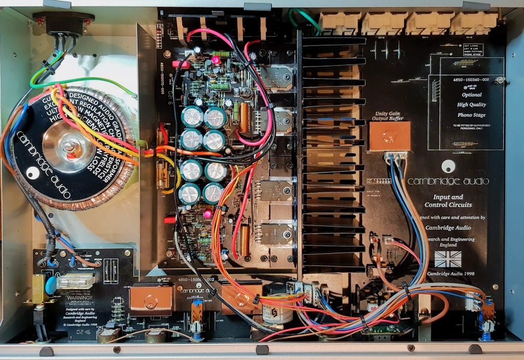

If I got faulty Cambridge Audio A300 with fault description "one channel plays quietly" which is way better that "fuses blowing all the time" so after initial investigation SAPs are all fine, but there is another common CA A300/A500/P500 fault: leaked, bloat or just dead almost all blue RM el.capacitors.
Therefore question: does those SAPs sound well to be worth fixing / restoring amplifier which still got working SAPs? In my case there is a lot of damaged parts around due to leaked electrolyte, so cleaning, parts replacement would take time and costs, not sure if the worth or not if to think to keep it for sound...

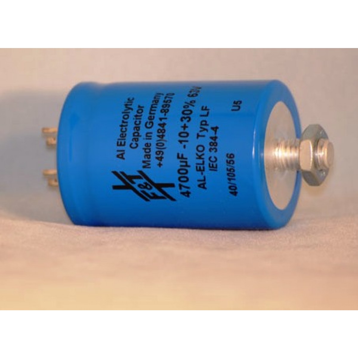

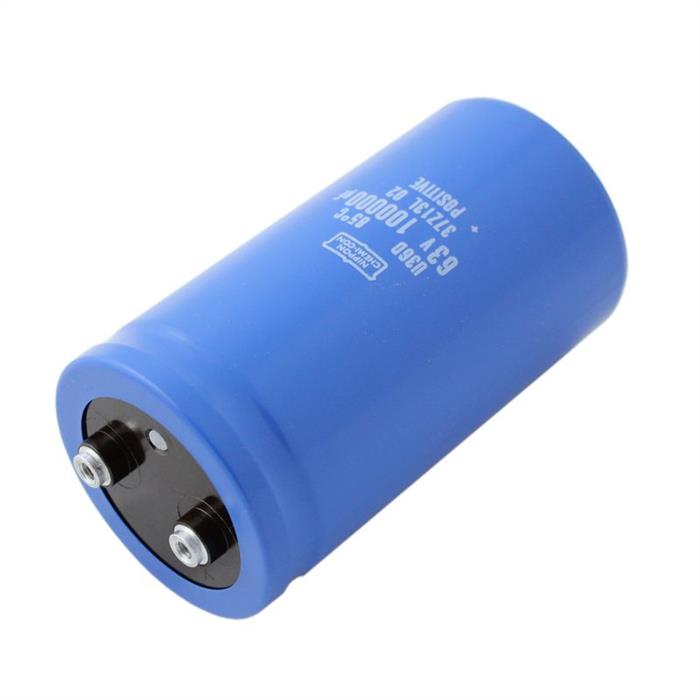

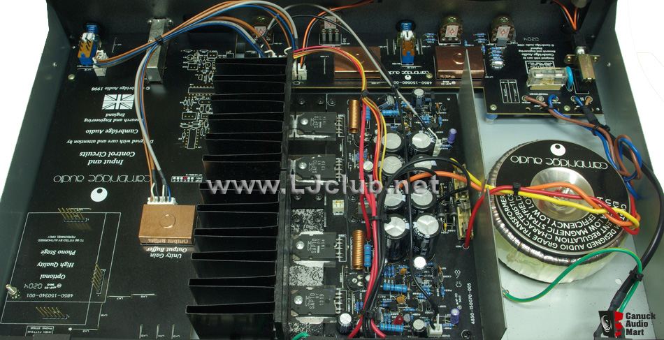

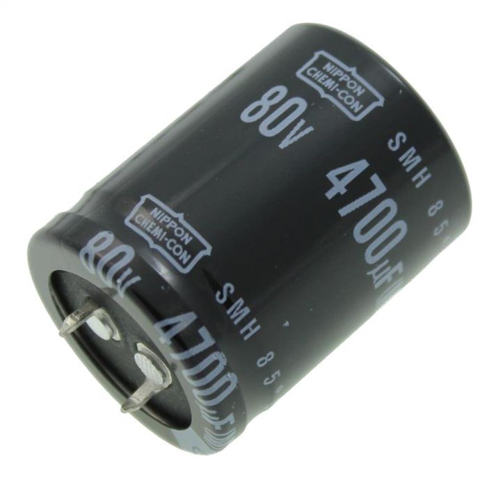

Hard to say. This series from Cambridge Audio has many more deficiencies in terms of workmanship and also in terms of capacitor choice than the A3i.
When I look to the electrolytic capacitors behind the rectifier, I get big stomach aches and headaches.
I doubt whether replacing it with a Panasonic FC series will help.
Images 1-4 show the downgrade from 40 years ago until today regarding the the electrolytic capacitor versions for amp's power supply units.
First image was the ideal choice, but too expensive for CA. Even for the version from second image there is not enough space.
I have repaired a lot of amplifiers where many repair shops have said it was just crap. With this series even I say that myself.
If I had 20 devices of one of these models, I would work out the necessary steps for everything to be done for a permanently reliable operation. But not for a single device.
Check out the attachment and some links for additional images
